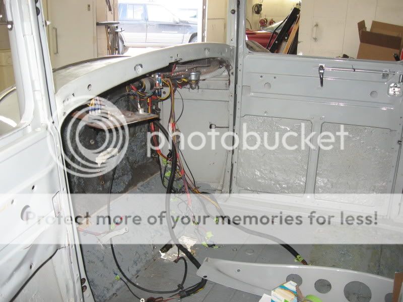

    To clear some things up:
    The frame is boxed front to back.
    The stock subrails are still intact.
    The seat frame is bolted through the floor and into the frame rails.
    The seatbelts are bolted to the seat frame.
    I'm fairly convinced to just leave the wood floor in the car, but what about adding a rollbar?
    Here's some pics of the floor for reference (not the greatest pics, but you get the idea):
