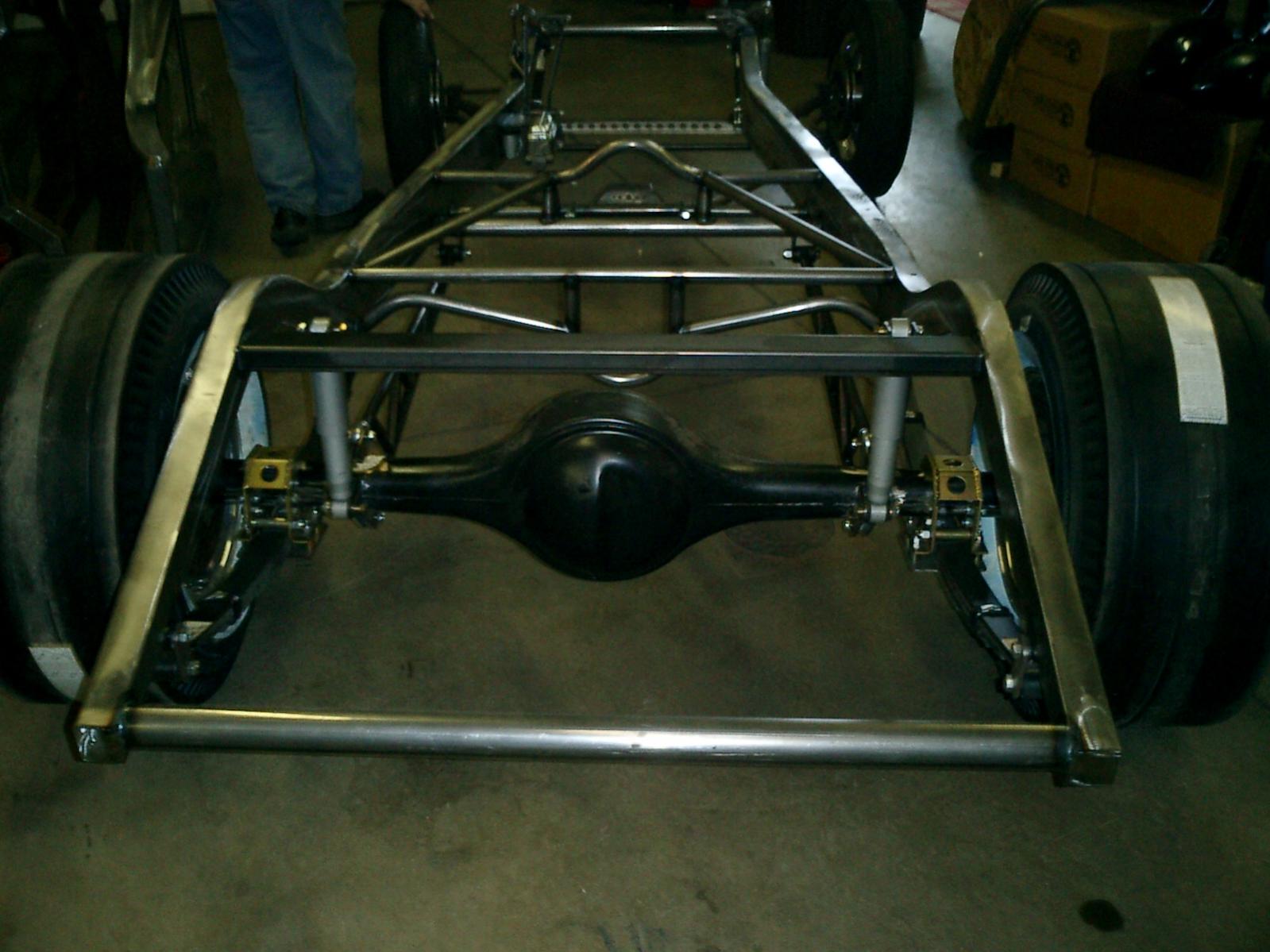

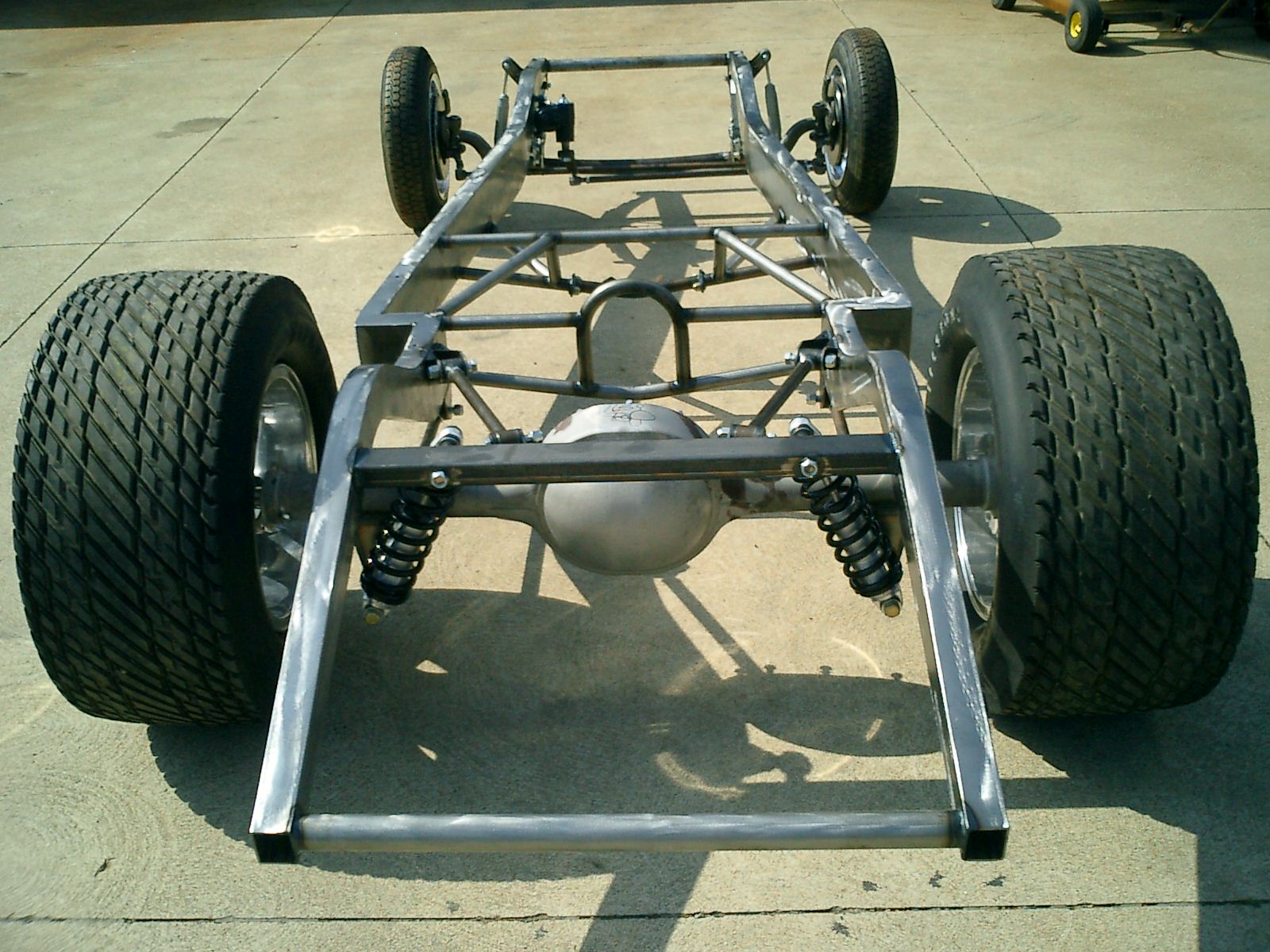

    Our shop does repop Willys chassis. We make our rails taller to get more room for the crossmembers. They are lazer cut from 10GA P&O steel. You can order them Pro Street for any width tire or you can have them stock width. The pictures are one we did for a customer that had a steel body and wanted a 60's look. He did not want it real nose high so it has a 2" drop axle. We can do any suspension/engine combo you would like. All welding is tig, and crossmembers are 1 1/4" .120 wall tube. Give us a call and we will be more that happy to discuss your project.

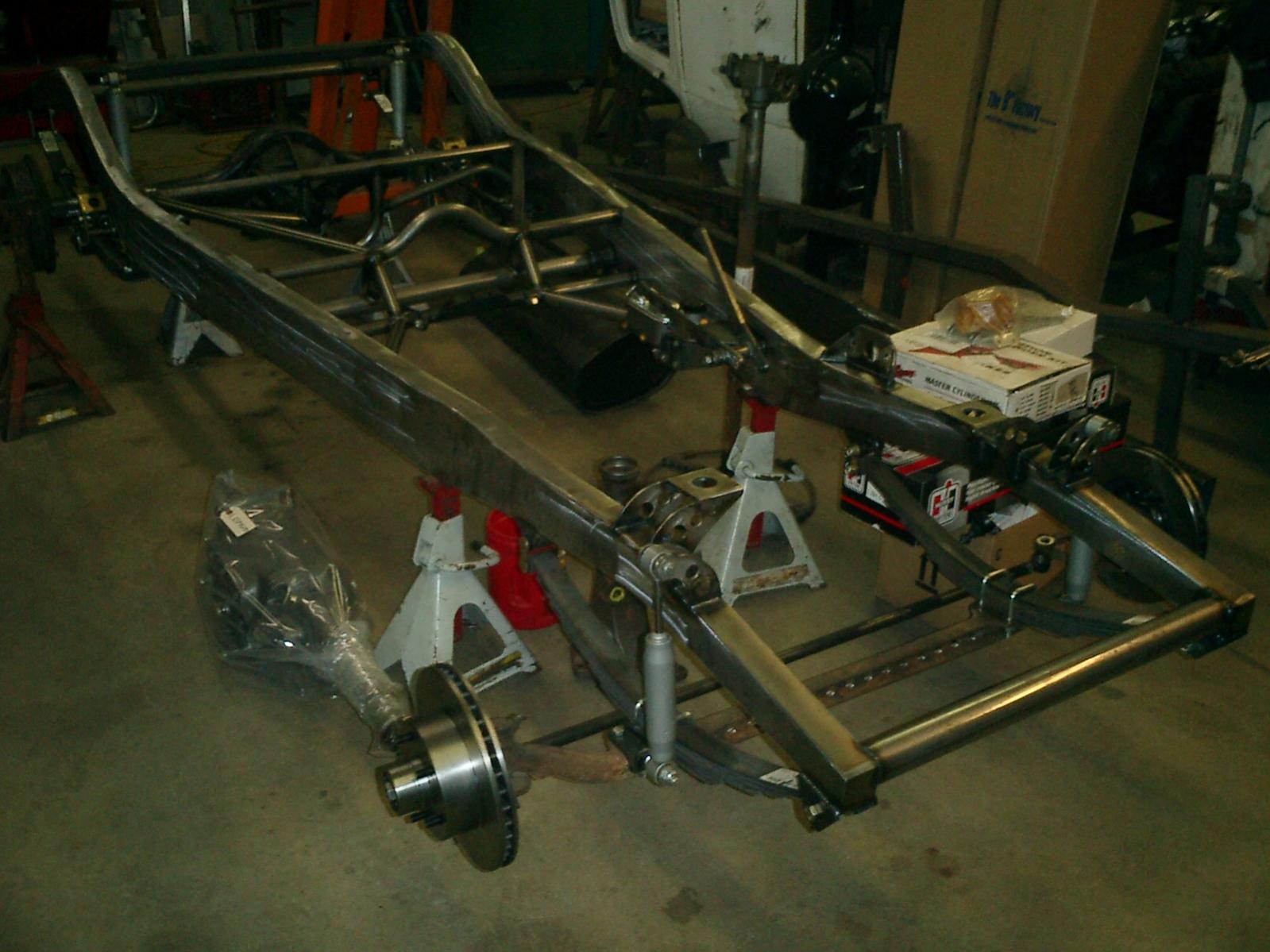

    Found some pics of a straight rail one (no tubs) with Olds rear on leafs w/ladder bars that we fabed. Stock Willys front axle set up for a blown Hemi.
