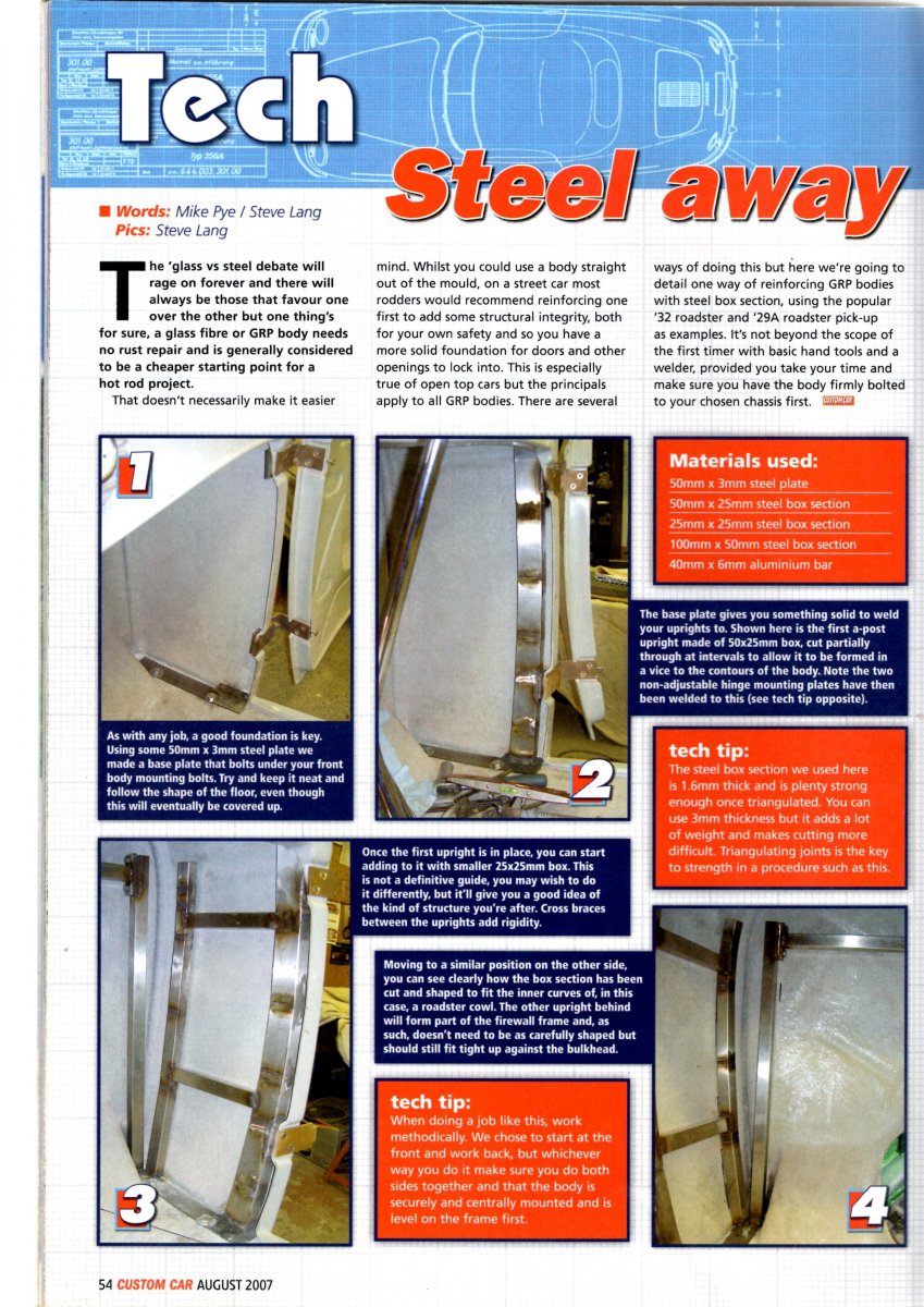

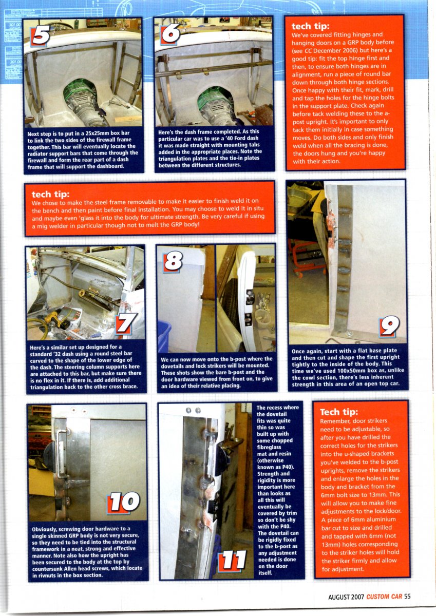

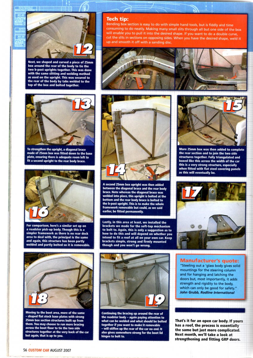

    Here's a 32 3W steel out without the body, if you've access to a Hossfeld bender, all those radius bends are a breeze.
    Make sure you plan ahead and think about subframe crush tubes, door and trunk hinges as well as locks, dash reinforcement for upper column mount, seat mounting as well as upper and lower seat belt mountings. Cross bracing (Triangulation) will keep the body from flexing and shudder, plus it'll be structurally sound and safer than timber.
    Here's how Wescott do their 3W body, added intrusion bar in door and 'A' pillar
