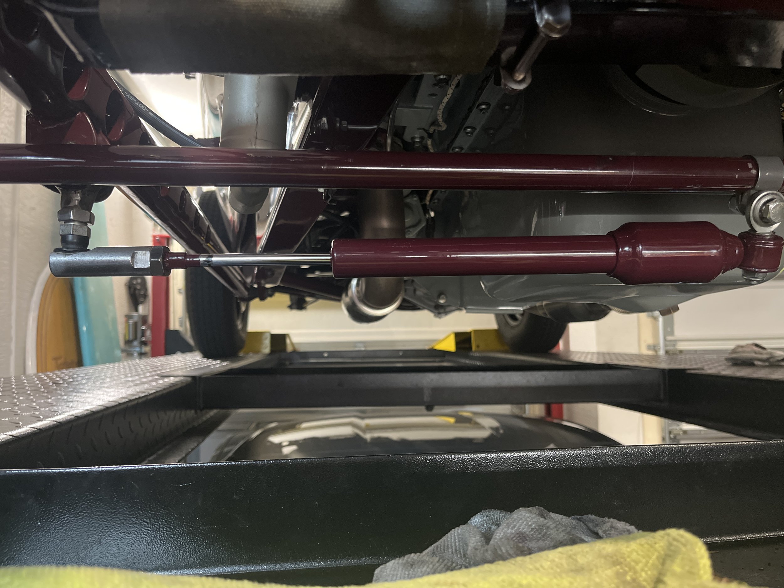

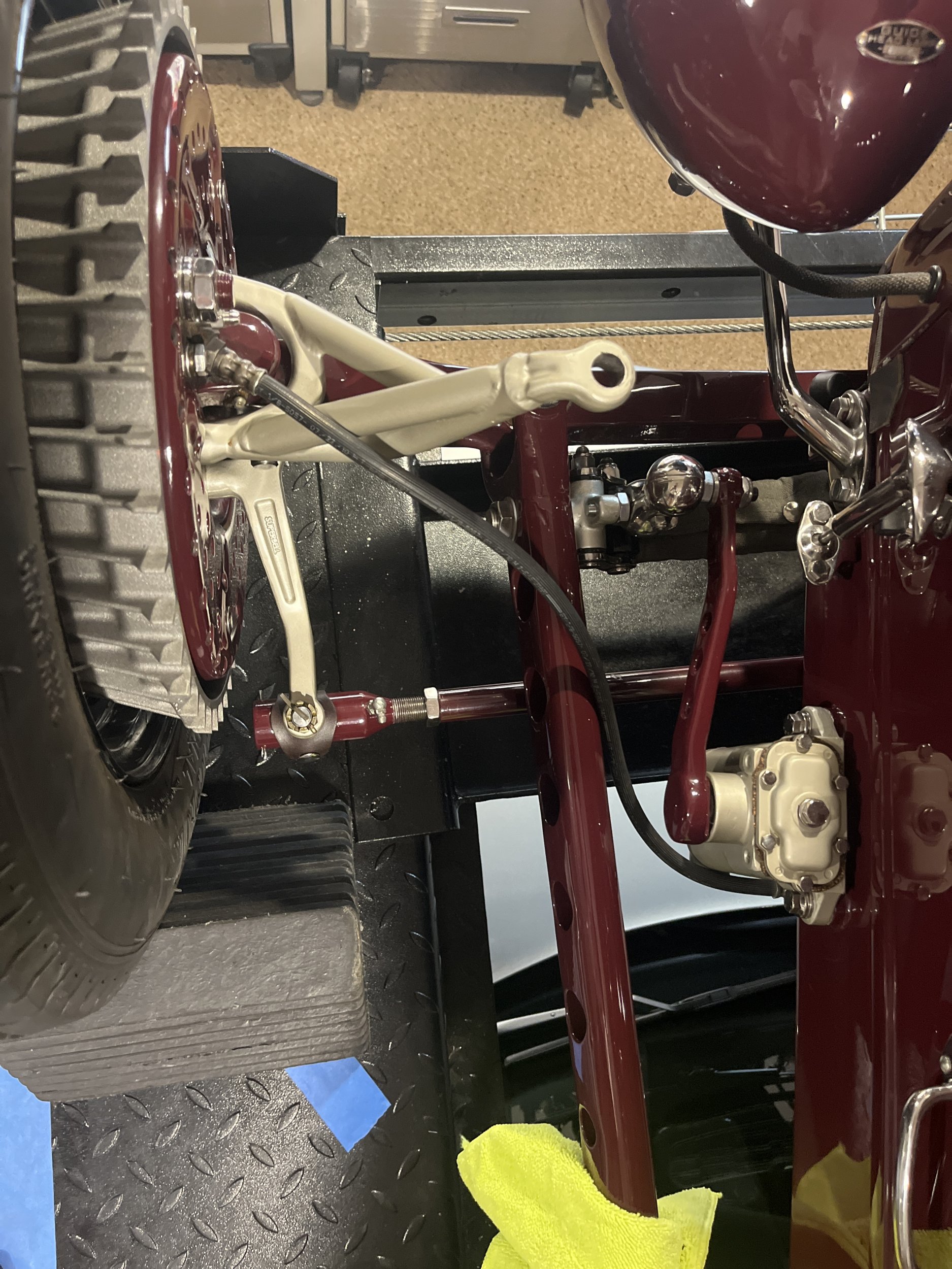

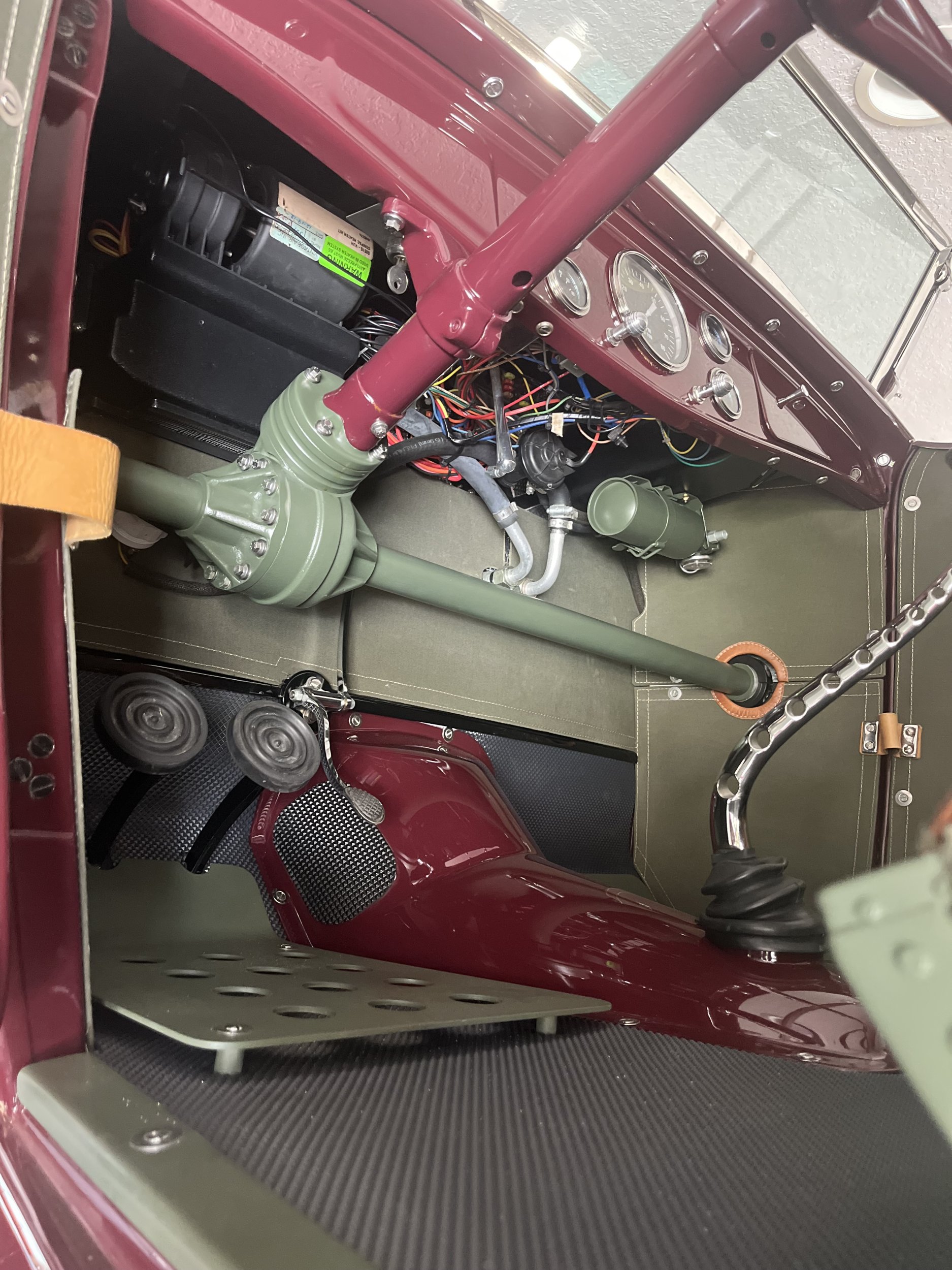

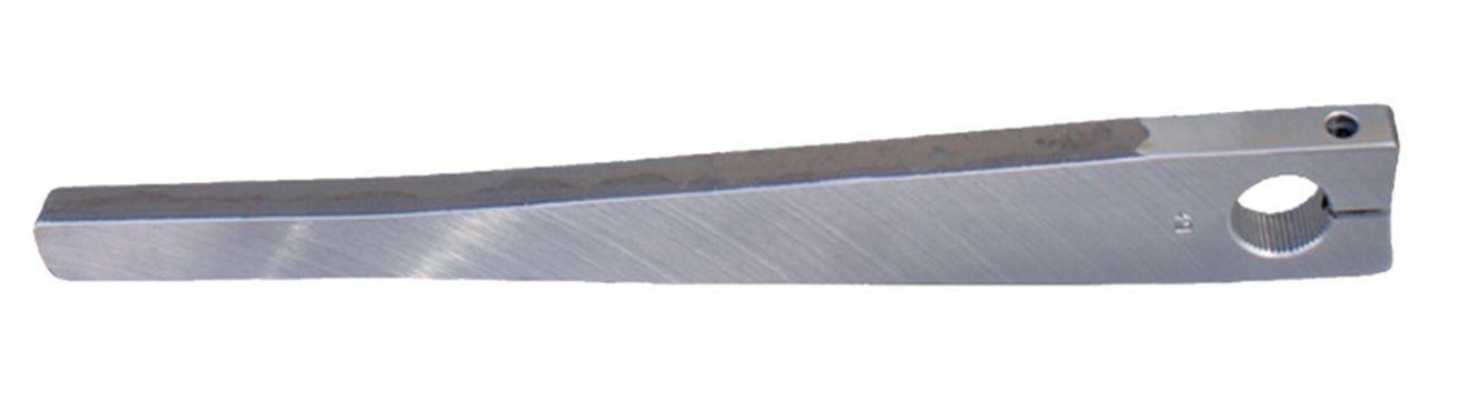

    Looking to fab or buy a steering arm for my Schroeder steering box. Can't find any From Schroeder, I guess Ididit bought em and don't carry em anymore. I have a torsion bar with the 1 inch 48 spline but was hoping to find an Existing Pitman arm that that would fit on the spine. Anyone what spline has a 1 inch 48 spline around 6.5 to 7 inches? The pic is what iam looking for. Thx

    When I did my 32 roadster with Schroeder steering almost 20 years ago Schroeder didn't make anything I liked so I bought an aluminum torsion bar arm that fit the splines and had my local shop machine it to my specs. Looked and worked good. Car was cool and drove alright but I will never do another with Schroeder side steer.

    Google: sprint car pitman arm
    There are tons.

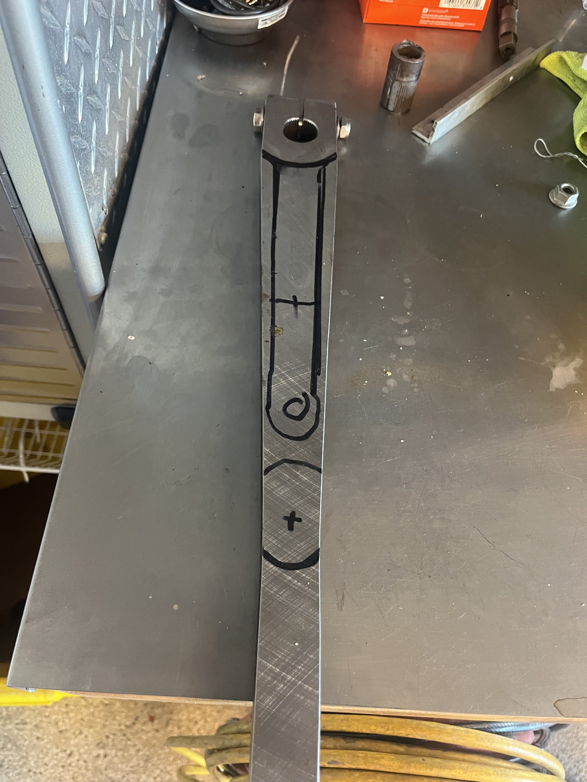

    Thx guys, seen the aluminum ones, like to stick to forged. Going to probably use the steel torsion bar have it machined and do little Twisting on it. Yes, cowl steer is cool especially at local shows, but cross steer next build. Actually decreased the length by an inch giving me a true 16:1 and thought the increased angle Oh would cause "bump steer", but didn't. Drove over all kinds of potholes and couldn't get it to.

    If you prefer steel, get a steel torsion bar arm and modify to suit. Come in straight and offset.

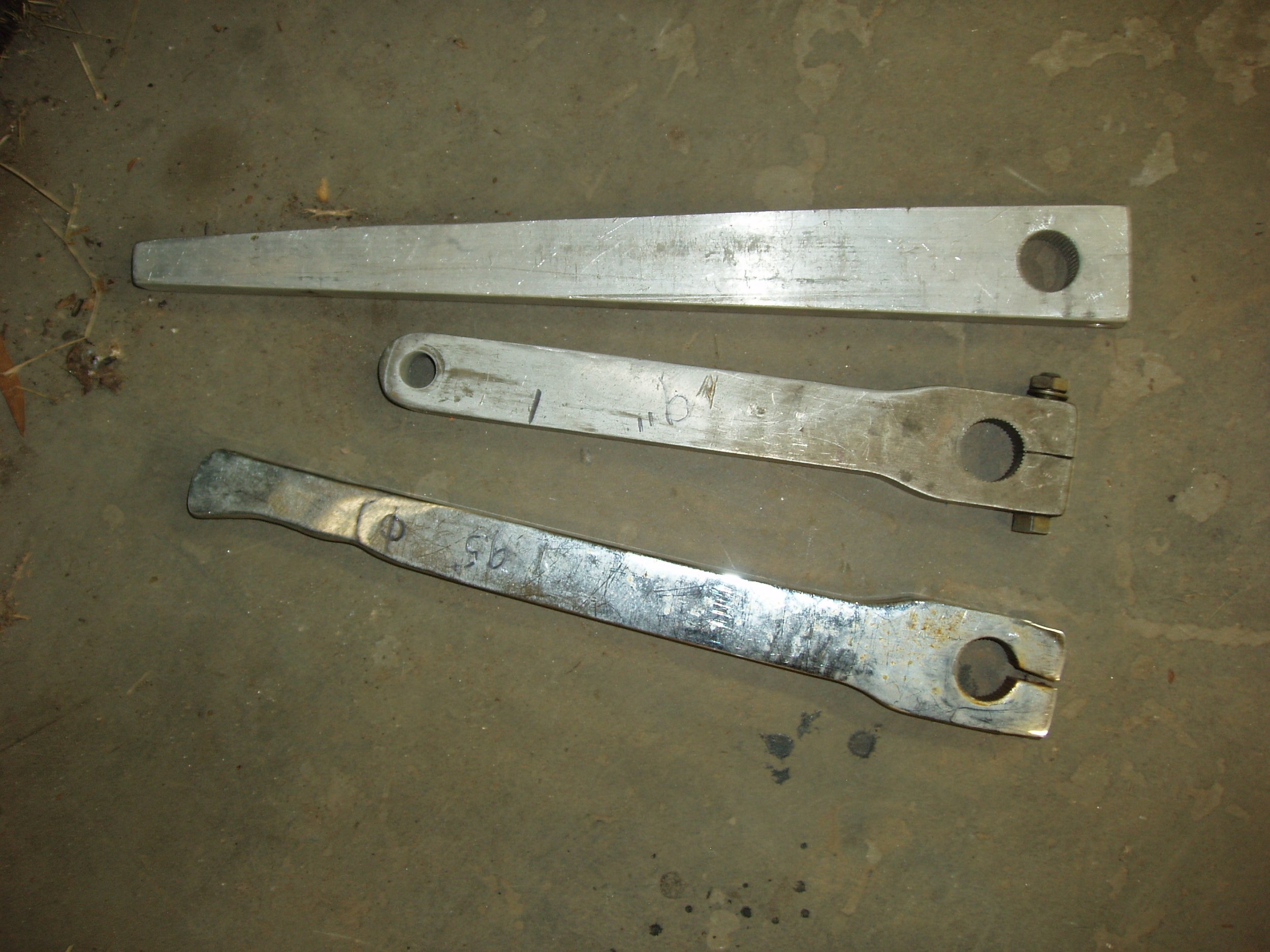

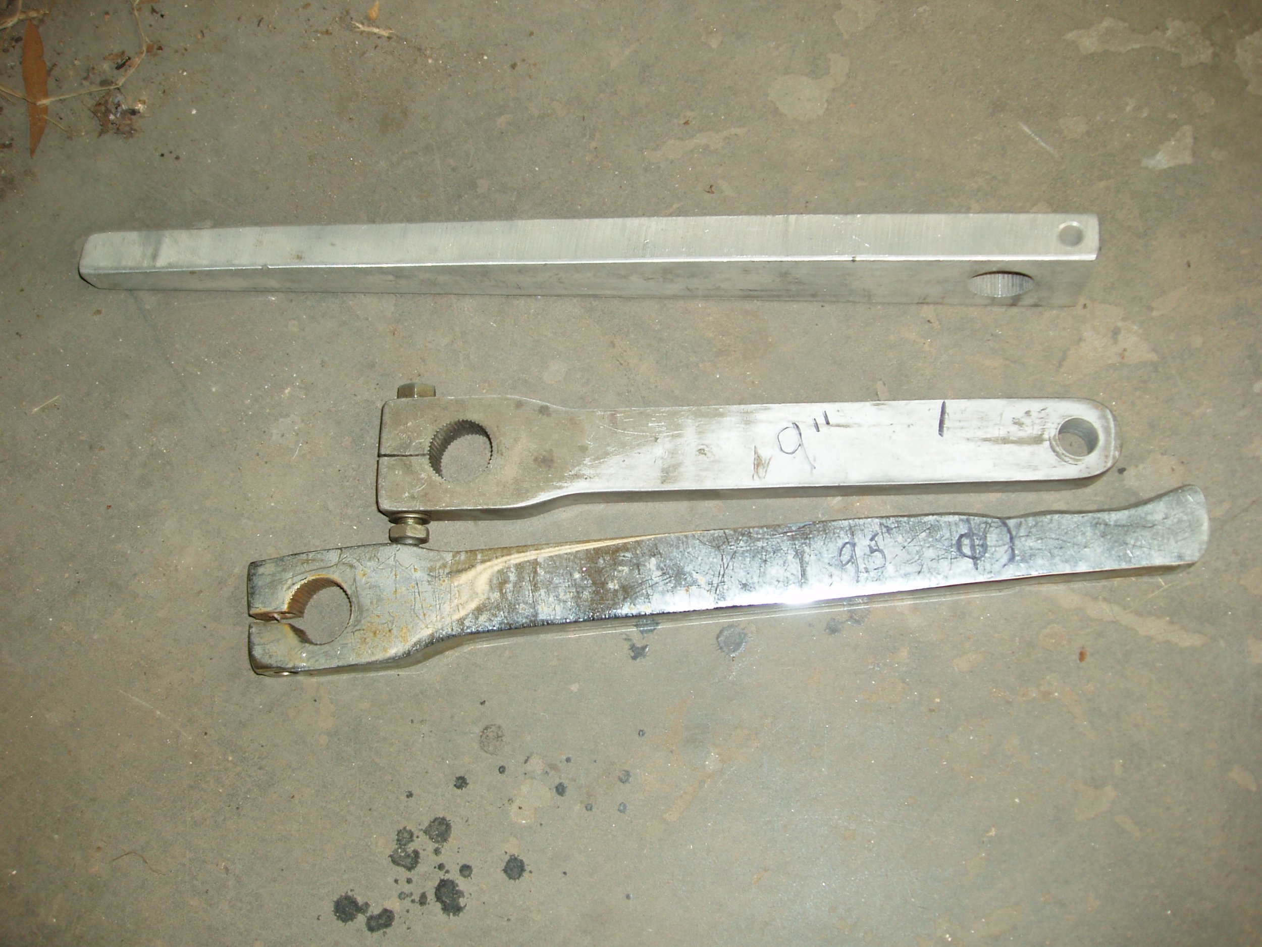

    2 steel. 1 new aluminum. each 80 shipped 2025-02-14 18.19.00-1.jpg 2025-02-14 18.19.00-2.jpg

    As for bump steer, your car does have it. It is just at a level where you are able to easily tolerate it.
    This car has demonstrable, instrument-recorded bump steer. I can feel it.
    The owner claims that it does not. That is his perception. It does not reflect reality, but you know what?
    That's good enough. He's comfortable driving the car, as you are comfortable driving yours.
    It has a 1:2 box, run backwards on the shaft to the wheel, so it is 16:1.

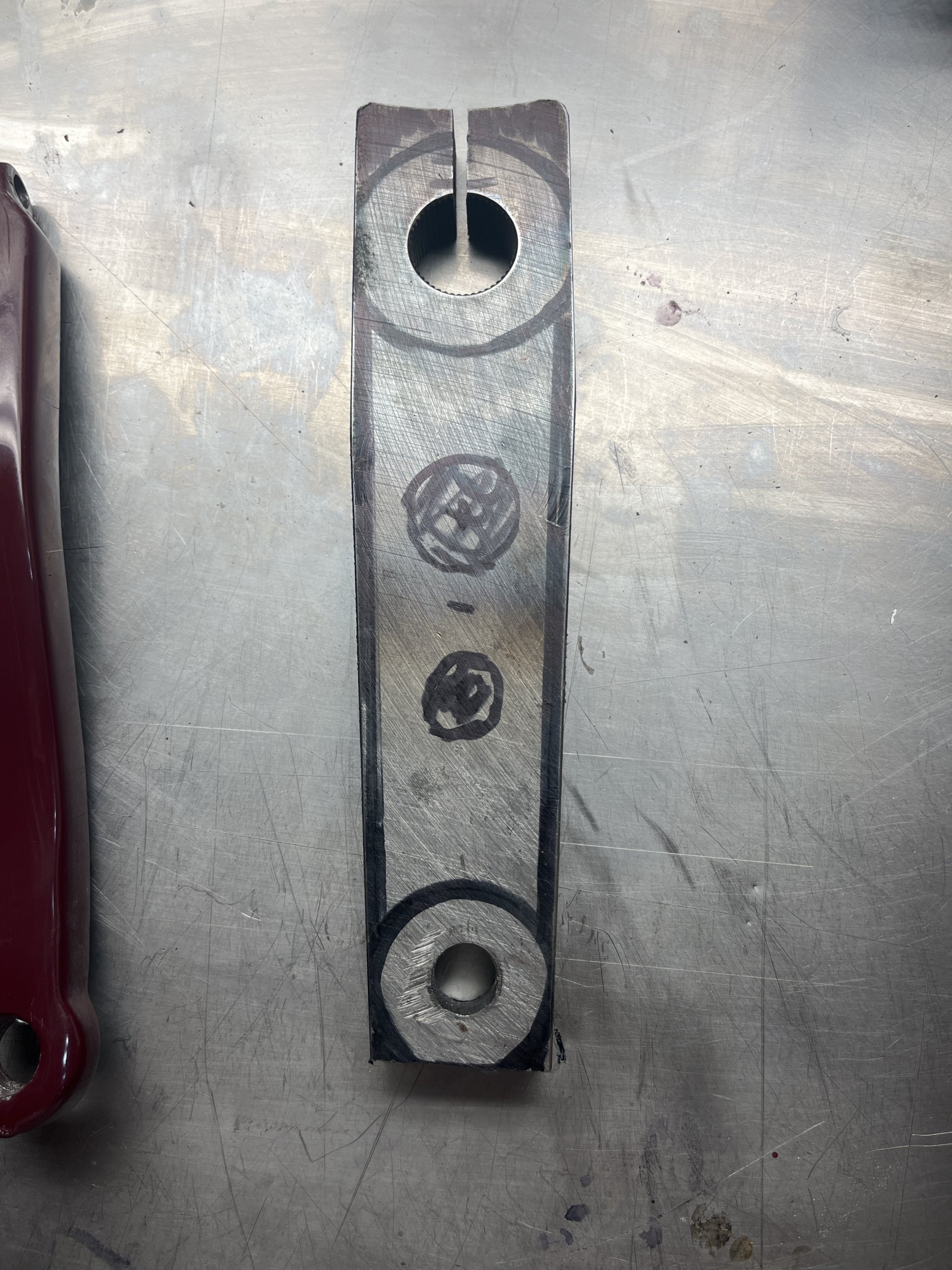

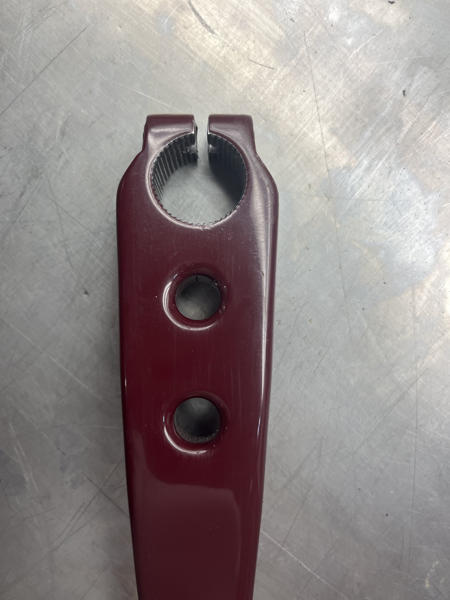

    Yes, it's Physically impossible for my configuration not to have bump steer. The only way to have no bump steer to have the drag link and bone length the same and parallel. I have the 16:1 box so 11 years ago when I built the car i mounted the box high thinking a long arm was going to be used. Fast forward I want to make the pitman the same length as the steering arm giving me a true 16:1. I also put longer steering arms and a stabilizer. The longer steering arms also improved stability, I guess less force on the arm. The reason iam looking for a new cowl arm it appears to have been ground down to much, scarce me a bit giving not thick enough at the shaft. I found a steel torsion arm I work with that. Thx dudes
