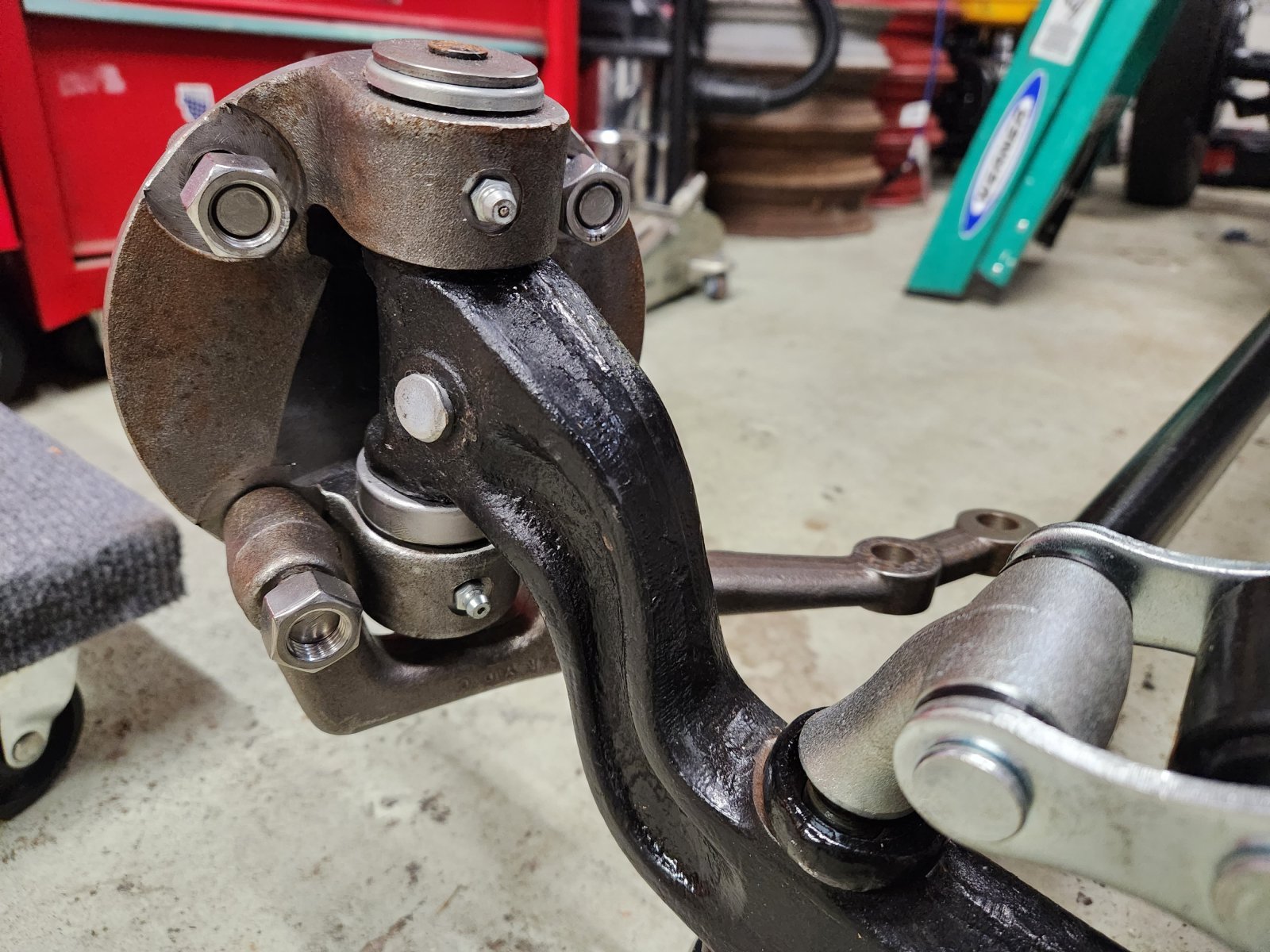

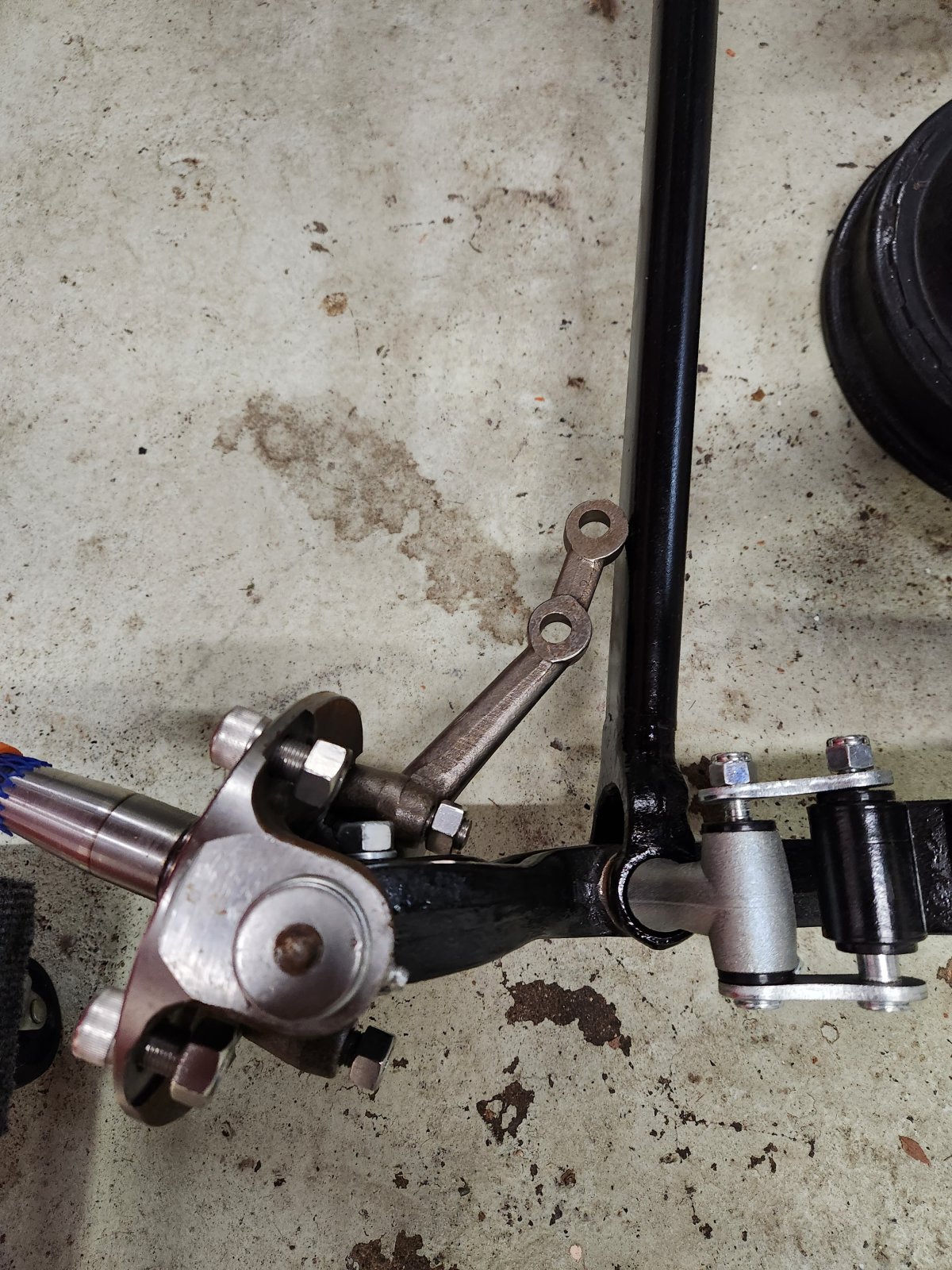

  7. 66Coronet440
    Joined: Oct 26, 2009
    Posts: 425
    66Coronet440
    So this is what I have going. As far as I can tell, the wishbones were set up for the 3" drop axle. My ch***is is 2x4 box tubing. As I don't have the body or power train mounted, I'm considering going to an original A ch***is.
  8. gimpyshotrods
    Joined: May 20, 2009
    Posts: 24,519
    gimpyshotrods
    Those are just the wrong arms.
    You need ones with a deeper drop.

  12. Mr48chev
    Joined: Dec 28, 2007
    Posts: 35,985
    Mr48chev
    Gimpy nailed it as he usually does.
    A side shot would have been nice though.
    Side note that little box that says full image helps us old farts see what is in the photo a lot easier. round back with bones.jpg Round back with bones 2.jpg Screenshot (1099).jpg

  15. X38
    Joined: Feb 27, 2005
    Posts: 17,498
    X38
    Bit hard to tell, but it also looks like a late axle that's been dropped, which allows less swingin' room.
    By late I mean after '36.
