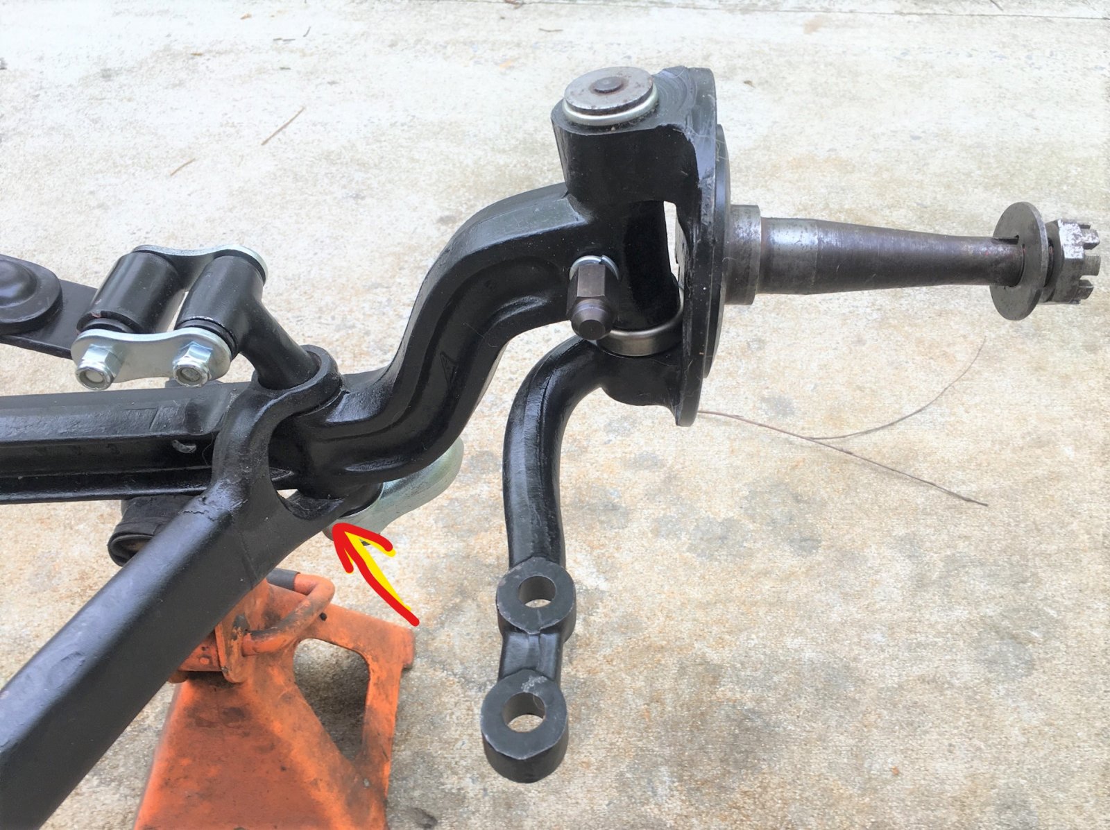

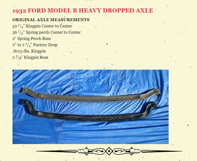

    Note the distance between the kingpin and the springperch on this earlier dropped axle that had an upside down bone on it and that was the subject of discusson. Note the clearance for the reshaped stock steering arm.
    The images below were borrowed from www.droppedaxle.com Rather than post the link as I usually do I wanted them out for show and tell.
    Back in the early 70's when I built my T bucket I started out with a later model Axle that I dug out of someone's s**** pile and the tires hit the bones when you turned the wheels because the bones were out so far. I was running it spring over with a lot of measuring spring wise and I ended up putting a bend in the bones to clear and that wasn't even a good idea looking back at it.
    If you have room to move the back ends of the bones in under the rails close to like they would have been with the original wishbone it should clear. That is how the Fat fender guys run the bones when they do a trans swap and don't have the original mounting spot.
