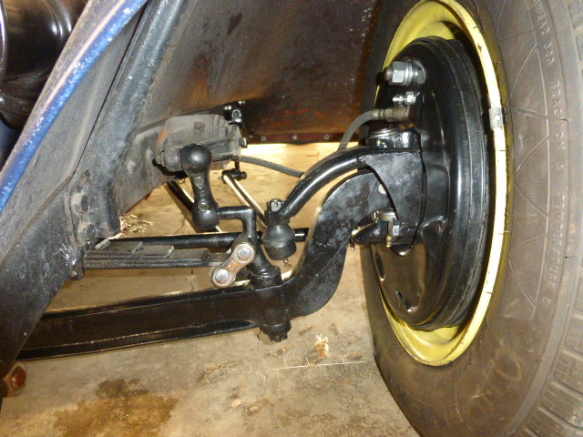

    The car steered perfectly with the stock axle. I wanted to retain that with the dropped axle.I made a bolt on steering arm that mimicked the stock arm.
    I took some 3/4 bar and threaded the ends to fit the spindle. They were bent and welded to a socket for the tie rod end. The bars were boxed and braces were added picking up the lower holes. The arm was also set at 90* to the drag link by angling it forward like stock.
    It had zero bump steer.
    The axle and steering box were other projects
