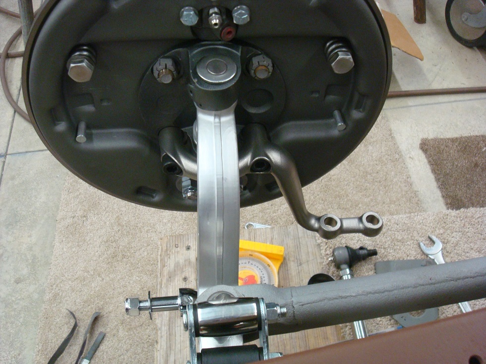

  7. shockley_67
    Joined: Feb 11, 2010
    Posts: 73
    shockley_67
    Thanks for the replies. I was looking at the SoCal deep drop arms but didn't want to pony up that much if there wasn't a chance they would work. I'm not planning on bargain shopping steering parts but why is the idea of a tapped arm not such a good idea?
