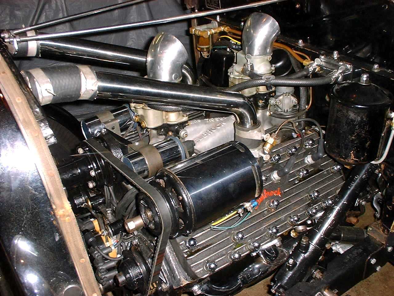

    This is the setup on my 32 using a 54 f-100 box without a tapered flange or welding. The box mounting flange was machined for proper angle and machined flat for bolt clearence.
