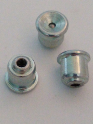

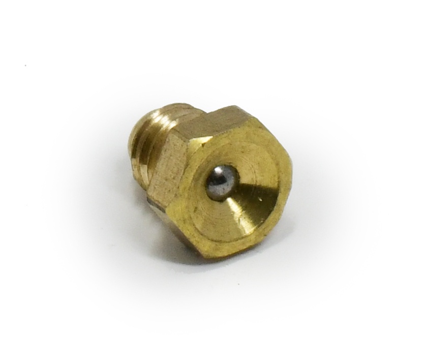

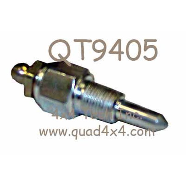

    You buy these
    then grease with this .
    If these is still not enough space go to your closes forklift part distributor and look up “ press in flush mount zero fittings” Raymond uses them all over the scissor or pentagraph mechanism.
    All this thinking and brain smoke for a zerk :confused:
    more then one way to skin a cat
    Like @gimpyshotrods said pack it with grease then plug the hole, if when grease is needed you would have to take some stuff apart so be it.
    looks like you got a bunch of work into this thing, why muck it up and over think this ?

    VANDENPLAS likes this.
  28. sometimes yes , sometimes no. I see on a regular basis where a bushing or pin will either be drilled or have groves in them to disperse the grease , if you just drill a hole in a random spot the grease won’t travel everywhere it’s supposed to.
    Not an “always “ rule. But something to look out for
    forklift or industrial parts suppliers will have them, like I said Raymond reach trucks use them all over the reach mechanism and walkies use them.
    I have never seen them on the shelf but I’m sure any industrial supply that stocks Almite or Lincoln grease fittings could get them for you.
    If you where closer I’d say swing by the shop and I’d give you a bunch :)
    These are the press in ones I was talking about, they sit flush to whatever they are pressed into and the centre where you grease them is slightly dished .
