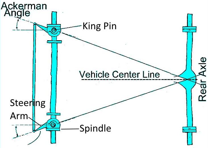

    Akerman with tie rod in front.
    Not impossible but can't be done with stock parts. Not sure if the kit works or not. but a little time mocking it up and checking with strings like the pic shows will tell you

    To get the correct Ackerman with the tie Rod in front, the tierod ends need to be in farther than the brake backing plates will allow. Do not do it!

    No brake backing plates. It's a disc brake axle, not a drum brake setup. So it is possible to get the Ackerman correct, as Speedway does sell steering arms that are for their axles that put the tierod ahead of the axle. And as I mentioned, one of my cars has the tierod up front, and I made up new steering arms to get the Ackerman corrected for that car. Mine is also disc brakes in front.
    And the ends need to be out further, not "in farther".
