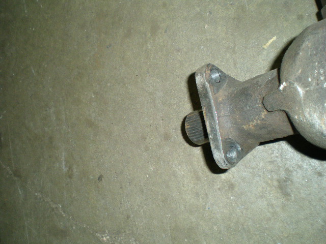

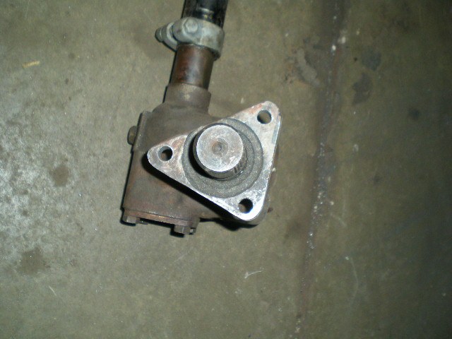

  2. Put a couple of them in Model A's. Usually cut down the flange to better fit into the frame, like in the attached picture. May need to shim the mount to put the column in the right place.
    Some people cut off the flange and put a new one on; @Andy posted a tech on this here or on the Ford Barn.
    A later pitman arm uses a regular tie rod end if you don't want to mess with the ball and socket end the '56 uses.

    I made a weld jig off a 32 steering box. I welded a new flange on to fit the car. No cutting and it fit perfectly the first time. I also cut the pitman shaft down to fit an A pitman arm. That way I did not have enlarge the hole in the frame. Much nicer looking and no bolt clearance problems.

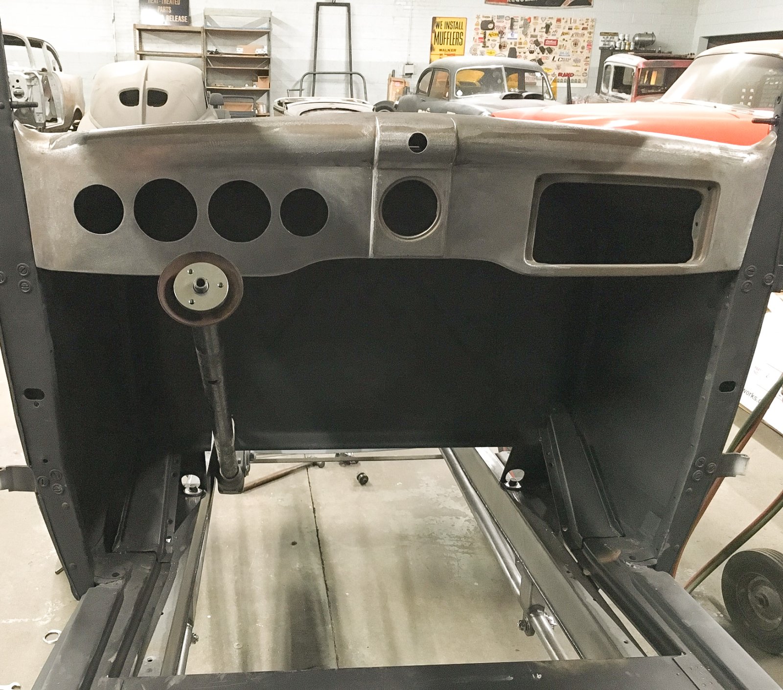

    Rebuilt F1 box with a 4 bolt Model A flange from Neal Jennings.
