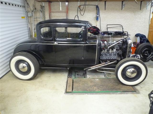

    Hi all
    I finally decide to swap my original model A steering box, but what's the best choice?
    As I live in europe, it's not so easy to find a F1 box... I do have a VW box form a bus, but I do not feel confortable to drive my hot rod with a german steering... ;-(
    Please give me your tips, advice, recommend.
    Many thanks
    Peter

    Hi everyone
    Yes I did sell the blower set, it was time to test something else...The engine plan is now a stroker 296ci, i will check for a better steering box first ;-)
    Thank you for your help
    Peter
