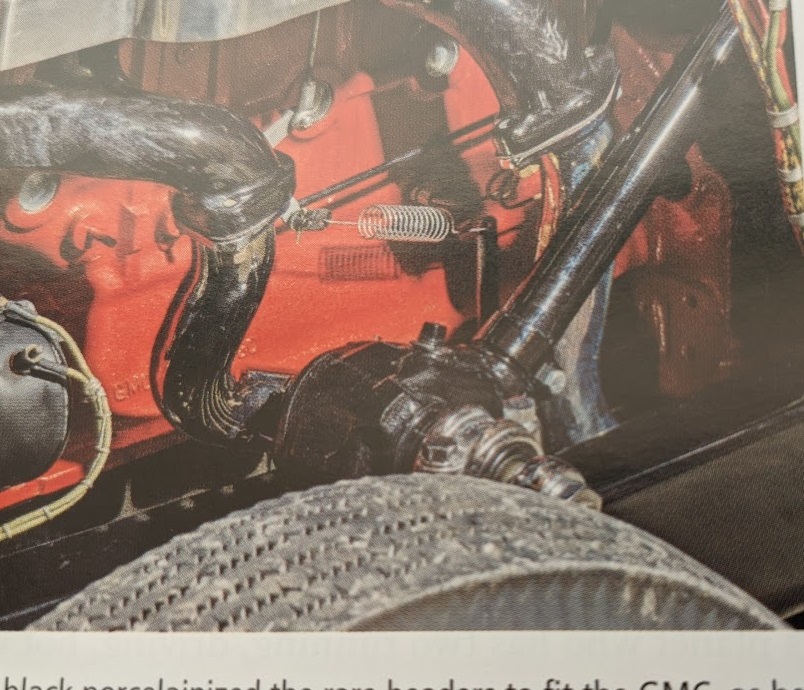

    I found a picture of one in use in a hot rod.... Steve's 31 Chevy roadster, in TRJ65. He used lots of 1940ish truck donor parts to build this car, front and rear axles, steering, etc.

  15. Looks like the 30s GM pickup box I used in my old Touring. Got the idea from Clark aka Sowhat

    Lol... I got this box from Clark...

    That almost looks like a main bearing cap clamping the box to the top of the frame...
    Chappy

    http://chevy.oldcarmanualproject.com/parts/1929_54/396.htm
    '37-'40 Chevy truck, 1/2 -1.5 ton all used the same gear box, the bigger trucks 1 - 1.5 ton had longer shafts for the steering wheel. Pitman shaft / sector gear were all the same.
    16 - 1 gear ratio. Internals are gear on gear, so check the worm gear for wear marks and the bottom bearing for water damage. The lower race is part of the worm gear, so if it's bad you are shopping for whole new shaft or gear box.
    If you rebuild it, add a second bushing where the sheet metal spacer is out towards the end of the pitman shaft. It adds way more support out on the end of the shaft. The spacer is shown as a bushing in section 6.855. Go to NAPA for a seal, NOS 11055. Bearings are barrel shaped and can be had from most of the Chevy Truck parts venders. You can make your own gaskets. John Deere Corn head grease works really good, grade 00 so if flows back in on itself, cheap to.

    There are two machined pieces that clamp the gear box to the frame, you can see the wear marks on the housing 16150668322985545512224126773866.jpg
