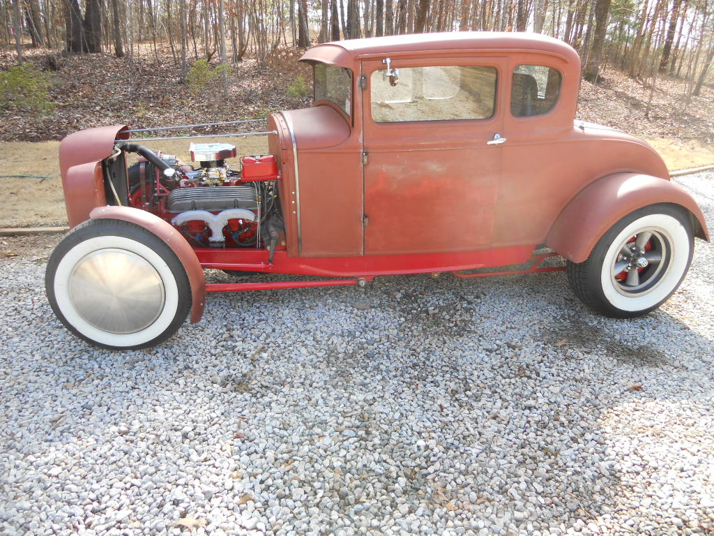

    Can anyone tell me what vehicle this steering box came on ? The lettering on it is ROSS TA122987. The car steers & handles OK but it is heavy steering. Would having the steering box rebuilt help or should I replace it with something newer. Any recommendation for a rebuilder?
    I purchased the car at an estate sale & they knew nothing about the car other than it was in a garage for 35 years or more. It had the single master cylinder & I had it replaced with a dual.
  2. Not sure what that is from, but Ross made a lot of boxes. If you take it apart you may find common parts that you can get from similar Ross boxes.
  3. Ross typically uses casting numbers to give a hint of product ID, and then has stamped numbers to give full ID.
    Heavy steering? How many steering wheel turns from stop to stop? If in the 4 or 5 turn range, look for binding in the box. Does the car wander because it sticks with every steering correction and then need to correct for that? If so, kingpins would be binding in the bushings from lack of lube or incorrect installation.

    Very good tip...My Ross box is only 2-3/4 lock to lock. Mine is not like that one in your pic.
    I'm going to do a major de-caster on my car...just to try it. Your car might have excessive caster...or all the stuff already mentioned. Find out what is really the reason, before tossing parts.
  5. My 72 Maverick/Mustang box has about 5 turns because it is from a manual steer car. Hydraulic slave cylinder assist cars had the 4 turn box.
    To me, 2 3/4 turns would be heavy with no regards to what type of tire or caster.
    Caster will need to maintained to prevent the other known problems asociated with incorrect caster in a buggy Ford front. You don't want to build another problem into what you already have.

    Also to troubleshoot heavy steering would be tire pressure being too low. This same problem will cause other handling situations depending on if it's in the front or rear.

    If the car drives good at speed without bad manners, it's a geometry question having answers to lengths of the pitman arm and spindle arm.
    I witnessed a car built with a Schroeder sprint box in a cowl mount placement, 14" or so steering wheel, wide front tires. Heavy steering in a parking lot, sensitive but not twitchy at speed.
    Pitman arm length from center to drag link end helps determine part of the ratio. Wheel turns determines part of. Spindle arm length from kingpin center to drag link end center determines parts. Wheel width/backspacing/tire width/tire pressure determines some too. All must work together with correct axle caster in a beam axle.
