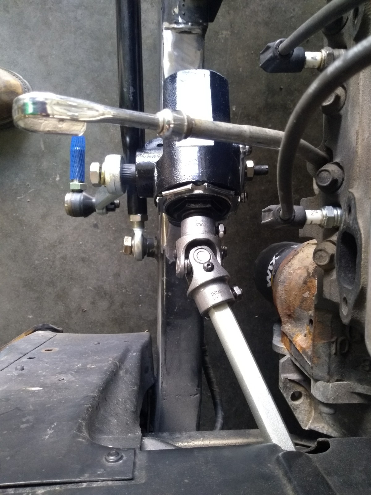

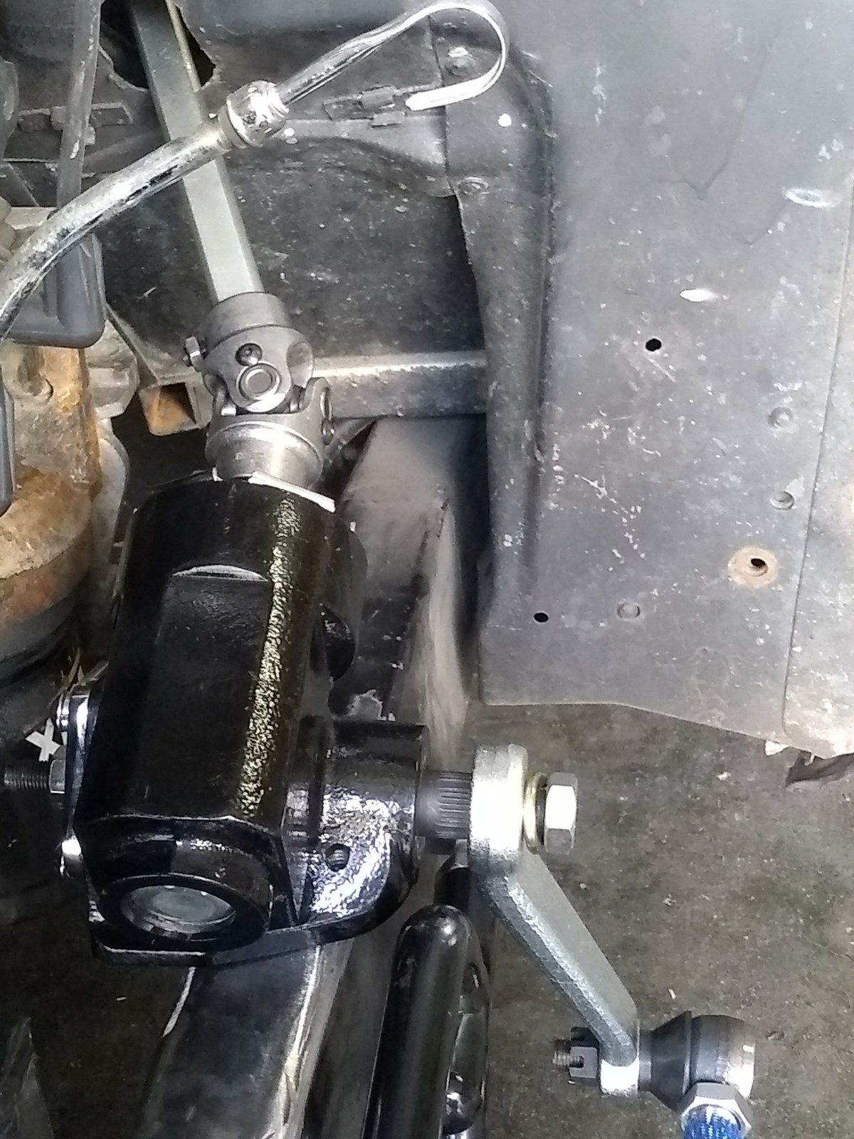

    I got some more mock up done with the steering box. Someone before me kinda butchered a few things on this truck, but I'm working on correcting what I can. Plan is to move the hole in firewall over a little to better align and probably have a mount made to raise the box up about 1 1/2", a short section of double D shaft with 2 u-joints connecting to steering column. Does anyone have any suggestions with this method? Thank you. IMG_20230808_161057082.jpg IMG_20230808_160731344.jpg IMG_20230808_160941602.jpg IMG_20230808_160947911.jpg

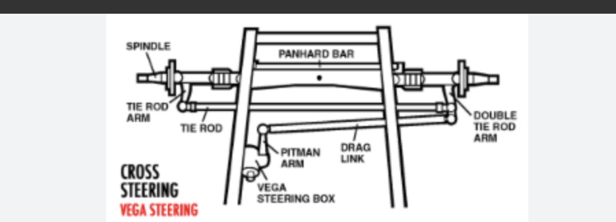

    88DA91EA-0D9D-425C-89D3-55D015DAC7CC.jpeg I’m confused.
    The pitman arm location on that box is beside the frame instead of the engine.
    Are you running your drag link parallel and outside the frame …
  13. Josh1940
    Joined: Jun 7, 2022
    Posts: 46
    Josh1940
    This is a traditional side steer with reversed corvair box, not cross steer.

    Can you use a mount plate that moves the box out the where the u joint is straight?
  15. At least make a wedge mount and tilt the Worm gear up so it's pointed towards the hole in the floor.
