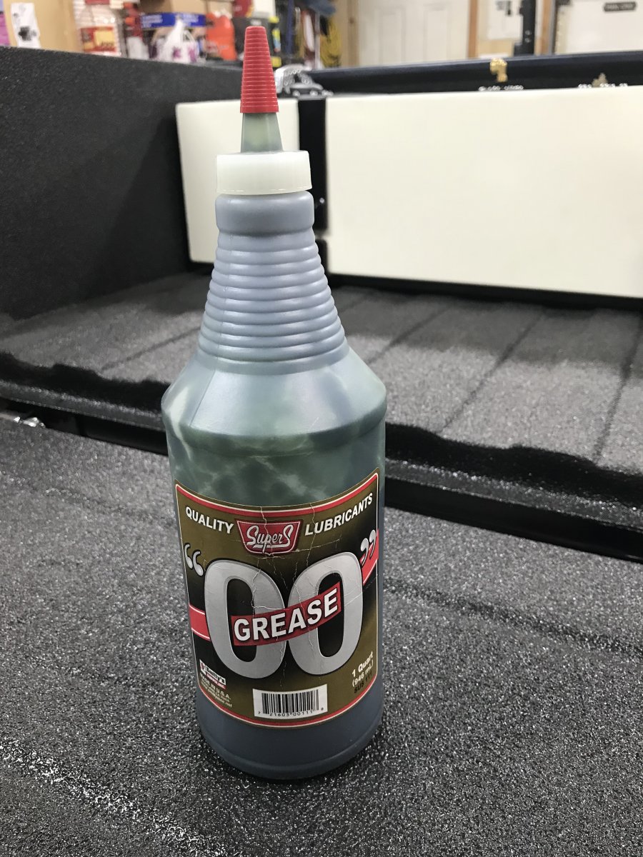

  10. Flathead Dave
    Joined: Mar 21, 2014
    Posts: 4,045
    Flathead Dave
    from So. Cal.
