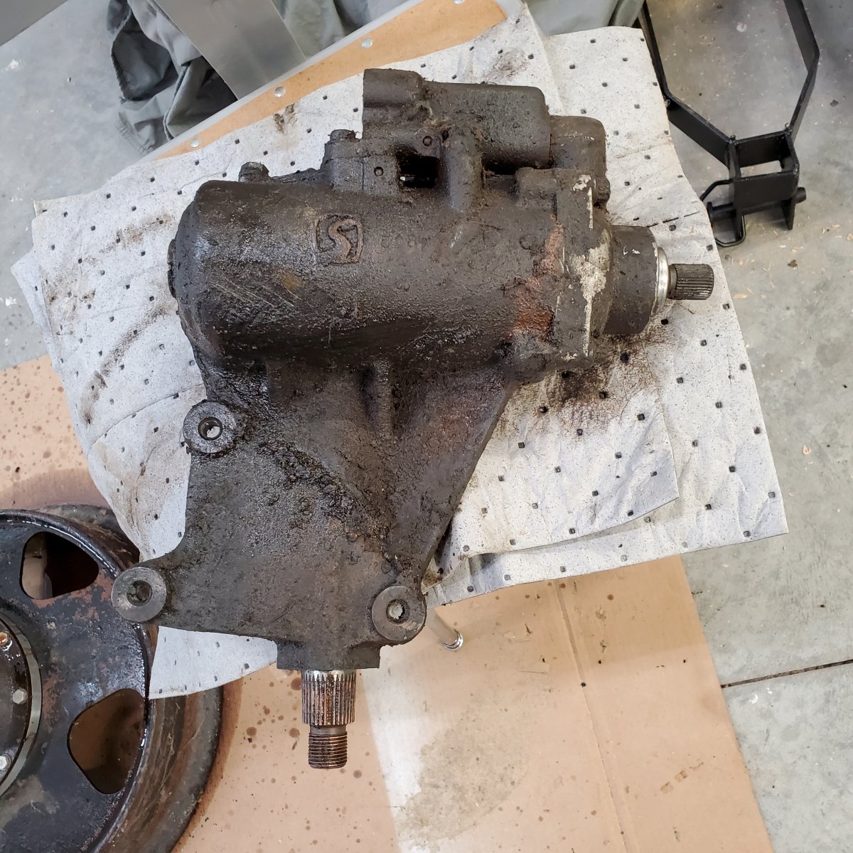

    I am in the middle of swapping a power steering box into my 57 lincoln. The lincoln box has a wandering issue that is notorious. I could have had my box rebuilt. No guarantee the issue will be fixed from my research. I did a lot of research, not a lot of 56 or 57 lincoln owners attempting this. 56 ford guys use a jeep grand cherokee box. Looked at a jeep box to compare to my lincoln box. Looked like it would work. The crazy part is that the pitman arm from the lincoln box fits on the jeep box. Same exact splines. Do a lot of these steering boxes have the same pitman arm splines? I will update this thread as I finish the swap.

    The lincoln box is in the first photo? If so, it's a Saginaw box, quite GM....and Jeep got a lot of steering gears from Saginaw over the decades also, so it surprises me not at all that the splines are the same.

    The jeep box is made by Delphi, The lincoln box is saginaw (first photo).

    Delphi is the company that took over Saginaw, Delco, etc, isn't it? They're all GM subsidiaries, or something.

    Makes sense if that is the case. They would want to reuse broach tooling. I just thought it crazy, that 58 years apart stuff still fits together.
