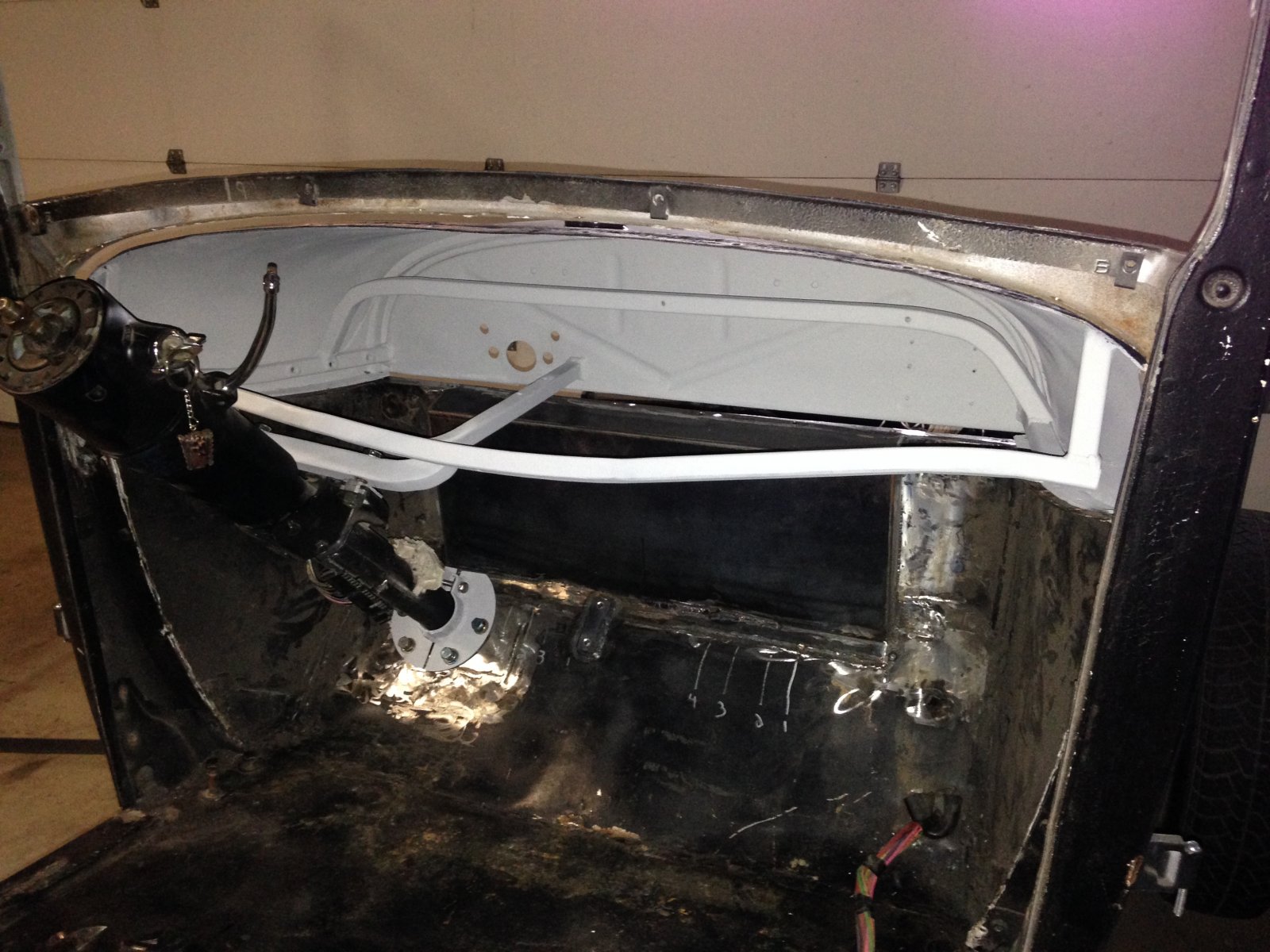

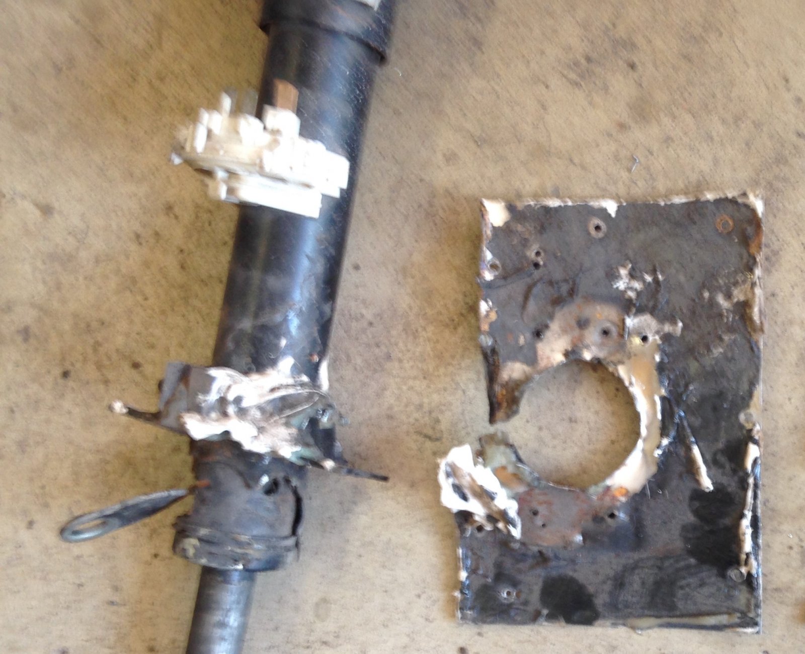

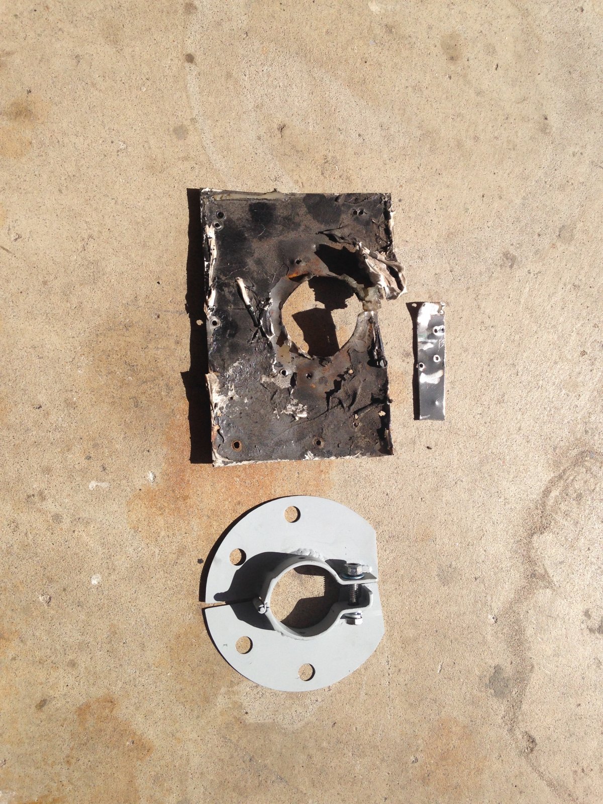

    Once you get the alignment of the column correct, fix the bottoming-out of the steering shaft, you'll be able to cut out that mess on the toe board, weld in new sheet metal, and make a good soli 1928  Model A Steering column mount 1.jpg 1928  Model A Steering column mount 2.JPG 1928  Model A Steering column mount 3.JPG 1928  Model A Steering column mount 4.JPG 1928  Model A Steering column mount 5.JPG d bottom column mount.
