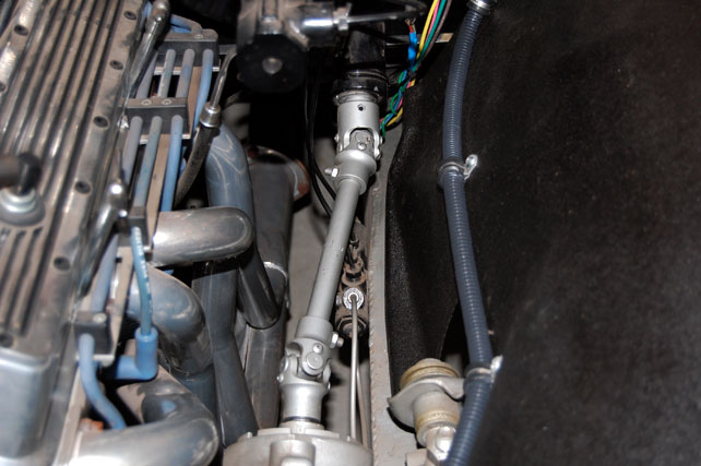

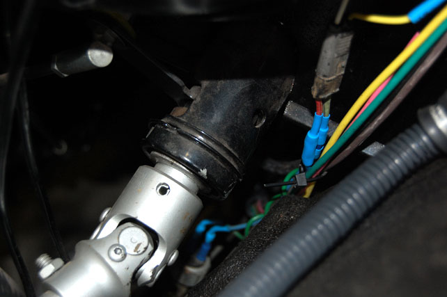

    Here are a couple of pics on the engine side of the fire wall. Let me know what you think on whether its been modified or not.

  2. Just pop the wheel and put a 4" sleeve of some sort over where the switch was. Paint. Done. I'd have more confidence in that than in some new thing you have no idea where it was made. Reliability? I never heard of a steering column wearing out. With exception of junk plastic parts in some of these replacement columns made in China someplace.
    Don't you buy the aftermarket ones by length, anyhow? As long as you know that I don't see that it makes a difference if yours has been altered.

    Doesn't look cut to me. Do you have any pictures of how you shaved the key off? I'm considering doing the same thing.

    I already put a sleeve over the offending ground off stuff, the tilt is even covered up. Id prefer a more stock looking appearance vs. the fat column. All the stock wiring to the column is gone. I installed an aftermarket blinker, which works fine, but I just don't like the looks that much. If the column isn't cut I can find out the length easy enough so when I order a new column I just give them the stock length. Im hoping for as close to "bolt in" as I can get.

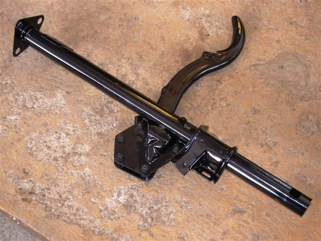

  13. All GM cars had the switch on the dash until '68-'69 (depends on body style). It's not hard to find a '60s column, although a tilt will set you back $150 or so unless you can score it in a you-pick yard. Turn signal switches can be an issue in them, old plastic in obsolete parts.
    I nabbed one out of an early Corvair a while back just because it had a round early style E-brake handle and bracket right on the column, it looks like it belongs in an early car except it has a turn signal switch in it. So far no one else sees what I saw in it, though.

    as rusty said corvair columns are pretty simple and have an ebrake built in. they've been used in ho rods a bit. and they are usually fairly cheap.

    Lots of good ideas here. Ill have to see if I can find a pic of a Corvair steering column. My truck has a foot brake my buddy put in, and now I'm wondering what this Corvair brake handle looks like, and can it be incorporated to operate my emergency brake. I bet it will be hard to find one around here even if I do like em.

    found one on the internets, interesting. similar brake handle to 55-66 chevy pickups.

    I had a 65 and 66 airvairs and they both had the hand brake under the column.
