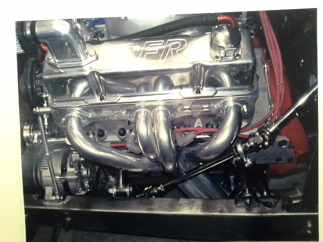

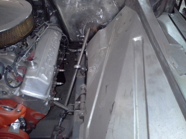

    Not sure what you are putting this in but as long as you already plan on a short column you might consider this layout.
    Stubby aluminum column I made, only the 3/4" shaft p***es through the firewall with the first joint on the inside which allow an angle change before it gets close to the header area.
    This also gives you more flexibility for column angle/ steering wheel placement and also negates the need for a tilt column.
    I did something similar on my 66 Suburban, had Ididit build this column, it's around 24 inches long.
    This shot of my Suburban shows the value in changing shaft angle (in two planes) before it enters the engine compartment.
    My roadster
