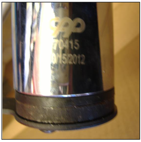

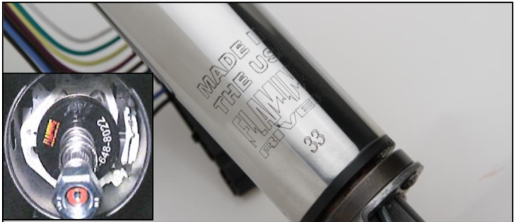

    Years ago Borgeson didn't have anything to ID them like IDIDIT, CPP or Flaming River, things may have changed. Is it tilt or conventional solid column. Could be cheap Chinese junk column or Hoffman brand (Helix above). If cheap tilt, throw it in the bin. Once dis***embled check for poor construction, unsafe welds etc.

  6. mgtstumpy
    Joined: Jul 20, 2006
    Posts: 9,294
    mgtstumpy
    More cheap /unsafe Chinese columns, ProComp, Wysco and RPC. Please take the time to read the attached article and don't use those inferior / unsafe columns. You could save not only your life but someone else's; these columns just don't meet current safety standards. Safety isn't optional, it's mandatory IMHO. Never skimp on brakes, steering or suspension.
