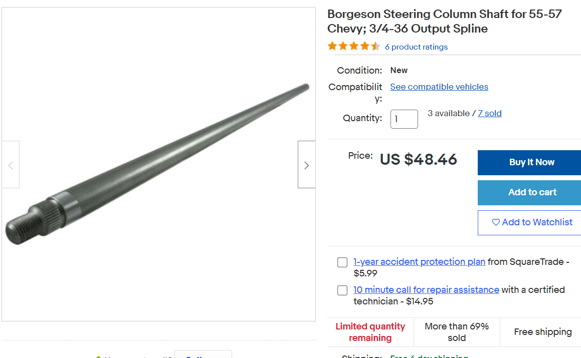

    I'm revising this a bit.
    Simple and cheap for a "g***er" might be a 47/53 Chevy truck column that someone has cut off at the box.
    It takes a standard Chevy spline steering wheel hub for your "g***er steering wheel" the tube is pretty clean and clutter free and you can get a bearing saver bearing for the bottom end and probably at a better price than this one from Cl***ic parts.
    Cut the tube and shaft to correct lengths. grind the flats to use a double D U joint on the shaft and you have your g***er column that is clean and plain but if you need turn signals you will have to use a clamp on turn signal switch. Screenshot (1649).png

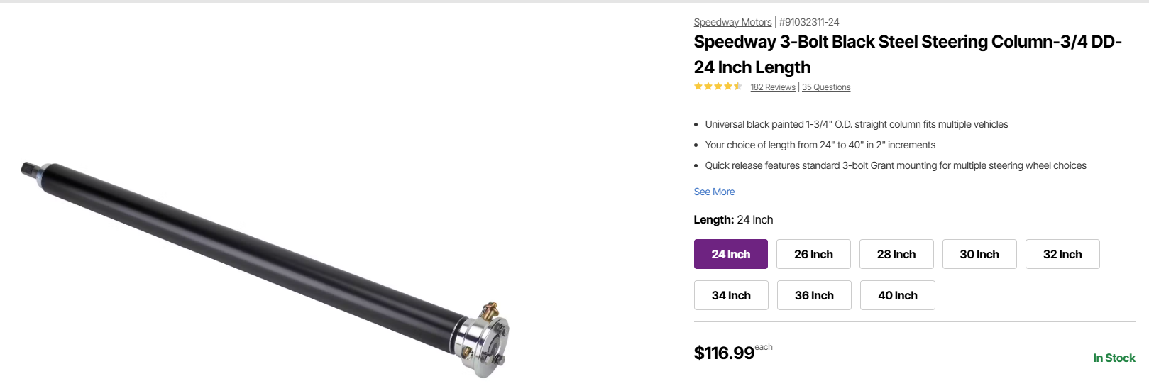

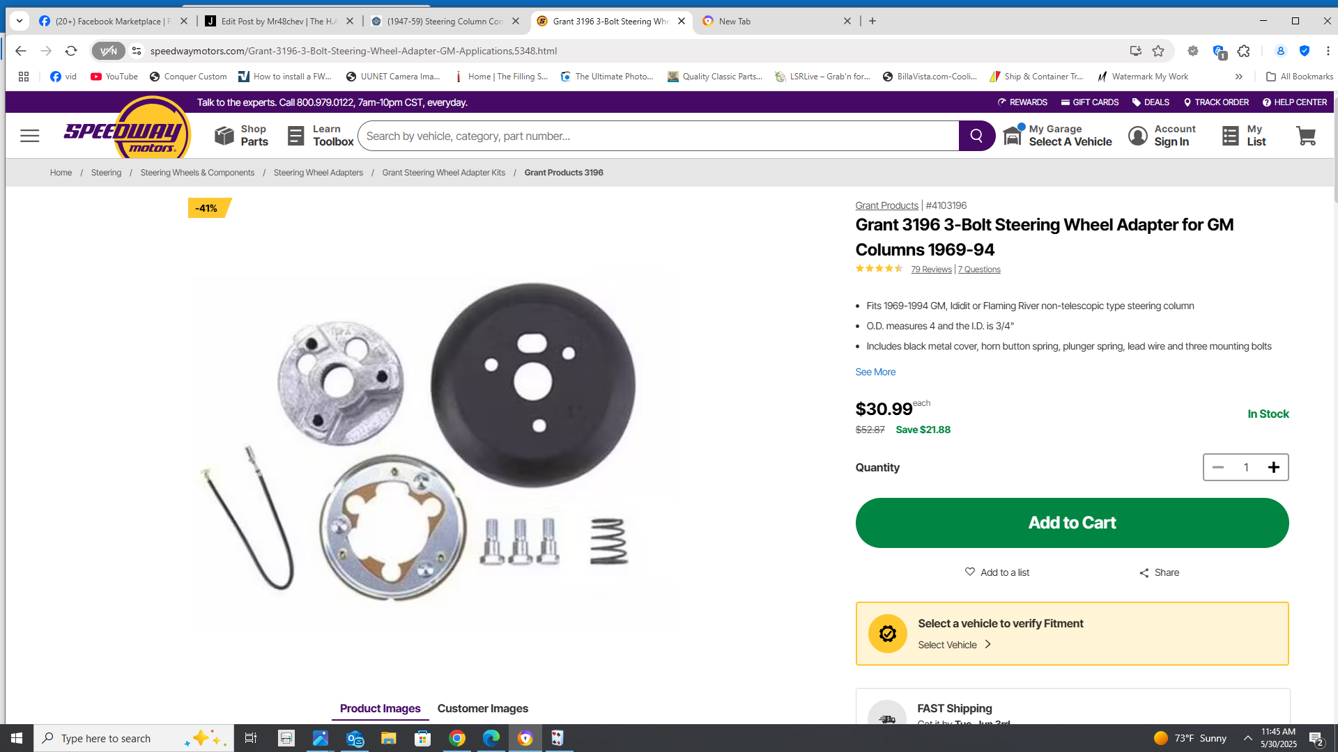

  15. Mr48chev
    Joined: Dec 28, 2007
    Posts: 36,230
    Mr48chev
    Hunting that one down shows that you can get in lengths from 24 to 40 inches and even at the current price range (now 116.99 for the 24 inch) and 124.99 for the 32 inch that many of us choose, when you add in a 4o dollar bearing and a now 30 dollar steering wheel adapter kit plus what ever you give for a used column it becomes real cost effective. Screenshot (1650).png Screenshot (1651).png Screenshot (1649).png
    TwistedMetal likes this.

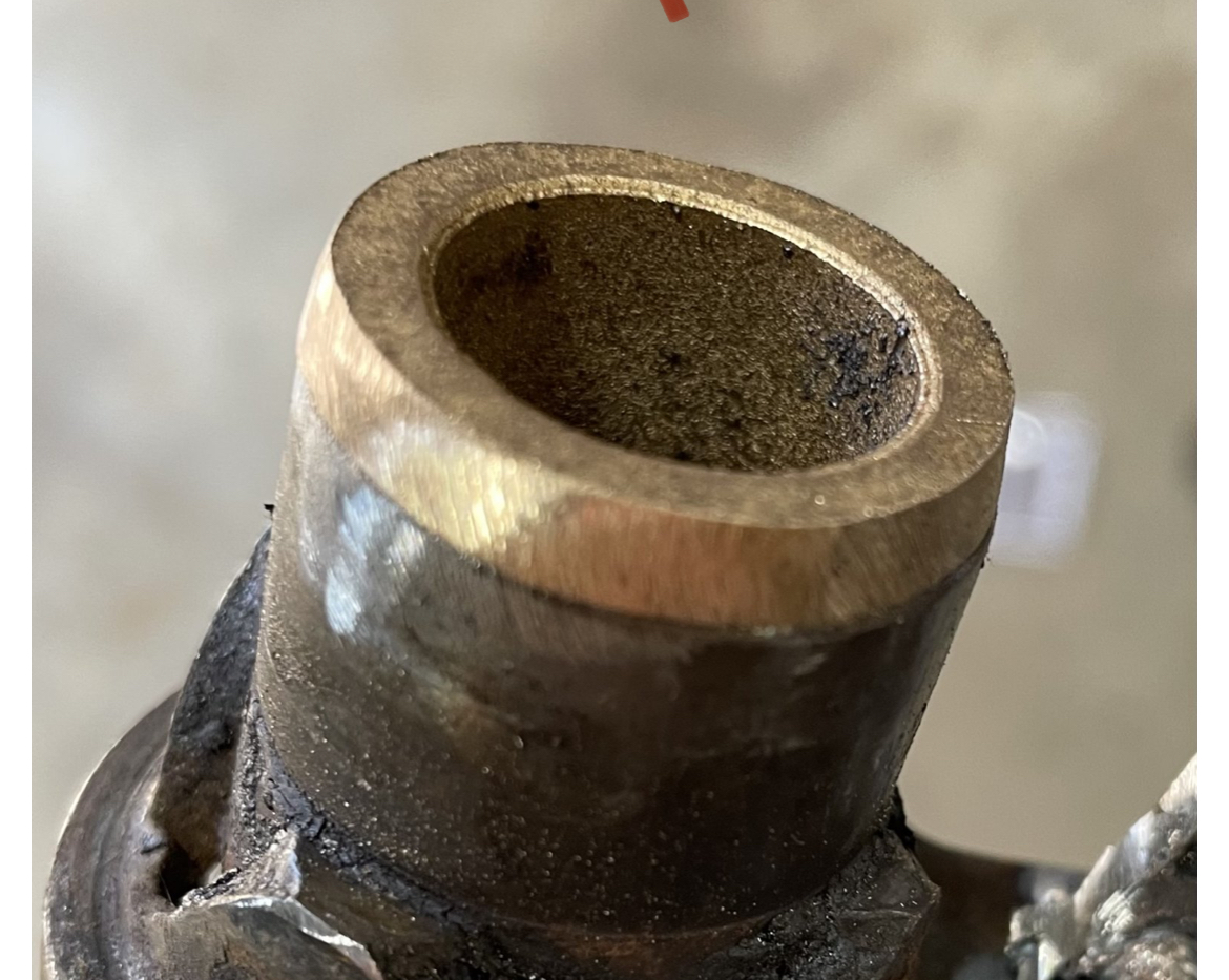

  17. Cut tri 5 column with rag joint added
    Ground the flange on a hardware store
    EZPZ

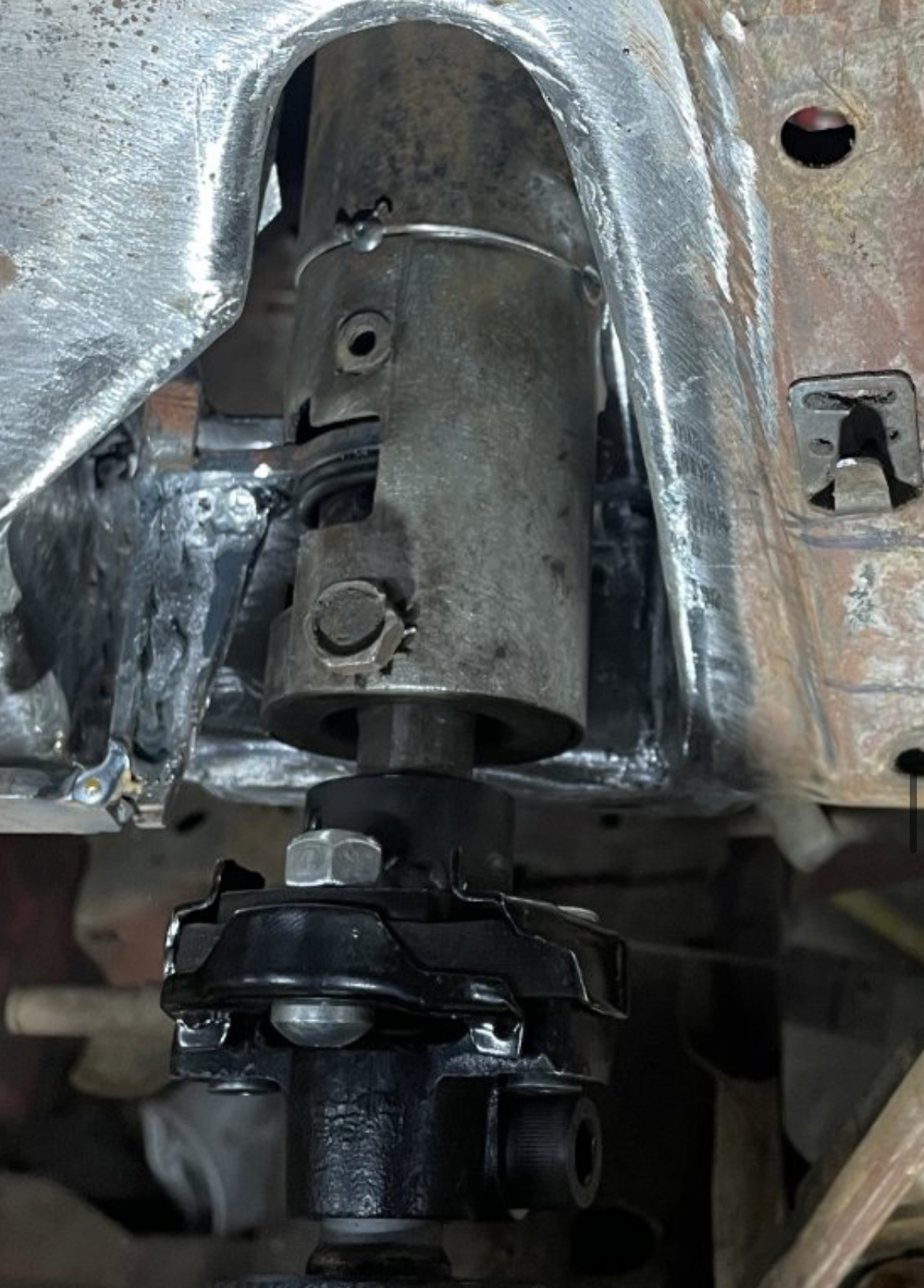

  24. jaracer
    Joined: Oct 4, 2008
    Posts: 3,134
    jaracer
    I got a U-Pull-It steering column and modified it to fit my application. It came out of a late 60's Chevy truck with a floor shift. I needed a shorty, so I cut the column and the shaft to fit. I milled two flats on the end of the shaft to accept a universal joint. I think it cost me under $50.00. 2015_01_16_0357.JPG 2015_02_27_0364.JPG
