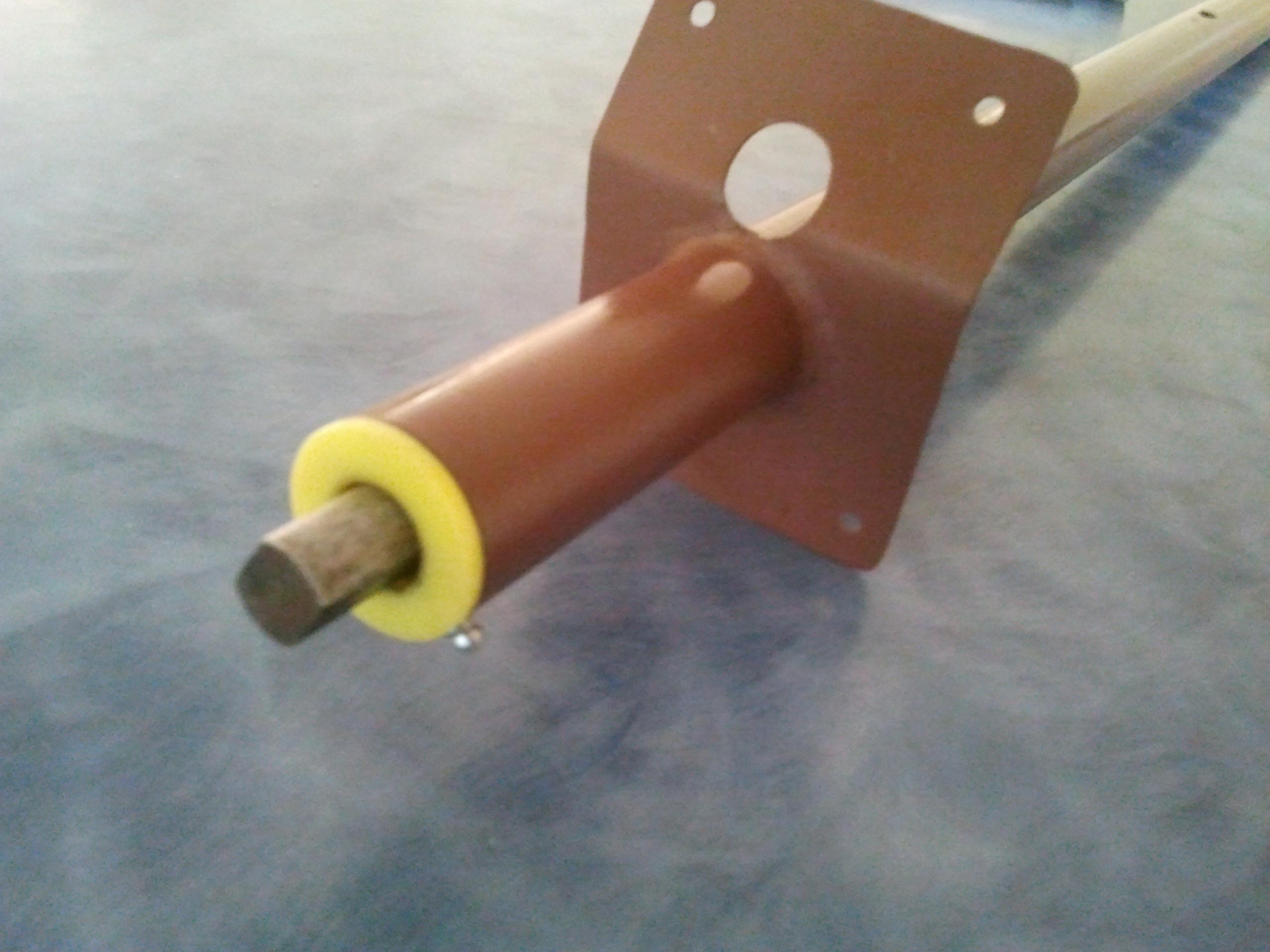

  3. mgtstumpy
    Joined: Jul 20, 2006
    Posts: 9,256
    mgtstumpy
    I did with my '46 Olds. Retained OEM column, cut it down, turned inner shaft to DD and added a bearing support as stated. I also added a plate on bottom of tube so that column can bolt to toe board as it's already supported at dash end.
