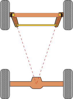

    Agree, ackerman angle is wrong. See pic that shows how the steering arms should point to the center of rear axle. You have opposite of ackerman with the spindles reversed to front steer. Also if you want a steering stabilizer, it should be inline with the tie rod. If my interpretation of your pictures is correct, your stabilizer is 90 degrees to the tie rod? Have you checked toe in? The heim joints should have at least the large washers under the bolt heads to prevent failure since they are in single shear. Overall seems to have too many points for a little play which will always contribute death wobble. Agree your shocks need to be shorter, you have no susp travel to speak of. That lack of susp travel is good though at the moment, because the way your drag link is set up it will have some bump steer. Longer drag link all the way to the p*** side spindle is better. Think of the arc of the drag link as suspension moves up and down, it moves the tie rod left and right; a longer drag link helps minimize this. If the axle was just swapped left for right by turning it 180 degrees, it would have positive caster as well. Proper required is negative camber - top of spindle is leaned back relative to bottom when viewed from the side of vehicle.
    I do not like what you have, but the above points are valid for what you need to fix. You can carefully heat and bend the steering arms to get them to have proper ackerman. Some of the other problems may require some re-engineering. I won't say that a Must II based IFS is bad, being a full fendered it is hidden. Not traditional, but can be made to work fine and will be an improvement over what you have on the truck now.
