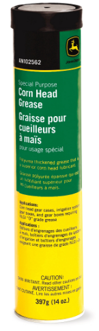

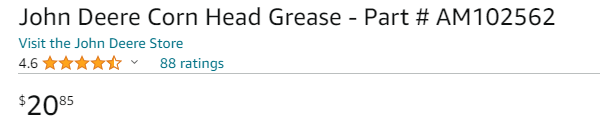

    Too bad you're not closer. I've got 4 tubes of this that I'll never use.
    Amazon
