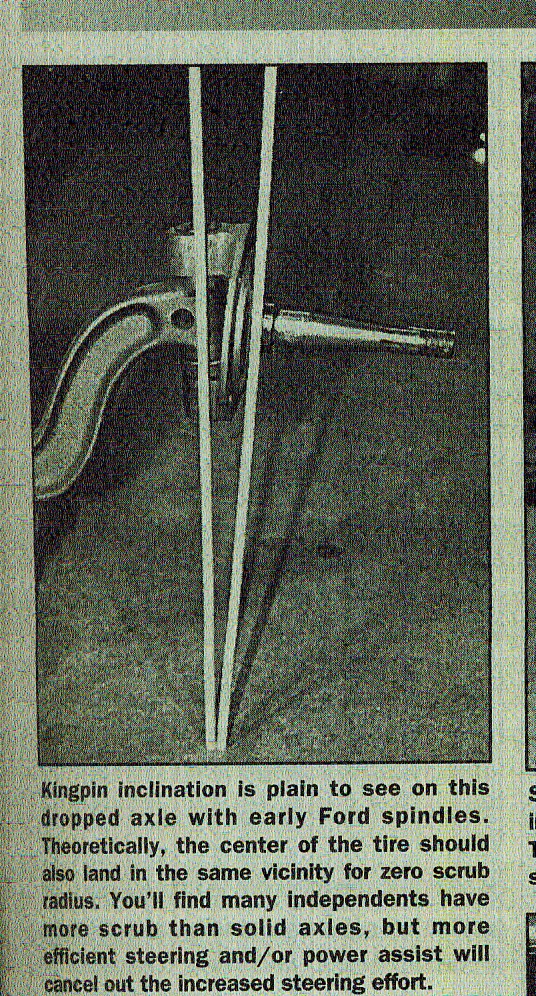

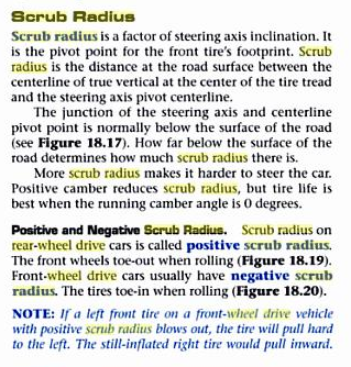

    Thanks. I will get the correct drag link first because it is way to short. And yes I just looked at the angle of king pin and tie rod and it’s way off.. now I know what he meant about a 200’ wheel base.. haha. So what’s the deal with the scrub? The center of the tire should be inline with the gap between the center of the kingpin and the spindles??
  11. Step 1 is going to be correct the scrub radius. You're dragging the tires across the pavement with the steering wheel not turning them. I'd imagine that feels like what someone would call a bind.
    Step 2 is going to be the drag link pitman arm relationship.
    Count steering wheel turns, center and mark it.
    Measure degrees of movfmt at Pitman and center pitman vertically. Now measure for drag link.
    Doing those 2 should make it at least drivable

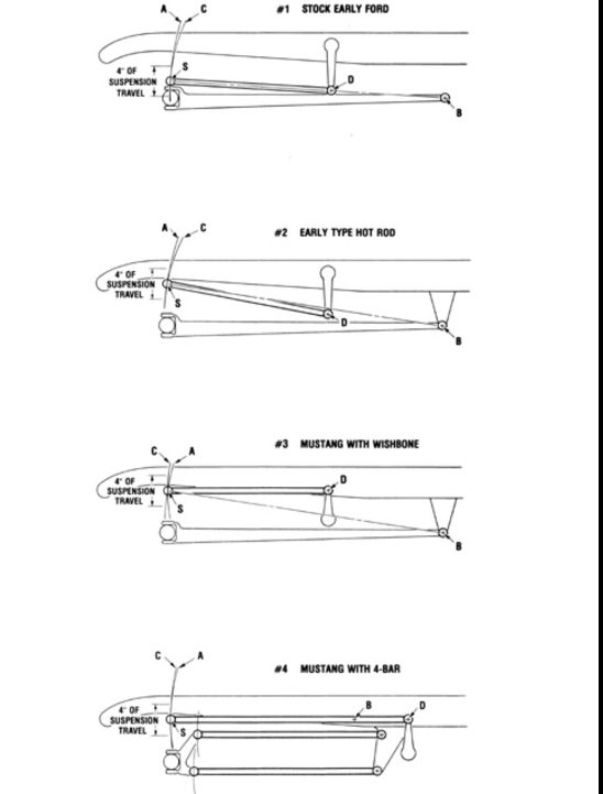

    With the steering box mounted where it is , if he centers the pitman arm vertical , he's gonna need a mall parking lot to make a right hand turn .. the steering arm will hit the body. Because of the way the steering box is more or less hanging in the breeze and that extremely long pitman arm , I'd recommend that he look for another box . Look at some more setups to get an idea about bump steer . Flat plate steering arms work just fine . Please do some more research before you do any more fabrication, there are reasons things are built like they are , you need to learn them .. I'm 71 , I try to learn something every day. .......Don't ask HOW to do things , ask WHY !
