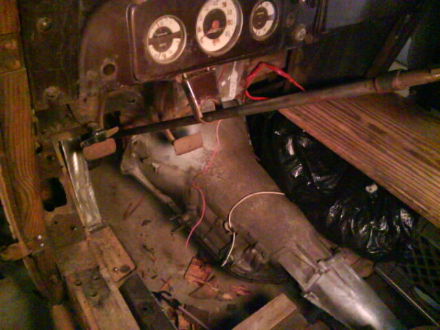

    If you are referring to the drag link, yes it should be parallel to the ground or very close to it. Four feet long sounds like it could be a problem too.
    Here's mine on my 40.
      330.2 KB
      117
