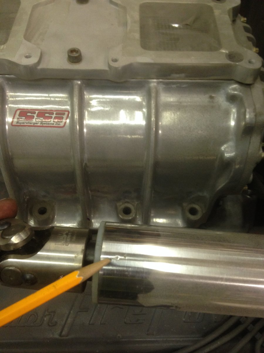

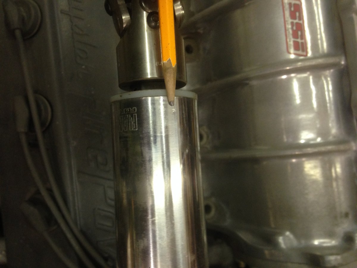

  4. Don't over think this.
    You want to think it, but not over think it. There's at least a dozen good ideas here and they are no good or too difficult.
    Cutting the column won't be hard.
    On the end of the column there is an inner bearing/ that's all. Find what's holding the bearing in. This one is a FR column with 2 ***** punches holding the bearing. Yours might have something different like a set screw, snap ring, tack weld alien technology.
    Cut the outer tube, reinstall the bearing, cut the shaft. Took longer to type this than to do it

  7. Brigrat- I got ya,yeah should be easy
    31vivky- thank you for taking the time for the pictures,I understand perfectly now. I was thinking I'd have to weld the tube cause it has a bearing retainer but if I can get it out then I should be fine. That's the kind of info I like to see on here. Props to you sir

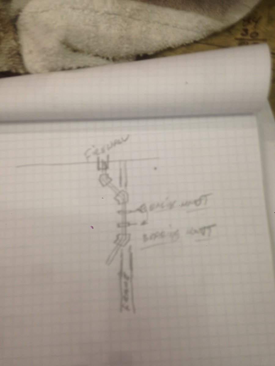

  29. Drawn in top view.
    There's no reason you could not or should not doing this.
    Opinions is different, it's got more parts but it might be less trouble

    31vivky-that's actually the design I was kinda thinking about,trying to keep it up and over to the frame
