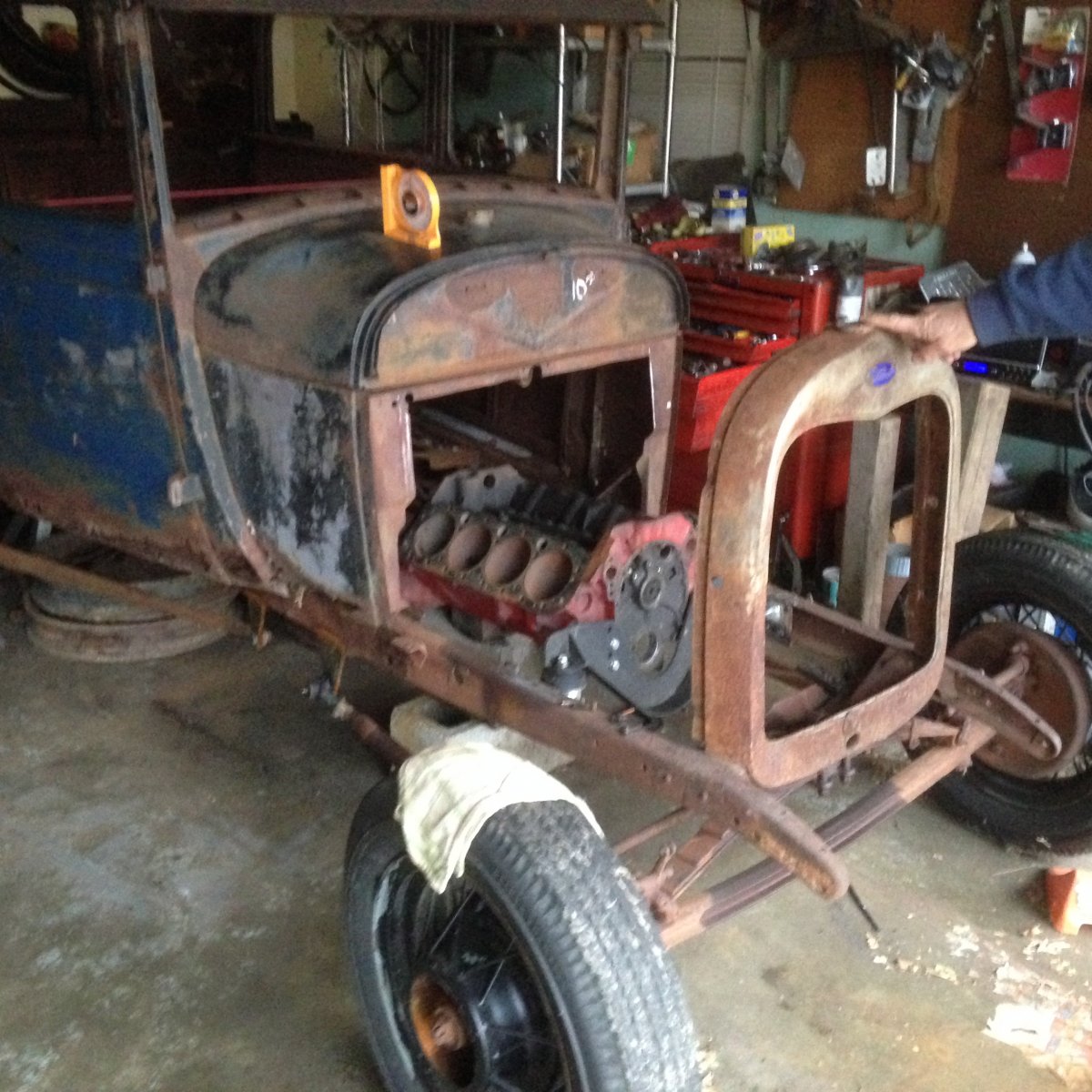

    The SBC is easy to work with steering wise unless you go nuts and mount yours like the one in this A sedan. Then things get a little trickier. LOL
