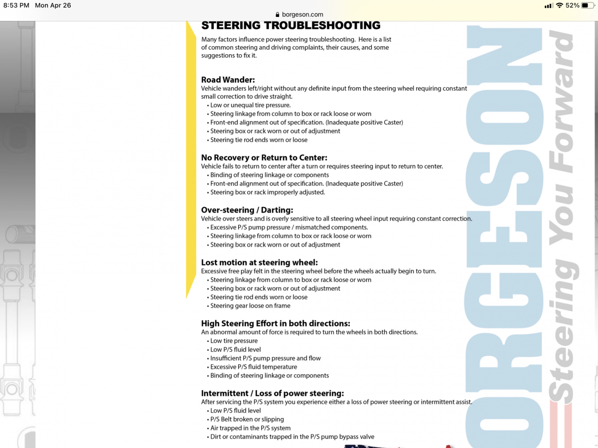

    From The people who wrote the book on steering components 0F2CBF4E-1C16-4C24-B124-114089278EDE.png
    Fabulous50's, AHotRod and dana barlow like this.
