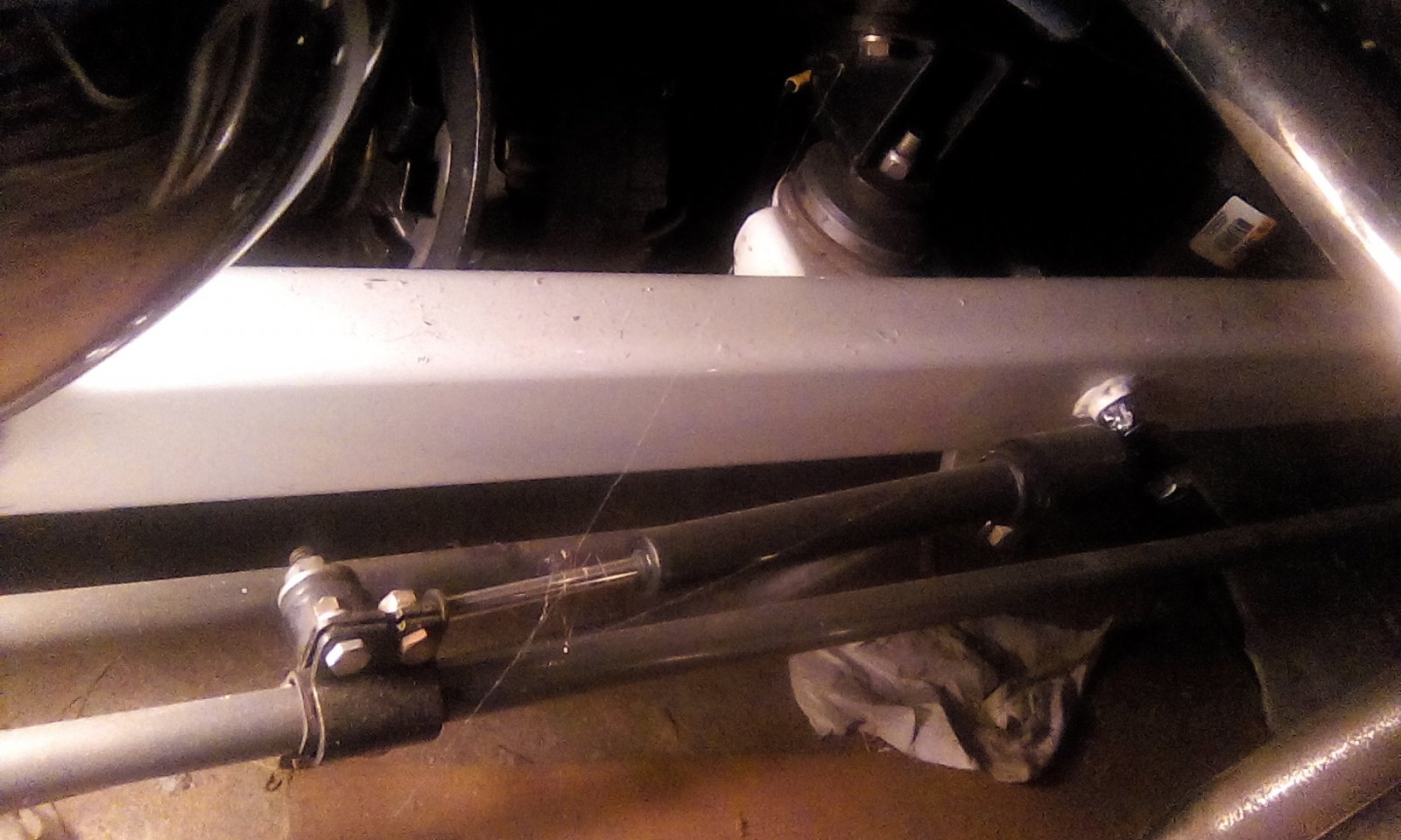

  28. 2OLD2FAST
    Joined: Feb 3, 2010
    Posts: 6,067
    2OLD2FAST
    from illinois
