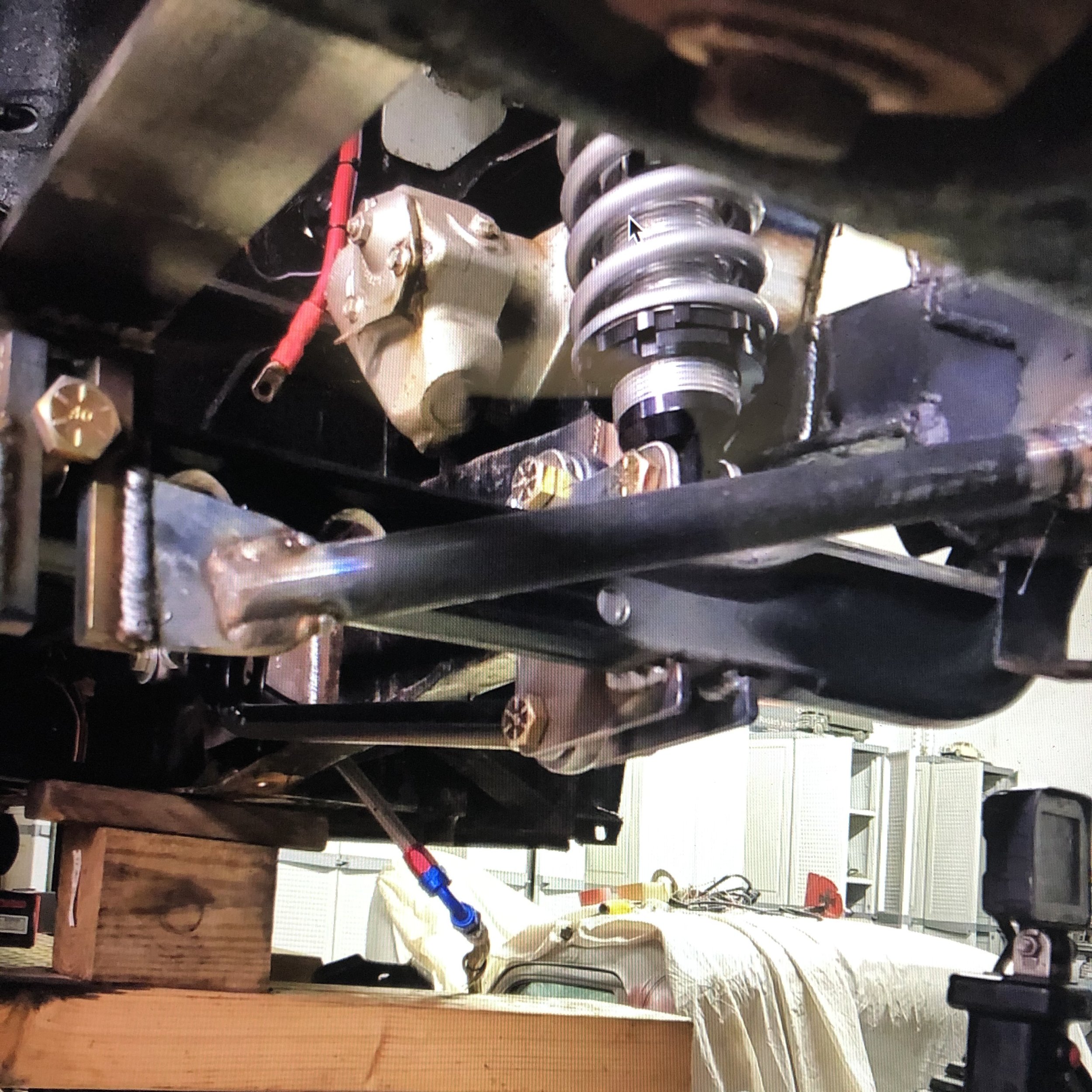

    Well I may as well ask a couple of questions since answers are flowing freely.
    1. I have a dropped axle, hairpins, a transverse spring, and Vega cross steering in my Model A. The car has been on the road for more than 15 years without a Panhard bar, a dead perch, the tuning fork thingy, or a steering stabilizer and I've never had any front end shake, shimmy, wobble, etc. Why would that be? Everything I've read suggests that a Panhard bar is necessary when running cross steering.
    2. Our Bonneville race truck (61 Ford) has a dropped axle, hairpins, coil overs, and the tuning fork thingy in the front. We've developed a death wobble that we can't seem to figure out. We've checked everything for wear and tightness and rebuilt the (stock) steering box, built a new drag link, replaced the heims on the hairpins, and replaced the steering universals, reset the caster to 7 degrees, reset the toe-in to 1/8, 3/16 and 1/4. None of that worked so we put a steering stabilizer on it and it no longer goes into a death wobble, but it feels like it's getting ready to the whole time I drive it. Last test run with the stabilizer was 90 mph whereas without the stabilizer it would go into a wobble at any speed. What have we overlooked?

    I would say that because the spring is under tension that is what is keeping it centered when you apply steering pressure. You haven't experienced a condition where the input from the steering exceeds the tension of the spring keeping the axle centered. Other people haven't been so lucky, some have even crashed as a result, and destroyed the car. Good engineering practice is to use a Panhard bar or some other means to keep the axle centered and not rely solely on the spring tension.

    I'd check that tuning fork and wager that there is a bit of gap in it and replace it with a good stiff Panhard.

    Need pic of the DRAG Link

    1. Your A's front axle is laterally located by the spring shackles. Wobble isn't a lateral-location issue. You do have bump steer, but depending on the amount of suspension travel you have you might be too used to it to notice.
    If you want to go to a more serious dynamic level and increase travel (they go together, if Colin Chapman is to be believed) you'll run up against the limitations of the spring shackle location.
    2. Top-speed-oriented builds want more caster angle than that. About 12° feels right? Possibly more?

    So that would eliminate the tuning fork we have to locate the axle. What else can we check beyond caster, toe-in, and loose or worn steering and suspension parts?
