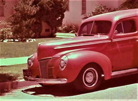

  19. jnaki
    Joined: Jan 1, 2015
    Posts: 11,656
    jnaki
    Hello,
    When we bought the 327 powered 1940 Ford Sedan Delivery, it ran, but it was all over the road, the tires shook at freeway speeds and overall, it was a problem that needed to get fixed. But, it was worth it due to the fact that it was time and money well spent. We knew we had to spend more money to get it running correctly and have to add some safety features for anyone to drive.
    It took several months to get some extensive work done on the front end. Did we use any of the stabilizers? Our neighbor told me about them and we gave it some thought. But, the underlying cause of bad handling is/was not going to be corrected by adding something that won’t work. It was as another post mentioned, a band-aid to cover up an underlying problem. It may work for some, but look deeper for the cause and not an another add on part.
    So, what is it? we have all balanced and mounted our cool new tires and rims on various hot rods and daily drivers. It is one thing that most drivers do is just that mount the new tires and get them balanced. Usually, it is always wise to get it aligned, too. But, sometimes it takes more than just a good alignment and balance.
    We recently had 4 tires mounted and balanced as well as aligned on my wife’s station wagon. When I took it for a high speed run on the nearby freeway, it was all smooth, tracked straight and not a shimmy in the steering wheel at any speed. So, we were fortunate that the last thing did not have to be done to make the car handle well.
    Most people will do what was mentioned. But, when we had other old cars and hot rods, we had to do several things to make the high speed handling safe and secure. One was a complete new build of the front suspension in parts and alignment. The tires were mounted and balanced on the car first. (40 sedan delivery) but, then, the sedan delivery still shook at high speeds. So, the wheel and tire guy said to go to this other shop and have the tires “trued.” Meaning shaved to complete roundness with the wheels mounted.
    Jnaki
    I was horrified at the amount of rubber taken off of the new tires from the Sedan Delivery. Each one looked good, were balanced well, but were still causing problems. The tire shaving guy was all chuckles at the amount of rubber that was sitting on the floor below my tires spinning on the machine. I was just looking and imagining several hundreds of miles of coastal cruising going down to the floor. He had seen it all. The solution was that the factories have those tire casings and the result of popping out millions of tires out for the general public, but not all casing forms are completely 100% round when the tire pops out.
    So, the tire true machine makes it round and despite the loss of rubber, in the long run, we would all get better handling and long life for the treads. Did the 327 powered 1940 Ford sedan delivery handle well after many months of rebuilding/repairing/replacing those worn out parts? (An overwhelming, yes!!!)
    It handled good enough for my wife to enjoy driving the 327 powered sedan delivery anytime for any reason. She never had to look over her shoulder for road handling problems or braking while enjoying the cool sedan delivery. She even took it on errands by herself. Confidence and the value of adding in safety/comfort made the rewards wonderful. YRMV
    1971BB427, dmar836 and A-Bomb like this.
