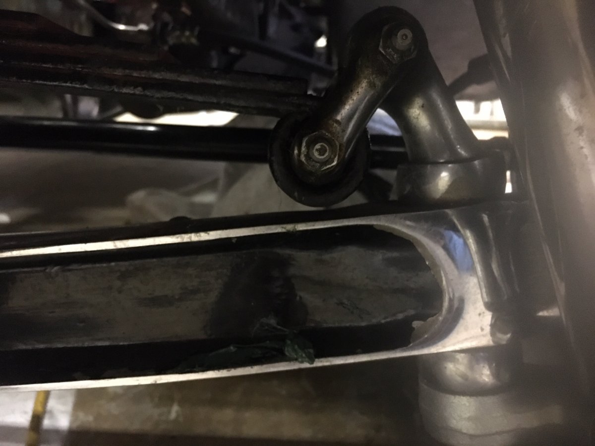

    is your spring rubbing the top of your axle

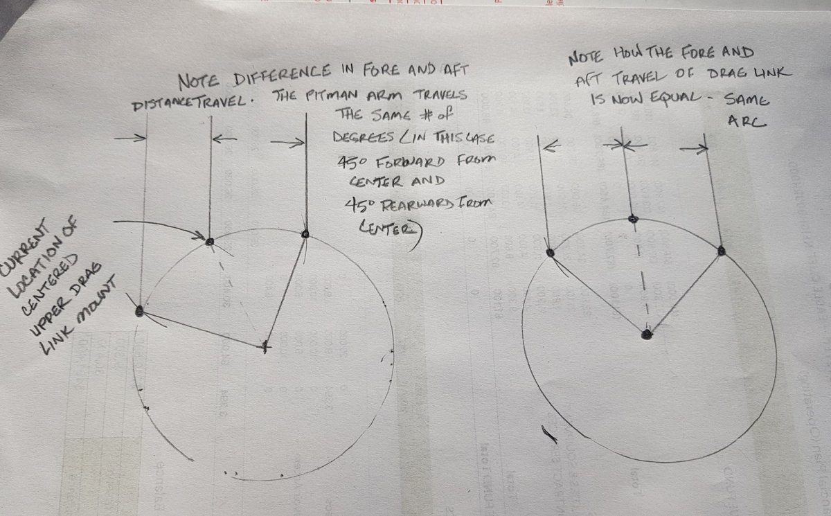

  6. Take a look at this sketch. It may help you to understand why it's important to get your pitman arm to the 12:00 position.
    Remain calm...you can do this. There is an abundance of excellent knowledge on the HAMB and an amazing willingness to help others to get through their challenges
    LCGarage, town sedan, pitman and 5 others like this.
  7. Ben Chirco
    Joined: Oct 21, 2019
    Posts: 243
    Ben Chirco
    Thanks for the drawing. It did help. Once the vega pitman arm came into play, I started to realize that this is doable. I know the vega is too long and i spent some time looking for a shorter one.

    nobby, thanks for the clarification of the "cotter pin". My spring is not resting on the axle. I have about 1/8" . See picture below. Why, what am i not seeing that needs to be repaired?

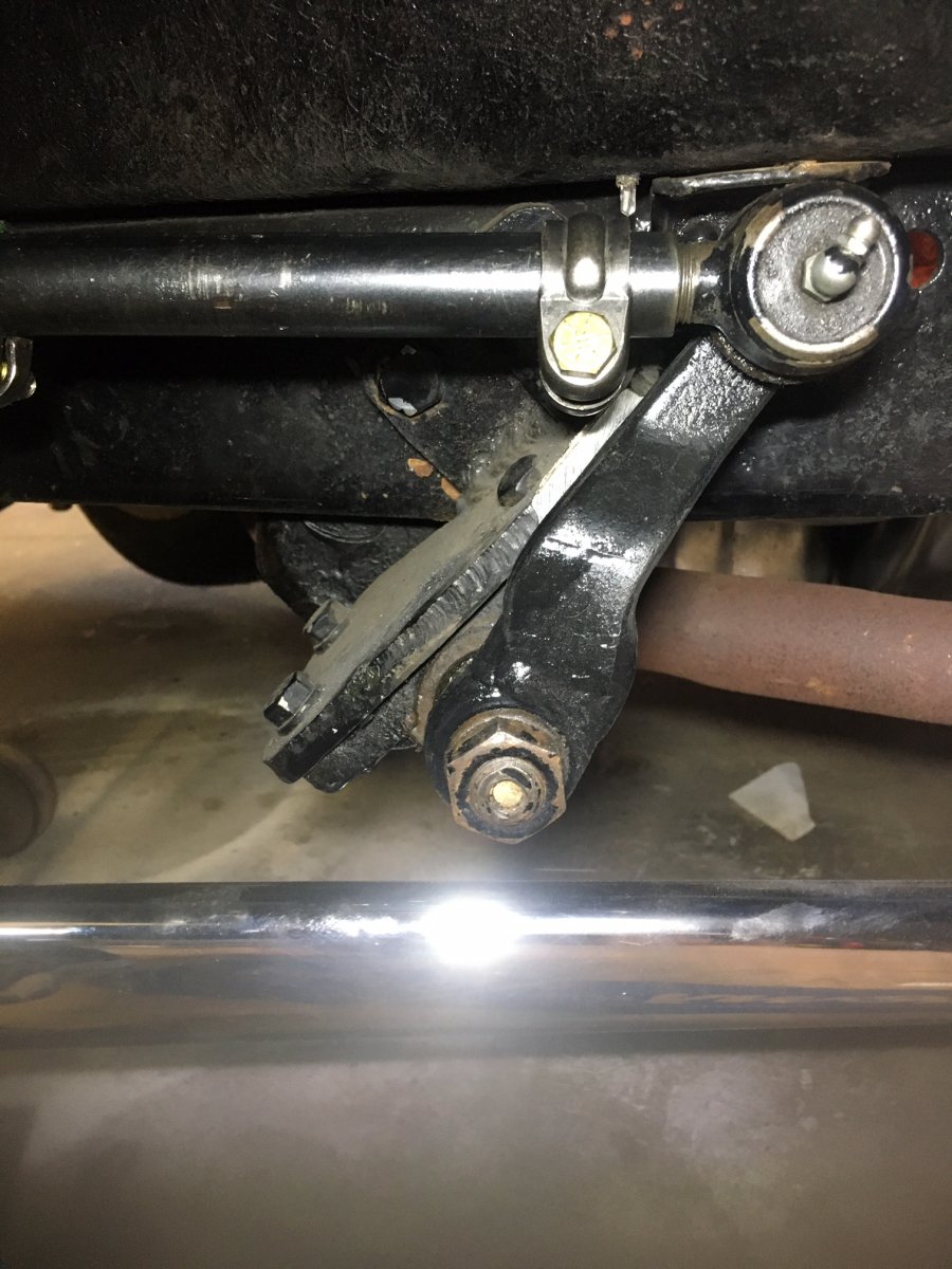

  12. bchctybob
    Joined: Sep 18, 2011
    Posts: 6,282
    bchctybob
    Seb has a valid point but I don't think the poor guy wants to totally change the steering box right now he only wants to make sure it's steering ok and safe. It sounds like he is just getting his feet wet in the hobby.

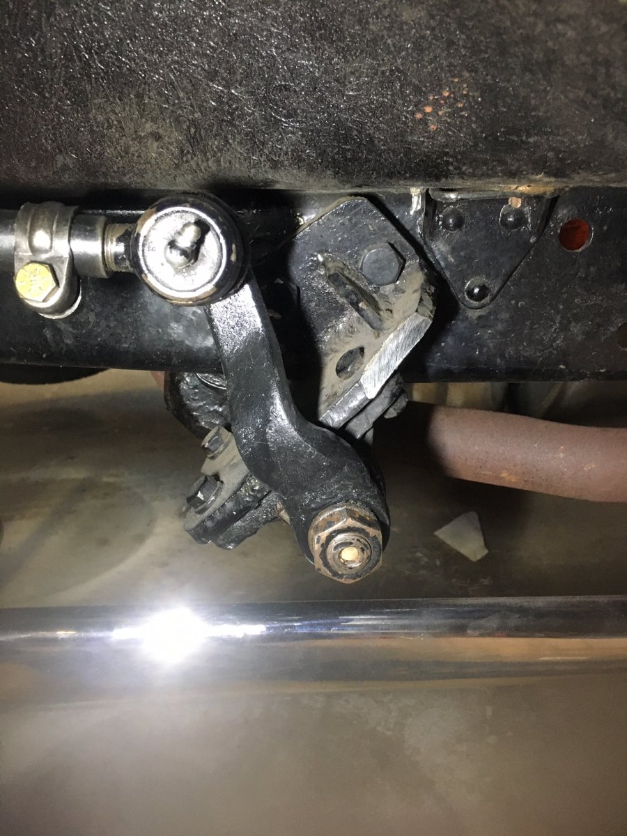

    Ben, your first picture in Post #15 shows the Pitman arm and the drag link in a position that is dangerously close to over-centering and locking the steering in that direction. Especially with screwed up steering stops. That is ONE good reason everyone is suggesting the 12 o'clock position and equal motion. The geometry provided by Anothercarguy clearly demonstrates the other.
    Hang in there man, it sounds like you are on a good path. Later, to get to the ideal geometry shown in Seb's second diagram you might look into converting to an F1 or F100 steering box that uses the downward pointing Pitman arm.

    I received a phone call last night that my pitman arm is welded at 12:00. I am going to pick it up today and install it.

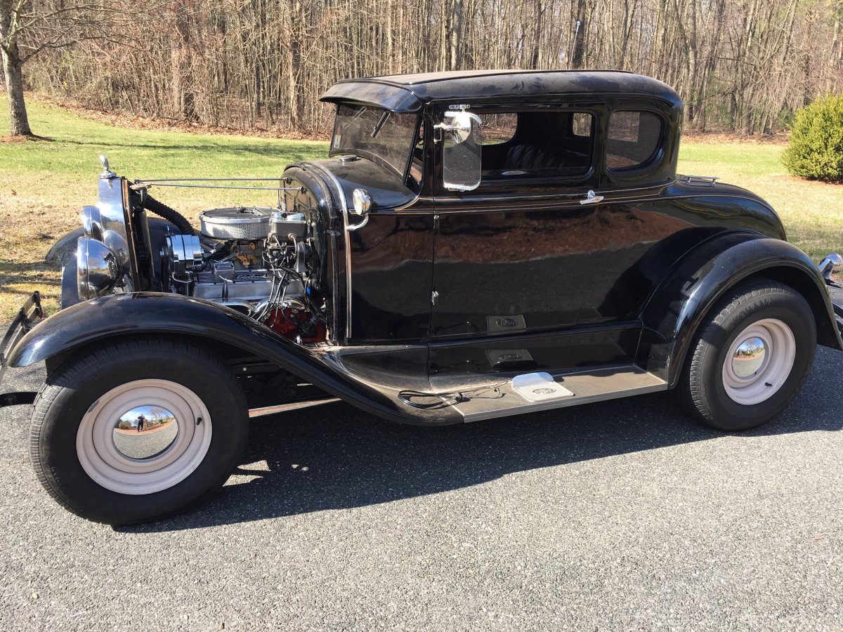

  16. Ben Chirco
    Posts: 243
    Ben Chirco

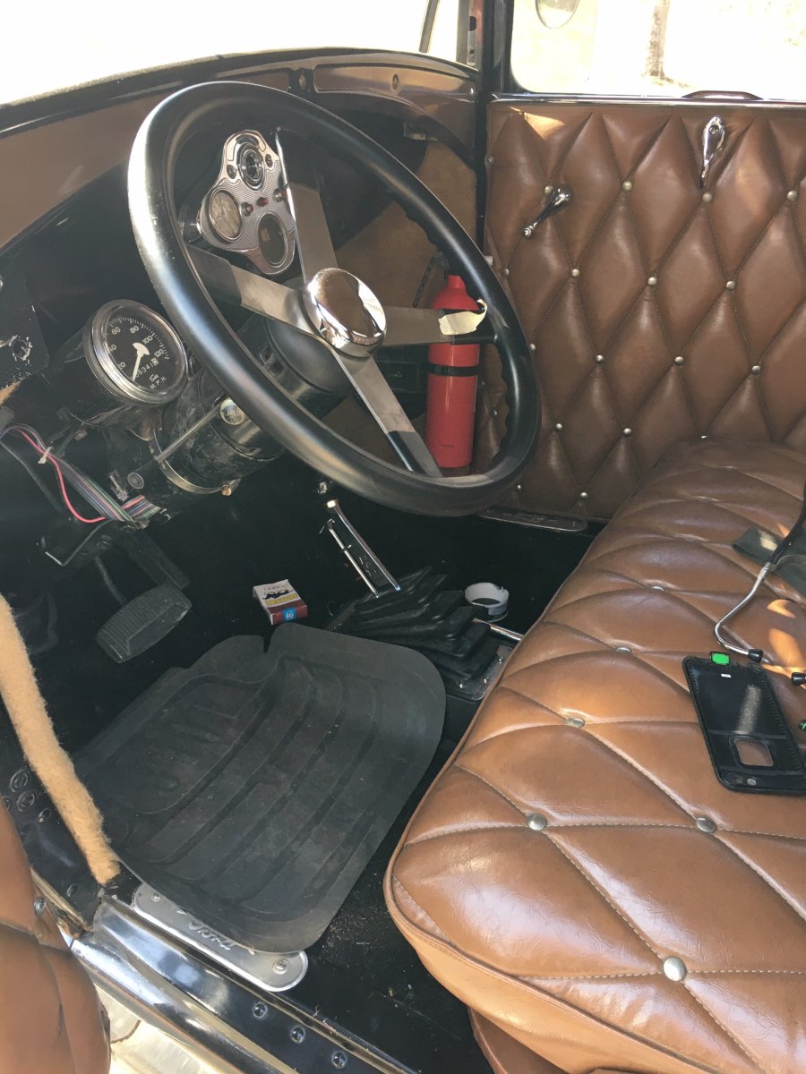

    Here are some pictures of the new geometry. It works so much better. I installed the stops and ended up grinding down the left turn stop just a bit to get equal turning radius.
    Thanks for the help. I will continue to look for a short pitman arm that will work for this application.
    Here are a few picts of the car.
    [/ATTACH] p4.JPG
    p4.JPG p5.JPG p6.JPG Thanks for all the help.

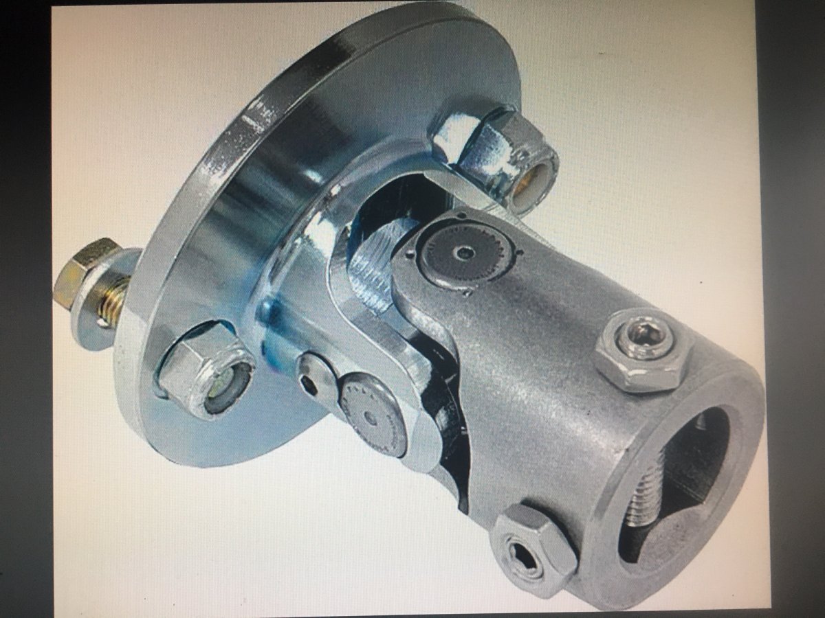

    How do you feel about this from Cl***ic industries? I am not sure of the size, its just something i found.
    K312852 - 1967-81 Camaro; 58-66 Impala/Full-size; 62-74 Nova - Stainless Steel Rag Joint - Flange X 1"- DD
    U-Joints are offered in stainless steel. This rag-joint flange is 1" - DD. Made in the USA.

    Ben, I would switch to the later steering box, and purchase a new arm from TCI or P&J. I would not trust the welded arm, for your sake or others. The one shown is a TCI stainless, as I remember. That's a great car you have, be careful with it . IMG_1188.JPG

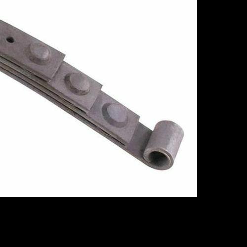

  26. acme30
    Joined: Jun 13, 2011
    Posts: 316
    acme30
    from Australia
    Observation from Nobby - good eye there
    I am not sure the above question has been answered.
    The reason that the distance between the lower part of the spring and axle is a problem is because as you go down the road the spring will move up and down as you go over bumps in the road. As it moves the shackles pivot inboard and outboard. When they pivot outboard (as the axle pushes up or the ch***is pushes down - depending on how you describe it) the spring will flatten out, rotating the shackle downwards/ outboard /to the right in your picture and it will touch on the axle. 1/8" clearance is not enough between the lowest point on the spring eye and the axle.
    I see the spring eyes on your axle are facing downwards - (not reversed). Many solve the issue you have and gain extra clearance by reversing the spring eye on the main leaf (Note reversing the spring eyes will lower the front by approx 1 inch). and it will move the eye away from the axle. Another alternative is to shorten the main spring leaf.

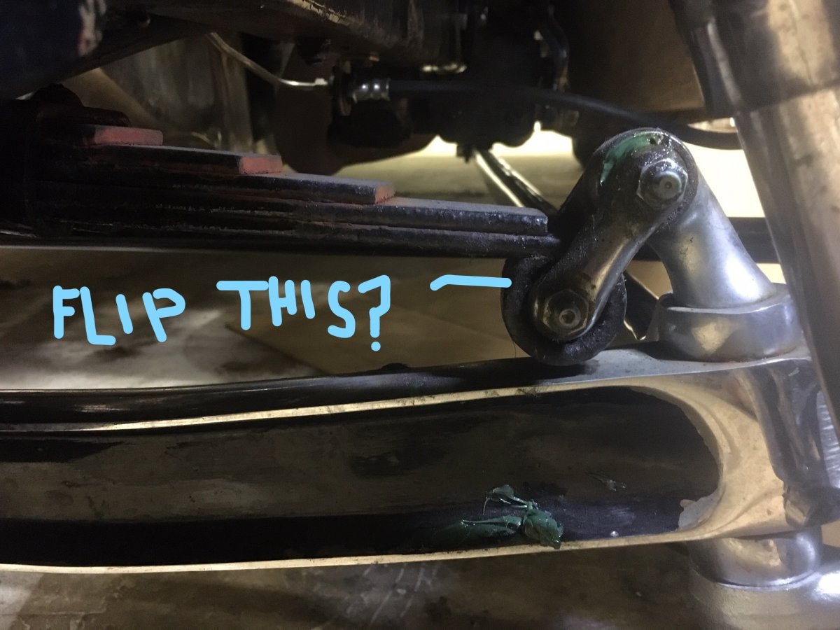

  27. Ben Chirco
    Posts: 243
    Ben Chirco
    Thanks for the reply on the spring. I looked at this when i got the car, but ***umed it was correct.
    I am beginning to think that the guy who built this car should have consulted you first.
    I am also beginning to think this should be a different thread, but i will keep going on this until someone says to start a new one.
    Here is my current set up.
    You are suggesting I flip this spring that says "flip this"? Or buy a shorter one. I understand how buying a shorter one would move the bottom of the spring away from the axle, but i dont see how flipping it will bring it away from the axle.
    Unless, you mean that i move the eye that holds the spring (that i drew a line to) , which is currently at 7 oclock, to 11 oclock or so?

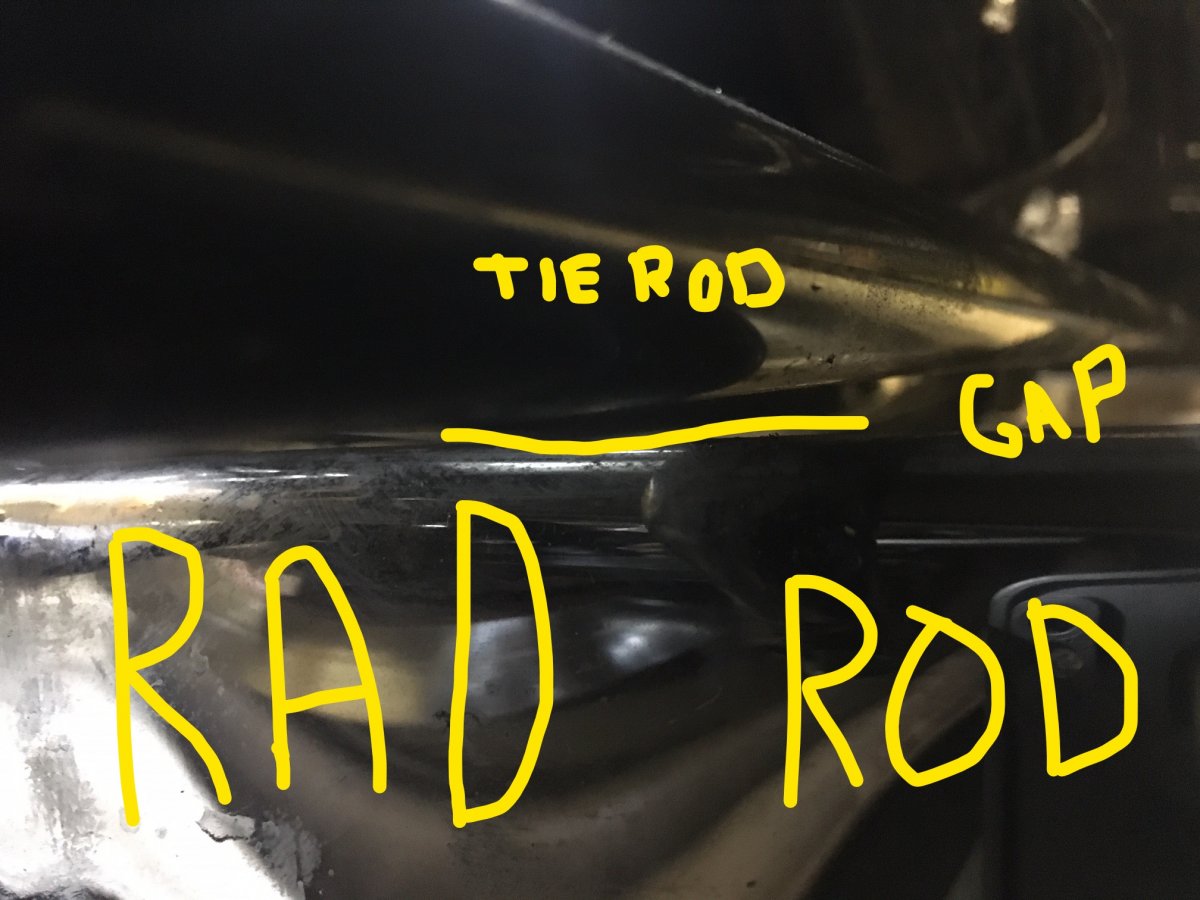

    Either way it will solve a problem i noticed early on which i show in my next picture. The clearance between my tie rod and the Radius rod is minimal. So by repairing the spring problem, i will gain some needed space here.

    I think some of those guys are a little confused. Or at least they are making you confused. If the spring currently doesn't hit the axle on full jounce, and you like how high the car sits, just leave the spring alone. By reversing the eyes of the current main leaf, which is usually DIY done by flipping the main leaf upside down and re-arching it the other way with a press, you will actually make the proximity of eye-to-axle a little bit worse as the arch grows a slight amount. To fix the maybe-imagined problem all together you will need a main leaf that is slightly (one or two inches or so) shorter than current. Then your shackles will sit slightly more vertical and they won't be close to the axle.
    But, all this moving of springs won't have anything to do with your tie rod to wishbone interference. That relationship will stay exactly the same. Putting a lowered spring in the mix will make the tie rod closer to the frame, but not the wishbone.

  29. lothiandon1940
    Joined: May 24, 2007
    Posts: 32,719
    lothiandon1940
    He's referring to the common practice of reversing the spring eye. image_128.jpg
