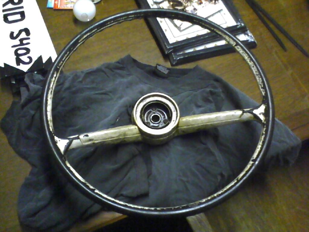

    JB Weld here too. I tried the one that comes in a tube that you cut a chunk off, knead into one color - I thought it was lousy. I DON'T use the JB Quik Weld. I use the old fashioned slower one.
    BEFORE:

    JB weld has held up fine for me as well, tried the JB KWIK for faster drying but like the original better. Although slower drying original formulated JB seems to feather nicer when sanding. Prep well for adhesion and use masking tape around larger cracks and fill with JB makes it less messy to fill cracks. I have done several this way with varied finishes. Fingers make the best squeegee for applying in most cases as mentioned. Also looking at the OP pics the coffee is a must as well in list of supplies needed to do the job. :D
