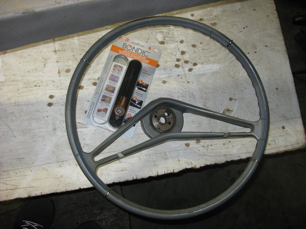

    I posted earlier about Bondic which came up in a pop-up ad. I went to Canadian Tire and bought it. I filed the cracks in my steering wheel and this stuff is amazing. The applicator lets out a tiny bead; just perfect for filling the cracks without gobs of stuff everywhere. It sands well. It dries clear so I'm thinking that it could even be a credible repair for those late fifties Mopars with the obolong steering wheels with clear sections in the rim. Home Depot had a lower price but with social distancing, I didn't feel like going clear across town. IMG_1418.JPG

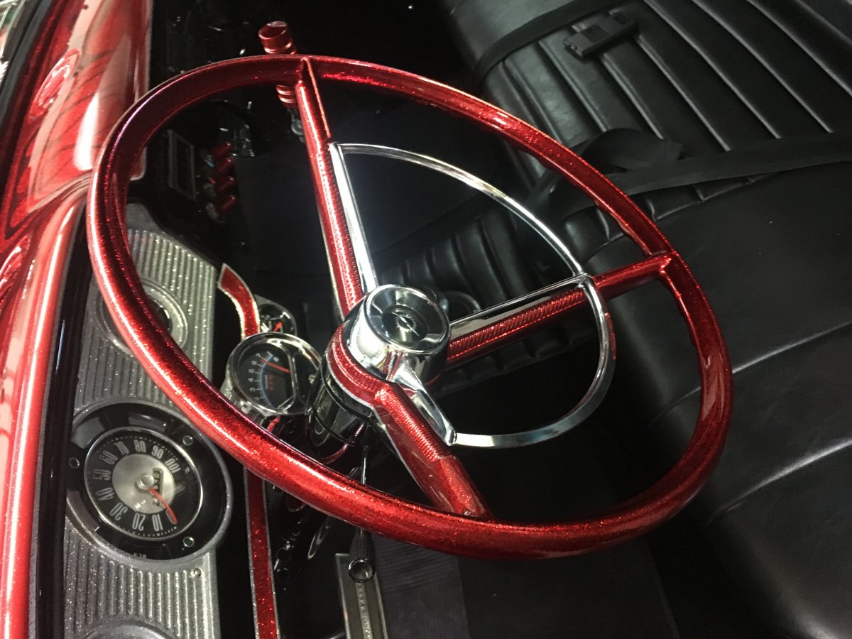

    I used PC7 (from NAPA) on several 50s and 60s wheels with good results. My 64 F100 has 20,000 miles in the last 6 years and still no cracks returned. It has been in cold weather and scorching heat as well. 64SW.JPG 64 sw.JPG 64 truck wheel.JPG

    Maybe extra protected from the multiple layers of clear I heard you must apply to metal flake?

    All the layers of flake and clear may help a bit (UV protection). I did want to mention you want to use high quality paint products, I see a lot of guys on here that use cheap stuff. You definitely get what you pay for. This was done with ALL House of Kolor products including the dry flakes and primer.
