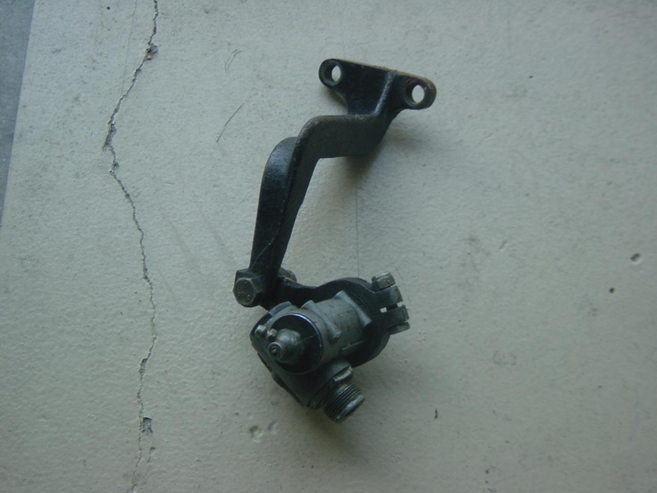

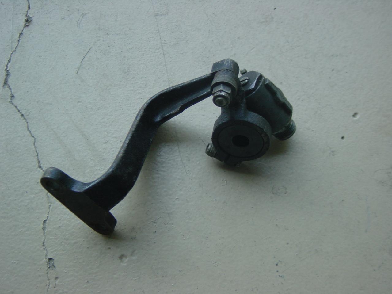

    Here is some pics of a Stewart Warner Tachdrive. From a Scrips landingcraft boat.
    It bolts to the crank, by removing the crankbolt, and screwing it in then you can remount the crankbolt to the drive, so you still can handcrank it.
    and it has a 1:2 reduction.

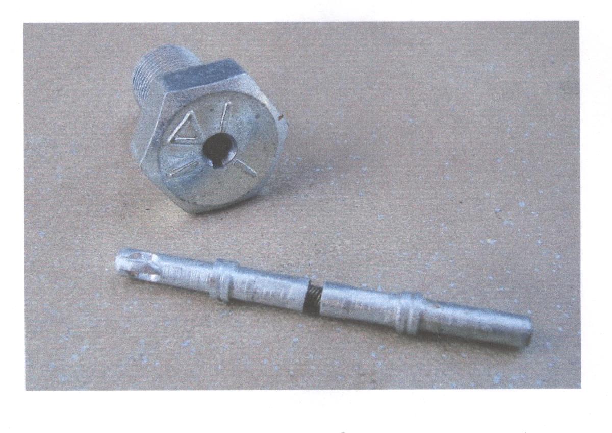

    I'll resurrect the dead here. Anyone know where to find a nut like this? It attaches the Flathead angle tack drive to the crankshaft. Searching here on the old threads, Nothing... Searching the internet, Nothing.
    This nut and drive wire looks like it is brand new, so someone has to be making them.
    Thanks,
    HellRaiser

    I beleive I seen this on E-Gay (the whole unit including the bolt) My guess is that the guy bought the bolt new, then machined it himself. probably made the drive wire also.
    If nothing else i'll give this thread a bump, maybe someone else has info.
