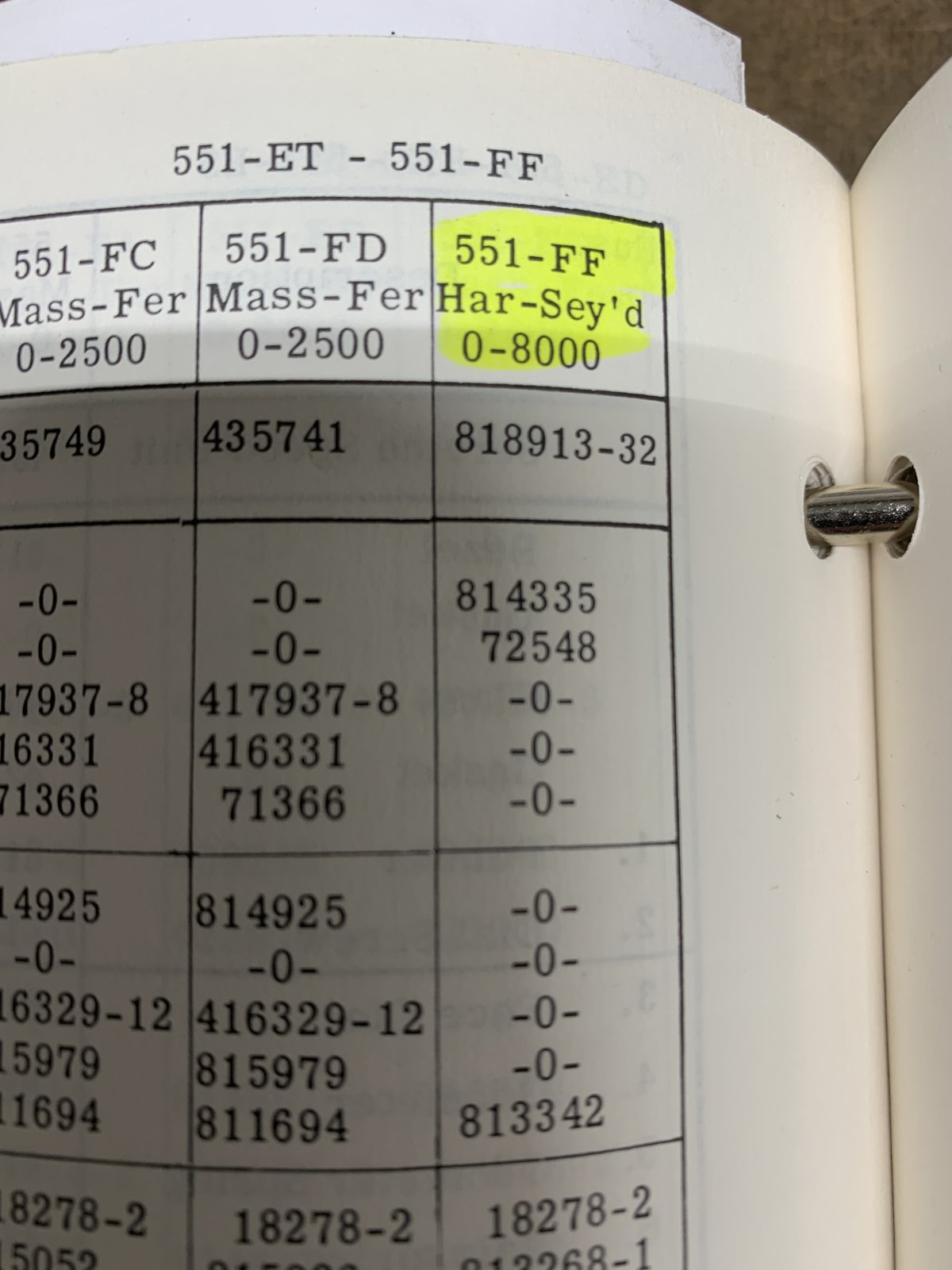

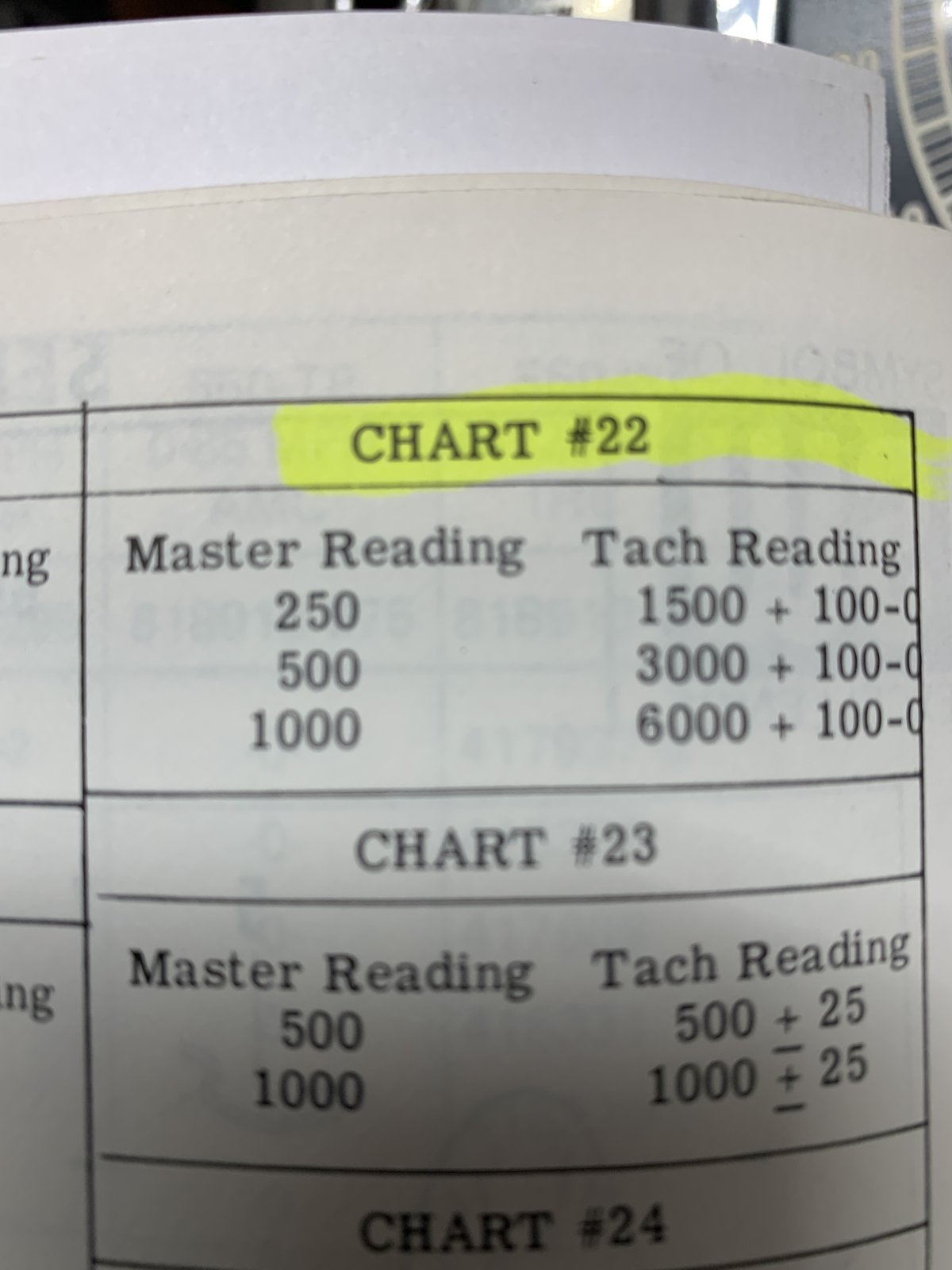

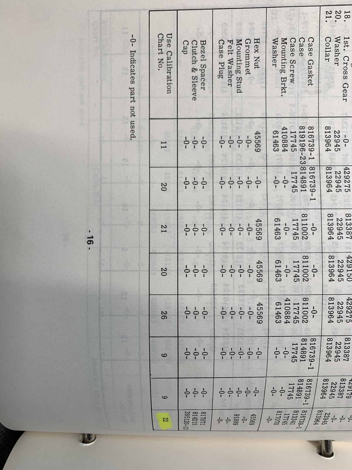

    Ok here is what I found as a reference.
    The meter was made for the company
    Har-Sey’d.
    The calibration tag reads 6000 to 1000.
    That means when the test bench reads 1000 RPM the gauge should read 6000 +or- 100.
    Which is shown on calibration chart 22.
    I ‘m pretty sure I could calibrate it to read off the distributor, sometimes it takes a lot of time switching hairsprings and trying different levels of magnetism by charging and discharging the magnet. It’s difficult sometimes to get a correct RPM reading all the way through the scale. IMG_4695.jpeg IMG_4691.jpeg IMG_4696.jpeg IMG_4697.jpeg
