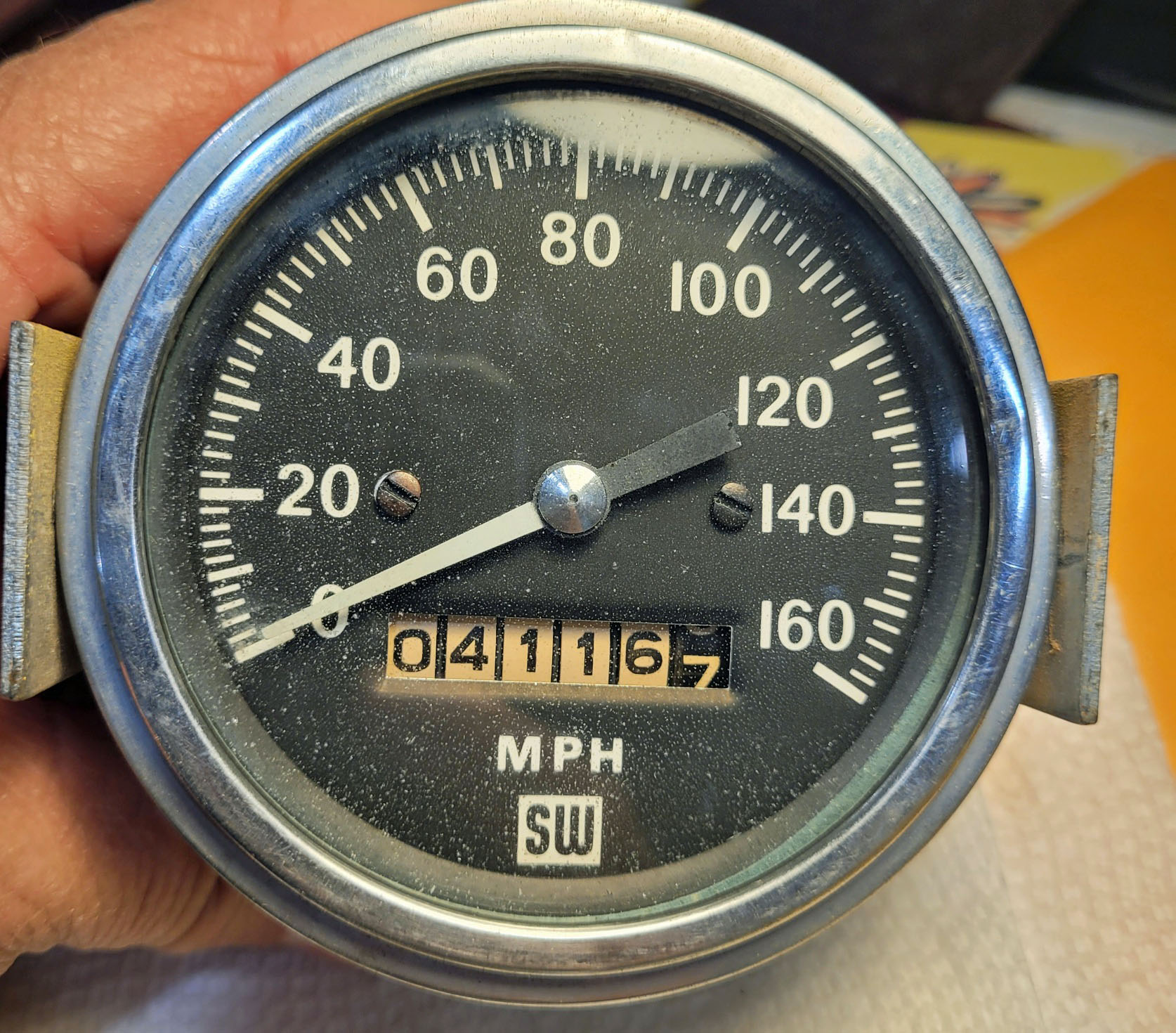

    I am frustrated with this piece of flat gl*** that came off a perfectly good zeroed out Stewart Warner speedometer. This is one of the metal ones unlike the new plastic ones. The gl*** seems to be etched. I can't feel any pitting with my fingers. It may be a gl*** imperfection. I have tried everything to polish it out but nothing is working. I even tried Turtle Wax polishing compound to no avail. The gl*** is 3 1/8" in diameter. I found a gl*** place on the internet and they want $50 for the gl***.
    What do you all think? I bought what I thought was the right size gl*** off of Ebay and it was too big. The lady had a no return policy. My fault for not asking. Speedo.jpg

    I would cut a new piece myself. So what gauge face is the speedo

    How much too big is the Ebay piece? Could you use the old one to mark the edge to size and then sand down to size?

    You can sand that out but not polish it out. Just like polishing metals, die grinder, fine paper (start at 3000 and see if it cleans it up, I wouldn't go more course than 1000 personally to start). Then as fine as 7000 and machine polish. Keep the galss wet with a spray bottle with plain water in it. You may break it or ruin it but what do have to lose? Make a pattern first incase the heat shatters the gl***. I have polished gl*** scratches (gouges) out of t-top panels and an expensive pair of Maui Jim sungl***es. Worth a shot, right?

    Look further on the internet (possibly eBay?). I had an old vacuum gauge I wanted to fix and found a replacement gl*** much cheaper than $50. Actually, most of the cost was freight; I ordered two so I had a spare (or insurance). The place I found (about 5 years ago) had a large supply of different sizes and thicknesses.

    Look into jewelers rouge, it comes in different grades and can be used to polish scratches on gl***.

    I had a local stained gl*** maker/lady cut me some odd shaped turn signal lenses of red gl*** (provided by me) for 5 bucks each. trimmed and polished edges too.

    A linishing belt will make short work of getting it down to the correct size. Make sure the belt is not too rough, and keep the gl*** cool. Have a bucket of water there and dip the gl*** very regularly. Don't let it heat up very much. It won't need to be perfect. The edges will not be seen. If you want to protect the faces from scratching while you work on it, cover with masking tape and mark the required size with permanent marker.

    All great suggestions. Alchemy posted a link to Timesavers. To save time, I ordered from them at $2.75/ each plus shipping. Came in at about $10.00 total. Hope it is not too good to be true. Thank you all. I can always depend on you for solid advice.
