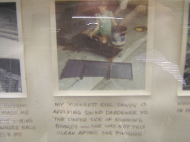

    Daughter helped me brush on 3M sound deadener back in 1964, works good!----Still on today!---Mixes with water.:D:D
