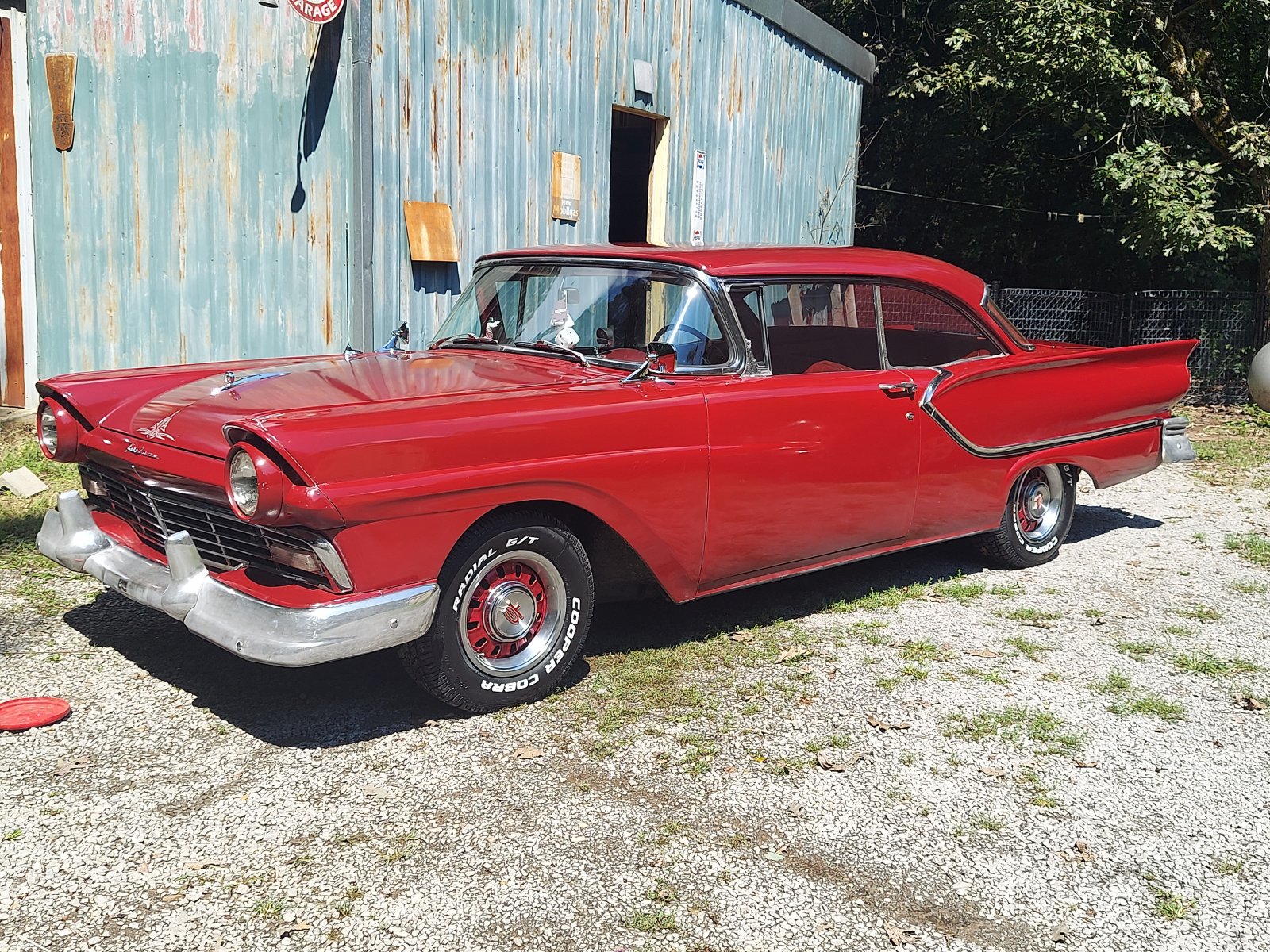

    Now for my next problem child. I rebuilt the manual 20210902_105845.jpg steering box in my 57 fairlane. I did so because the bearings were worn out, and it felt like the steering was going to lock up at any moment. Now however, the steering is smooth but it's tighter than a frogs a××. I have no idea what could have gone wrong. Anyone else encountered this?
