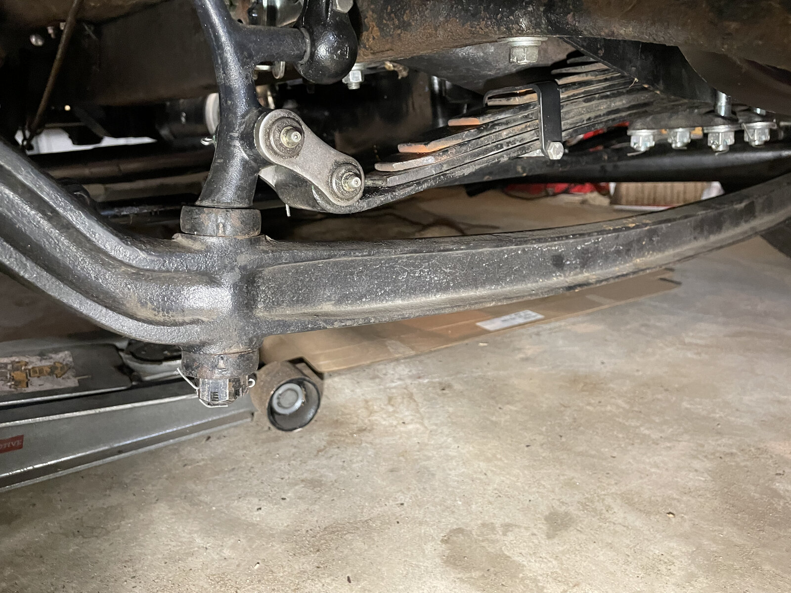

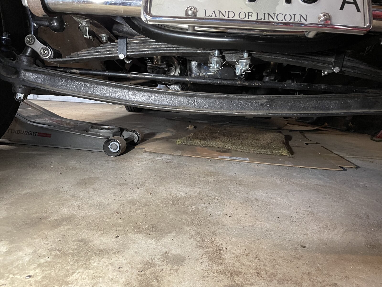

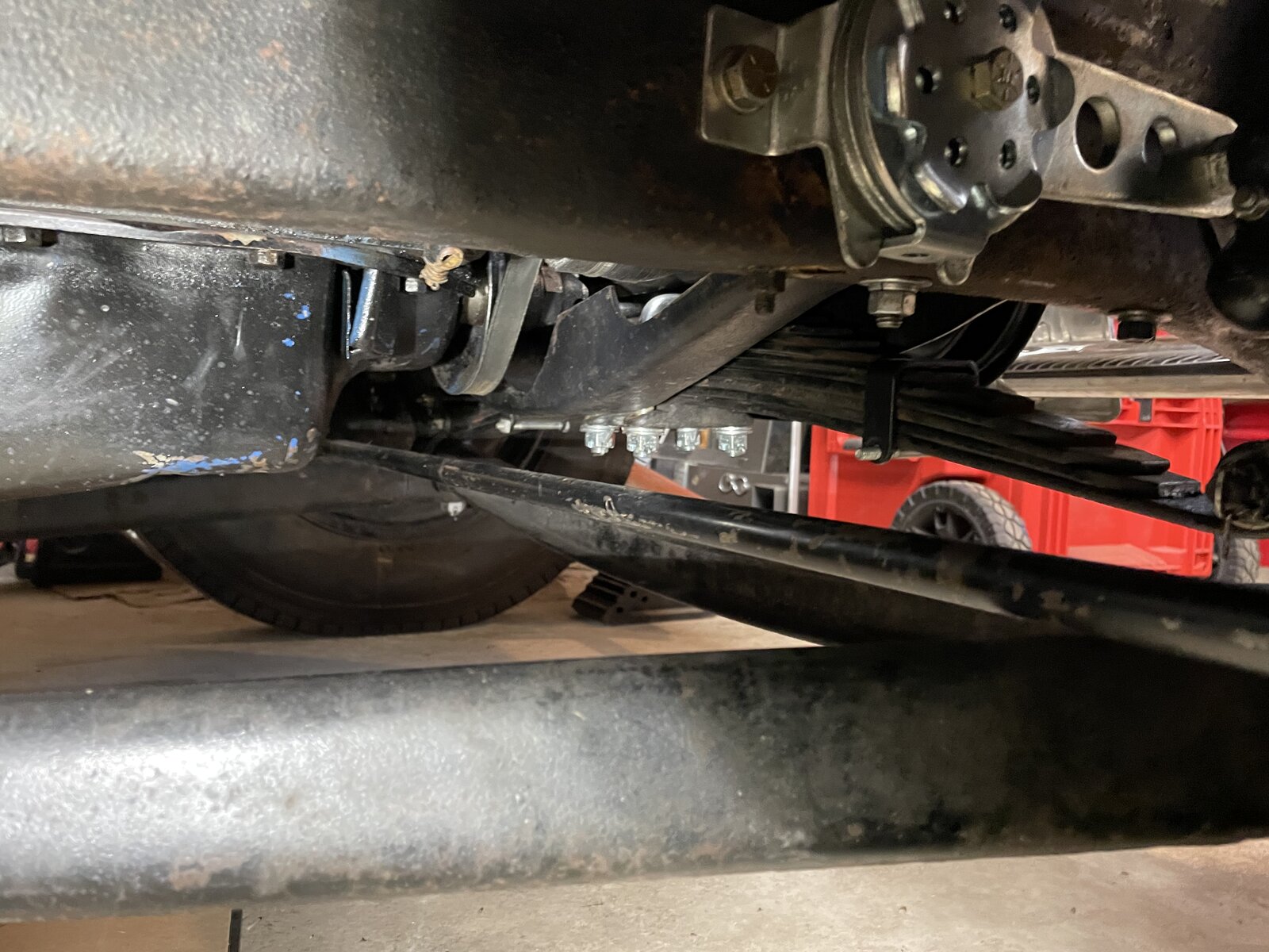

  15. Johnny Nitro
    Joined: Sep 28, 2005
    Posts: 100
    Johnny Nitro
    from Chicago
    Yes, some portions are that bad. They’ll come in, and scoop out the top layer of street, and leave it like that without any signs for weeks. You’ll be driving along in traffic, so you can’t even anticipate hitting a hole, and suddenly the car in front of you drops 6in. It really is awful. I don’t think most people would even believe.
    Here are some pics. The worst of it is my front pulley has licked my tie rod. Can’t go any lower on the steering unless I go under the bones. Can’t raise the engine due to other fitment issues further down the line. Easiest, and I think best way is to raise/stiffen the suspension.
  16. alchemy
    Joined: Sep 27, 2002
    Posts: 23,039
    alchemy
    The angles all look good, and nothing looks out of place. Either you are driving it like an off-roader or you just need to move.
    Maybe another second leaf would help.

    The angles do look good on the shackles. You have more distance than I do between the ubolts and axle and mine does not hit and it has 7 leafs and a reversed eye main. The long leaves are the ones that control spring rate, you have enough of them, with a spring pack like that it should ride like a truck, so they must be no good. A bumper is still going to let it hit. I would get a complete new spring and adjust from there. Why is your tie rod on top of the bones? Are you running 32-34 spindles?

    The u bolts aren’t hitting the axle, my crank pulley is hitting my tie rod. I haven’t measured, but it’s probably less than three inches between the two. I don’t think three inches of suspension travel is unheard of. Obviously could be less tho.
    The tie rod is on top of the bones on a stock Model A, but I had my axle dropped, and stretched, and am running ‘37 Willys tie rods, now. I’m running stock spindles, but do have ‘32 spring perches since I kept the mechanical brakes.
