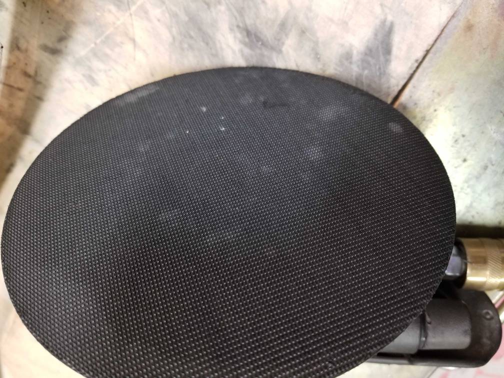

    A hook it pad has actual hooks on it like one side of velcro not just a bunch of slits. Your description does not sound like a hook it pad. This is a hook it pad. 1589170000616.jpeg

    Thank-you everybody for the responses, especially K13 with the picture. I didn't know what a Hookit pad should look like. There was a sneaking su****ion in the back of my head that what I had wouldn't hold a Hookit disc. What they sent me is a Stikit pad, it just had the wrong label put on it at the factory.
