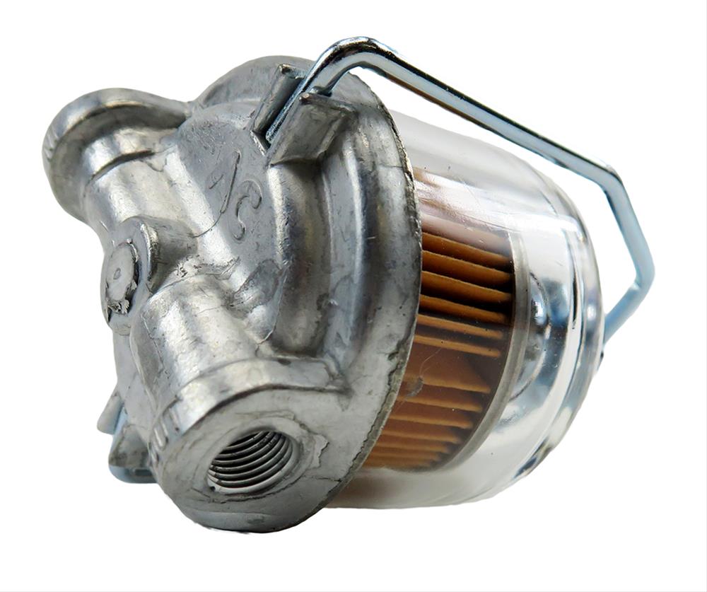

  14. Dan Timberlake
    Joined: Apr 28, 2010
    Posts: 1,582
    Dan Timberlake
    I'm thinking in Iowa the ambient temperature was a good bit cooler a few months ago.
    The tips offered by others are still worth following thru.
    Ten minutes after shut down I might open the hood and use a infrared thermometer to shoot the carb bowl temperature.
    Back in the carburetor days GM has fuel filters with a 3rd fitting for a return line on some cars. Turbocharged Corvairs, big engined cars with AC, etc.
    I've been thinking one advantage of an electric radiator fan would be allowing running it for 10 minutes after shut down to minimize heat soak.
    Those AC GF-48 fuel filters as used on 50s and 60s Corvettes always struck me as the ultimate.
    Rugged gl*** bowl, clear for instant troubleshooting.
    https://static.summitracing.com/global/images/prod/xlarge/ssh-gf48_sn_xl.jpg
    32 US bux in stock at Summit.
