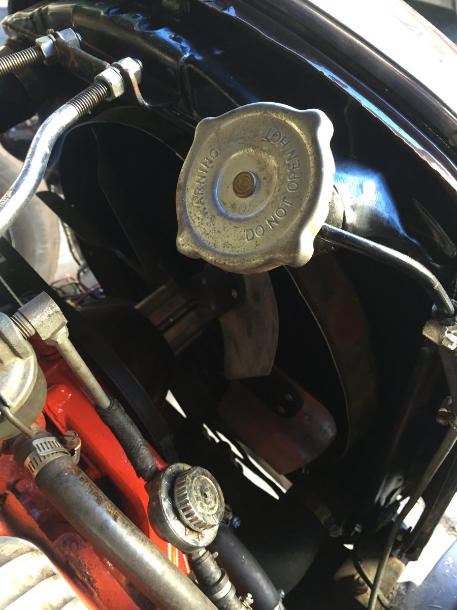

    The roadster is running hotter than ever and I'm afraid we are doing damage when we drive it. We had the radiator rebuilt and it has a new thermostat and hoses. It was running about 200 degrees this Summer and in traffic would climb to 220 then come back down somewhat on the open road. We put in a bottle of "Water Wetter" and (coincidently?) the temperature (even in the now-cooler Fall weather) is now a fairly consistent 230 degrees when fully hot and pretty much stays there--yikes! It's a 348 with three two barrel carbs but is only running the center one-- is it just too lean? We plan on getting the other carbs hooked back up-- might this fix the problem? Is 230 degrees way to hot? Should we not be driving it? Any other ideas?

    image.jpg image.jpg I believe it's a stock radiator with a fairly minimal shroud--I don't know if these pics are very clear. We are running a 10# cap and no overflow tank--it pumps out about a pint of fluid every time we drive it. There seems to be room for an electric fan between the radiator and grill--I don't like the look but is this a good option?

    A lot of unanswered questions,fan,shroud,where is the temperature sensor located,original radiator or aftermarket? HRP

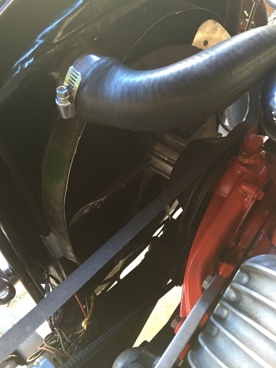

    After seeing the photo you might do better by replacing that aluminum fan with a steel bladed fan,those fans are about as bad as ***'s on a bowling ball.
    They don't work properly,check out the all steel fans from summit.
    I'm a member of keeping a mechanical fan camp and there are always opposing views,both work when properly used,again your aluminum fan is not going to work properly,I've been there,done that. HRP

  8. Your upper hose looks a little discolored- it might be collapsing at the the inlet?

    I suspect your aluminum fan and it looks to be not far enough into the shroud. Gary

    From the pic your lower radiator hose looks like a balloon. :eek:

    I agree with Hotrodprimer, ditch the flex fan, they are worthless. That shroud is only partially ok, it needs to draw from across the entire finned area, ala a closed faced shroud with only an opening for the fan.
    Whose radiator is it and how big is it dimensionally?
    Now, THIS suggestion will certainly cause an uproar, but I am only offering as ONE SOLUTION. Put a SPAL electric fan on it, even if you do it just as a test, and see how that works. I know, I know, I know, it isn't traditional, but if it allows you to actually DRIVE the car, it is sure better than sweating every time you look at the temp gauge.

    that shroud looks unfinished.it looks like just a ring....it wont work correct like that.

    I also don't care for that fan..

    Looks like the ring is fastened to the shroud to me.
