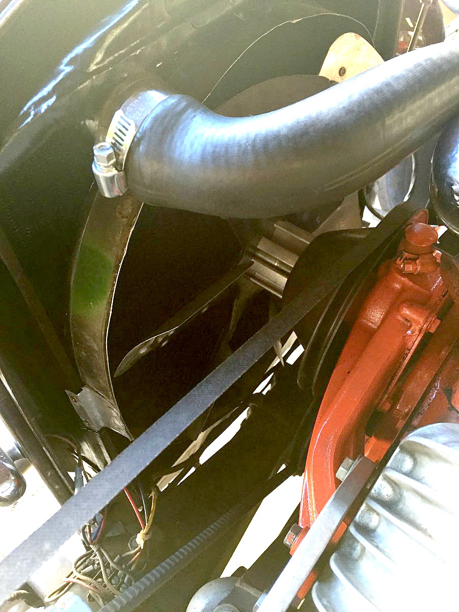

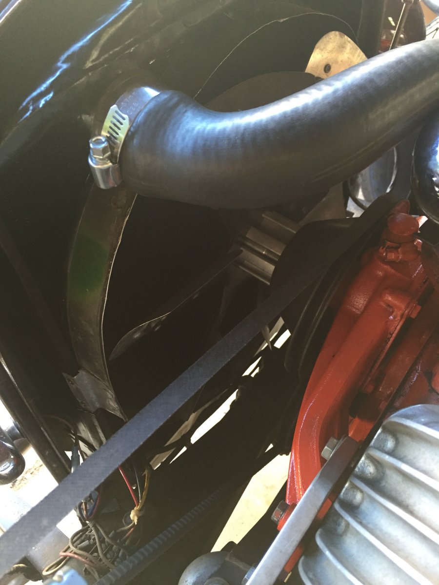

    First pic looks like the tip of the fan blade is bent. Besides a flex fan's marginal effectiveness, you should never run a fan that has any damage whatsoever. When they come apart at high RPM they can be lethal to bystanders.

    yes,ditch that flex fan and get one like hotrodprimer suggested. Ive had very good luck with them. may need a higher pressure cap also but I would start with the fan.

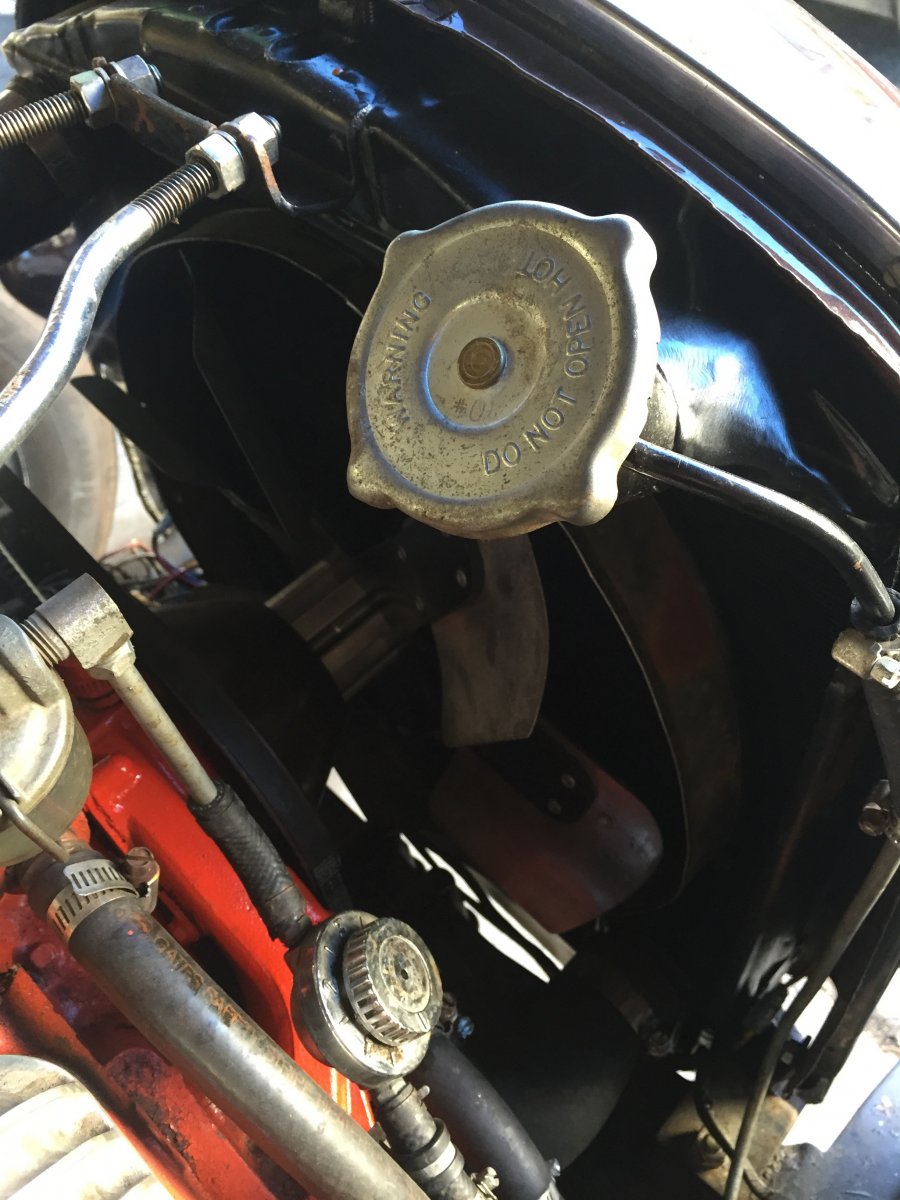

    hotroddon
    Can't tell from the picture, but is that shroud just a ring, or does it have complete coverage over the radiator outside the ring?

    from Wisconsin
    I see there are questions about the shroud being just a ring. The pictures seem pretty clear to me. The ring is attached to a full shroud to extend it. The shroud is black.

    from Wisconsin
    I would submit that you need to have your vision tested or maybe I need mine tested again. Maybe the OP can post more pictures. The ring being shiny makes it more difficult to see the rest of the black shroud but it's there.
