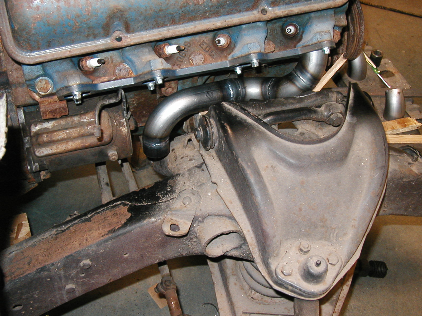

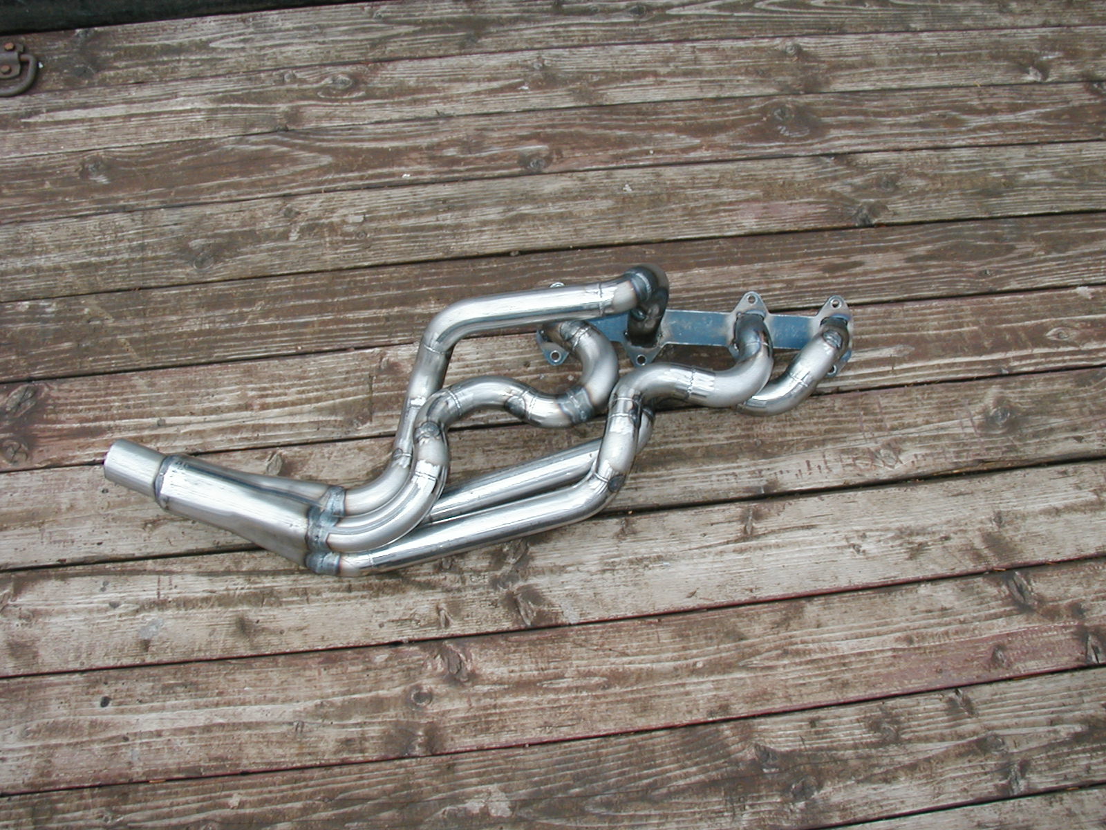

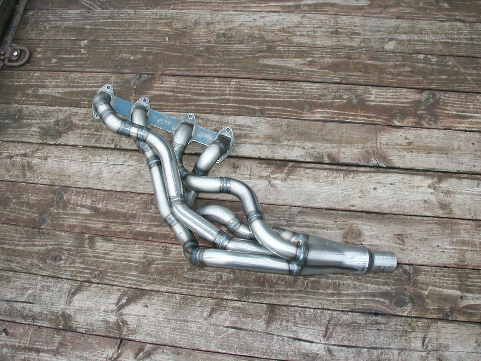

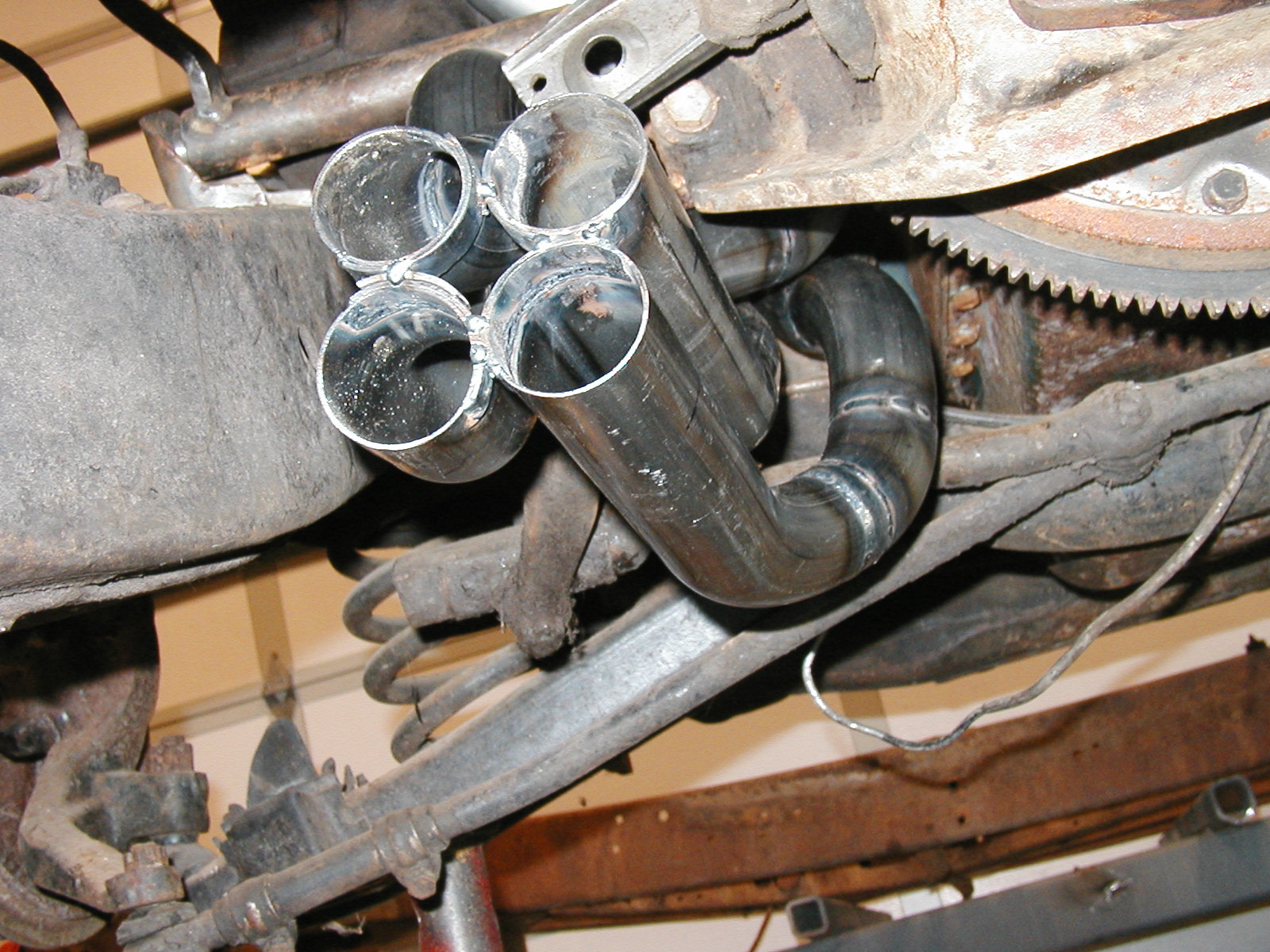

  15. When working on my 57 last year I found nothing in ready made headers. I built my own so I could move on. No big deal really as long as the starter would come out and all 8 tubes were the same volume. Fenderwell's were not an option for my build. That motor is just a Core but it is getting a FE with plenty of Grunt as well (maybe not as much as yours). It also has clutch linkage that had to work. Just another obstical to get around. No big deal, right?
    I also changed some on the rear end as you may want to do and found with a little work I could run a 11.5" wide tire with clearance (1.5" on each side) without cutting the wheel house or pinching the frame. I like it when tricks are hidden and don't cost an arm and leg.
