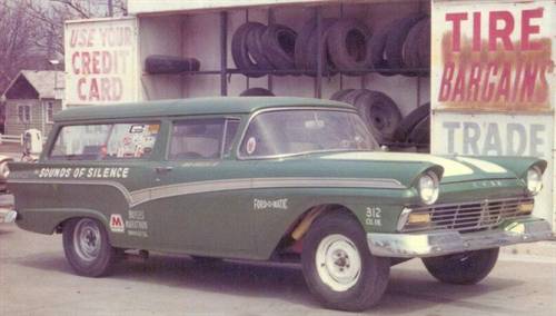

    StNick, Im 68 now and nothing comes easy any more. Ive been looking for a 57 Custom 300 or a 67 fairlane cheap body for years. We used to race an E/S 67 Fairlane 4 door wagon and later a SS/E 427/410 67 Fairlane coupe back in the early 70s {after I rolled the wagon on 7 inch tires}. Id probably go with a less PIA setup then I ran back then in my 57, they get old after a while driving in traffic. Id want something peaceful like a new 5.0 cammer with a 6 speed auto and AC these days

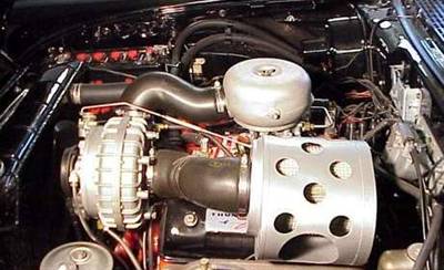

    my buddy in Pahaump, NV has 23 of those things sitting in his yard. For hoots, I broke the VINs. He has one built in Texas that came with 272 and factory A/C. He's had 9 p***enger wagons, posts and hardtops, Ranch wagons, dual quads and Rancheros, everything but a supercharged one. First year for the 9 inch rearend. They out sold Chevy's in 57.
