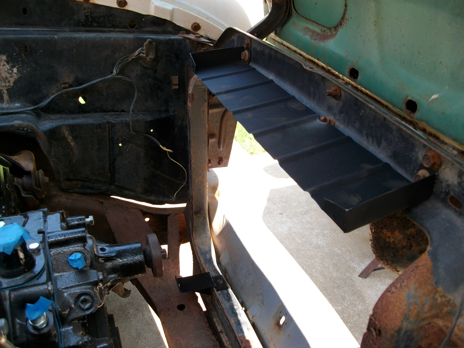

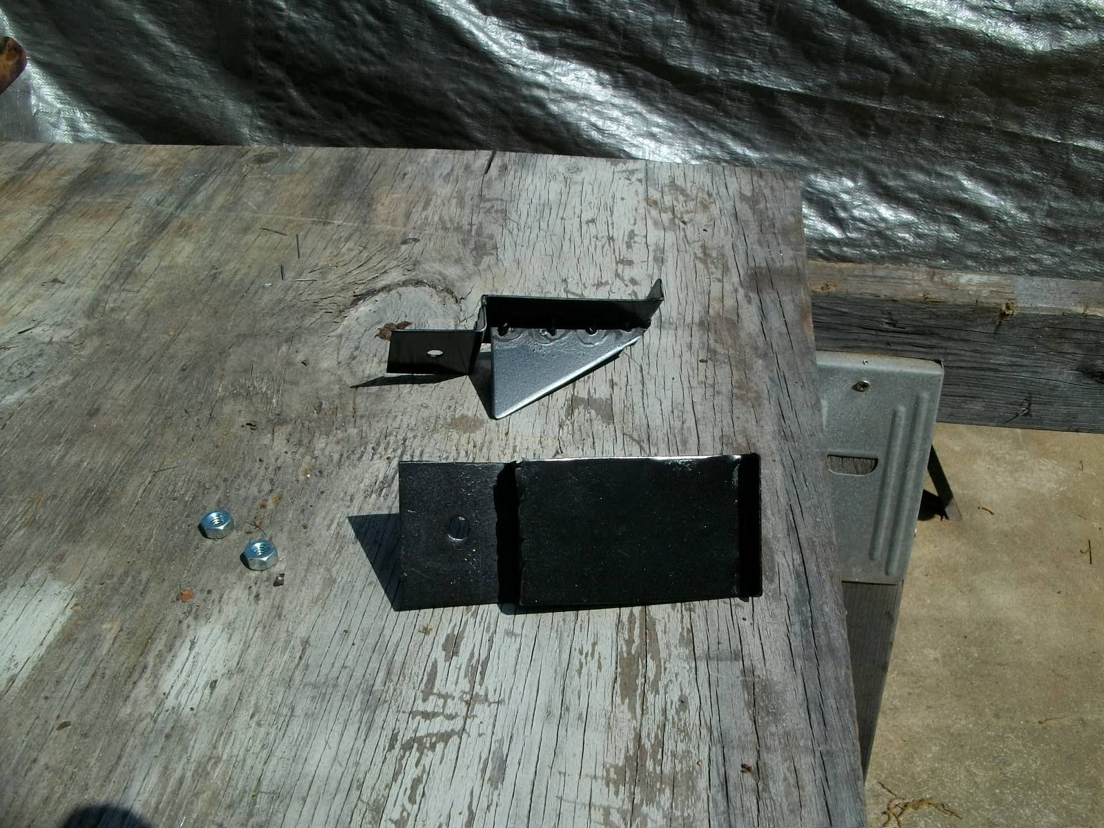

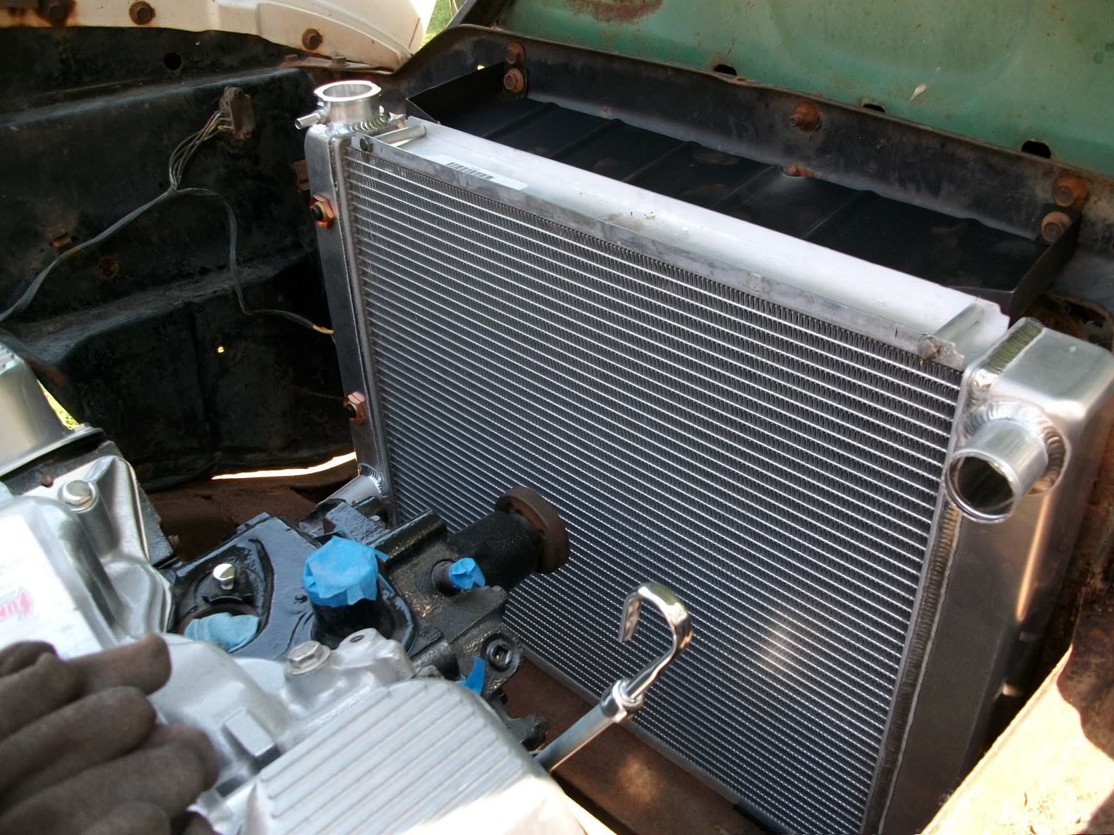

  11. I had to organize and clean the corner a bit today before I made a list of AN fittings I need for the fuel system.
    I got word the radiator was in, 1.5 cross tubes should cool this beast!!!
    I pulled it out and sized it up...
    I trimmed the support & another test fit...
    Now I need to figure out how I'm going to mount it.
    TJJ on iPhone

  12. Ford blue blood
    Joined: Jan 4, 2009
    Posts: 782
    Ford blue blood
    I did not need to cut my support but you could do the same, saddle on the bottom and bracket to the lower horn bolt.

  16. Ford blue blood
    Joined: Jan 4, 2009
    Posts: 782
    Ford blue blood
    351C/AOD, have a 390/C-6 in my Ranchwagon with the exact same radiator and set up.
    Here is a pic of the radiator mounted and fit with the 390 in my wagon. I made two of everything when I built the mounts
